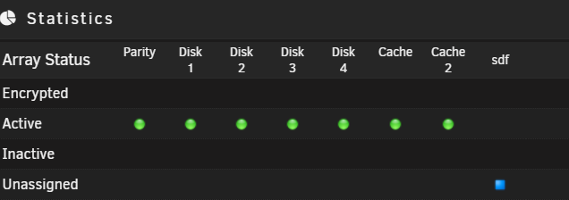

Also, I might add... I have discovered that "Dashboard" shows an unassigned device, but "Main" does not.
