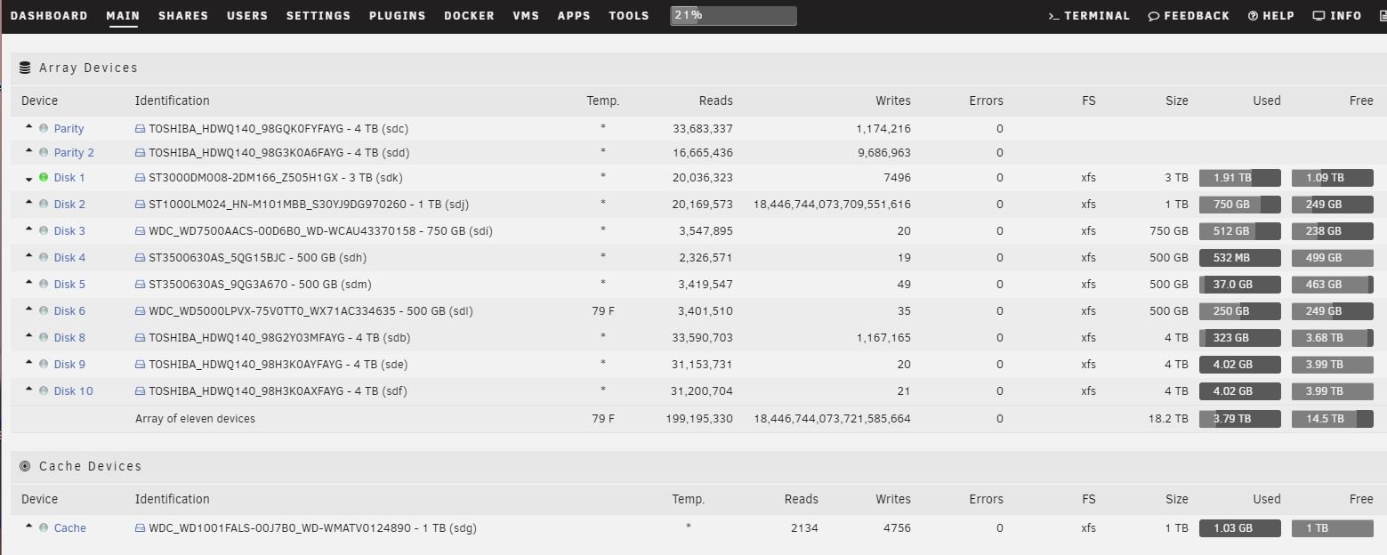

So, I noticed that one of my drives had literally over 18 quintillion (that is seven sets of 3 zeros - I had to look it up) writes to it.  No errors or anything until I tried to spin it up.  Here is a shot of the write numbers:

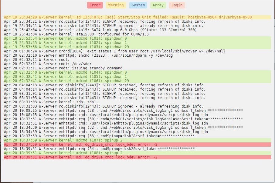

When I tried to get a look at the SMART data, the indicator in the Main view was green (indicating that the drive has spun up), but when I click on Attributes, UnRaid kept telling me that it couldn't give me the SMART data until the drive had spun up.  Here is a screenshot of the error log right after:

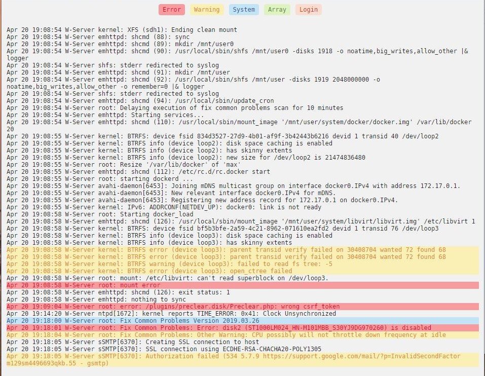

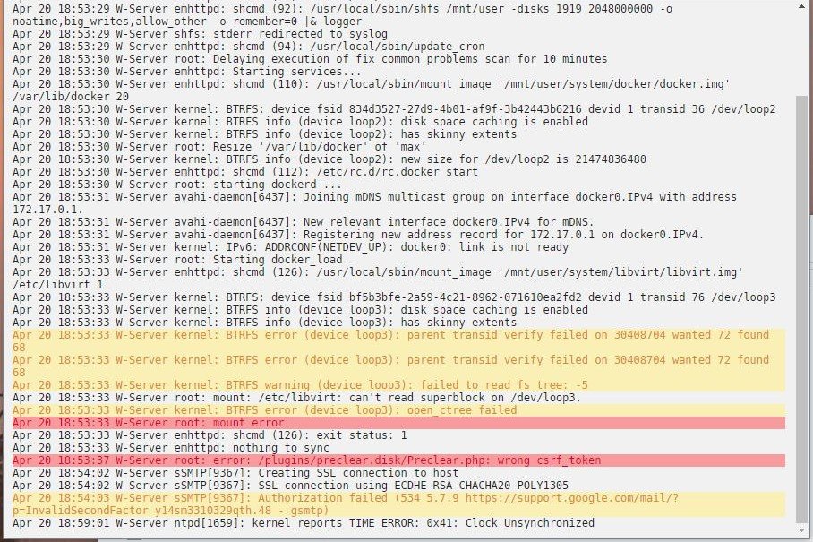

I was seriously confused, so I rebooted the server (using the WebGUI) and when it rebooted, the drive was disabled, and I saw these errors:

That number is exactly 2 to the 64th power, so it is almost certainly some sort of overflow situation and not actually the number of writes.
The drive will stay disabled until you rebuild it.

SMART for the disabled disk looks fine. Are there any SMART warnings for any of your other array disks showing in the Dashboard?
Unfortunately, the diagnostics were taken after a reboot, so there is no record of what happened to cause the disk to be disabled.
