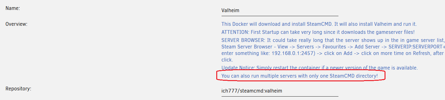

I was talking about Valheim, and I have now 2 docker running Valheim succesfully. I don't remember what went wrong that time, but it was a pretty quick setup this time.
I'm now curious if we can share the same STEAMCMD folder between the instances. Did not do search yet, no need to take time to answer me if you don't have the answer on the tip of your fingers already.
Hope that helps:

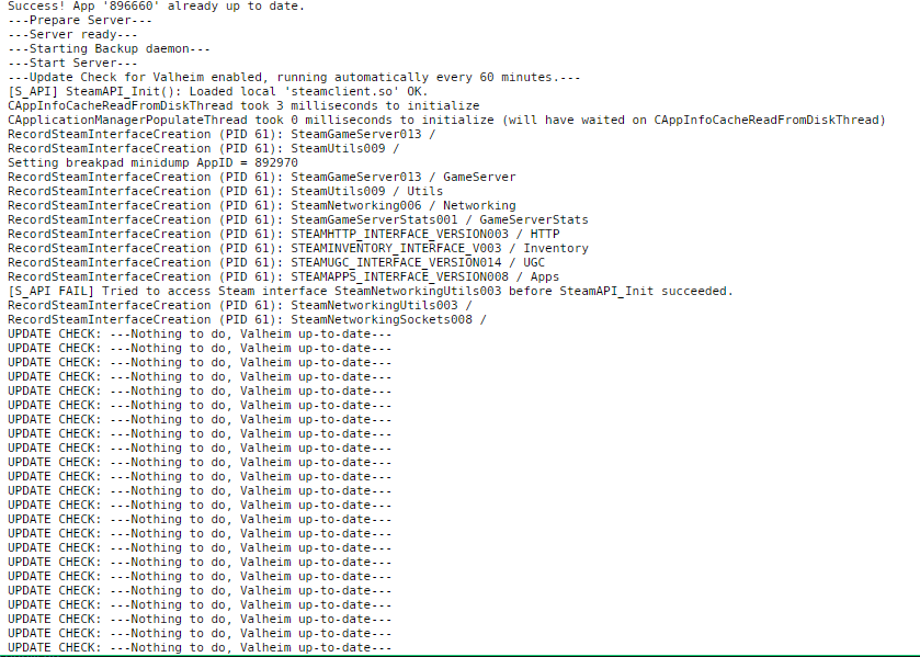

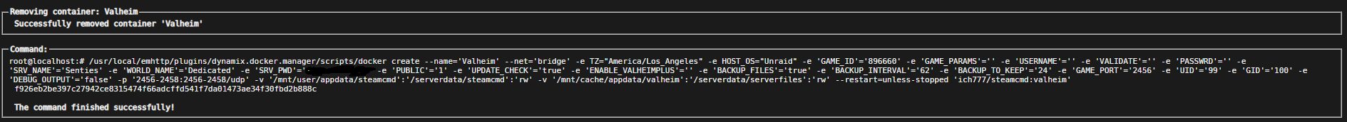

So I have an interesting problem and I am not sure where to go with it. I am running a Valheim server and twice now shortly after 1 am it has stopped saving and backing up. if I log in with an admin account and tell it to save it doesn't allow a manual save either. I just realized it this time but last time the final save was corrupt as well. Has anyone experienced this or know how I can avoid it?
some extra that might be helpful:
 The group decided that it would be best to start with a clean world between and I removed the image and started with a fresh container.
If I stop and start it after it stops saving it doesn't attempt to reload the save it starts a new one.
if I try and reload from the last backup it reloads the structures but appears to be on a different seed? the buildings are there but the terrain is different and there are trees in the water.
The game continues running just fine after the saving and backing up stops it just won't allow you to save anymore which isn't good if the system needs to be restarted.
attached are the most resent log from when it wouldn't save and my start script

1 minute ago, dfox1787 said:
CA Backup does run at the same time so that explains that.
Try to disable to Stop the Container when the Backup is executed, go into the Plugin and at the bottom click on: grafik.png.44f9c74ca10ea381f7093bf6a6941b2b.png then click on the little slider icon at Valheim so that it says don't stop:
2 minutes ago, dfox1787 said:
Works restoring it locally but doesnt on the container. I sopped the container deleted all the file and pasted the backup.
Try to restore it form your PC to your Container and see if that works.
In the template the world name and everything is the same as before or appropriate to fit the save?
Please check how your appdata share is configured in terms of using the cache?
Is it set to use the cache "Only", "Prefered", "Yes" or "No"?
Is this the first time happening or is this always the case?
How long did you run the server now?
it is configured to 'Yes'
This is the second time it happened. Both times it ran saves through the day just fine then got to around 1:10am local time and stopped.
