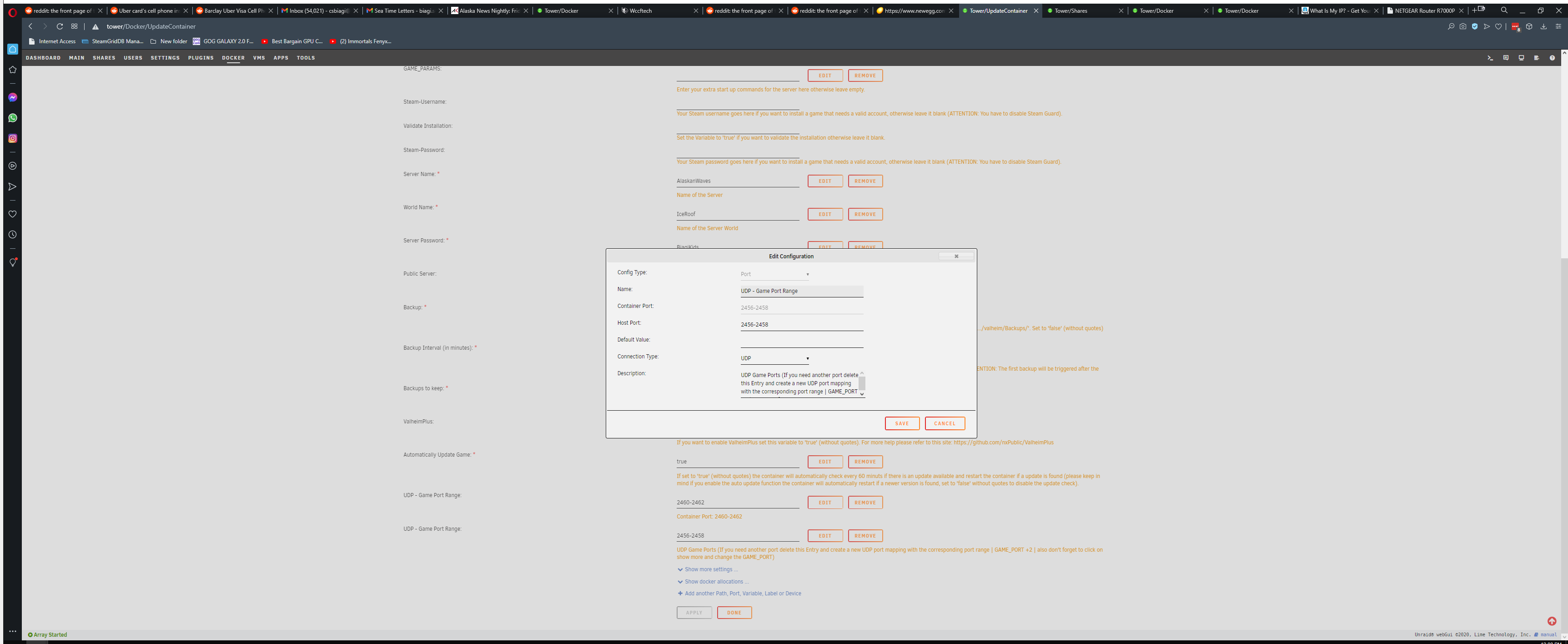

4 minutes ago, FrozenGamer said:
I can start one, but not the other..  I get "execution error" server error.  And because it stops, i don't seem to be getting a log for the one that fails to start.  I will attach logs for valheim and valheim 2, which were both running simultaneously until today.   After some investigation, i discovered that the container had added an extra udp game port range which was conflicting with the first server.  Not sure why. Deleted and i think its working now.
You have a old template and it will always add the ports on a container update.
Eventually try to delete the container (note your existing settings down) and pull a fresh copy from the CA App and set it to the same values as before so this won't happen any more...
just for the valheim2 (non standard ports)?
Exactly.
