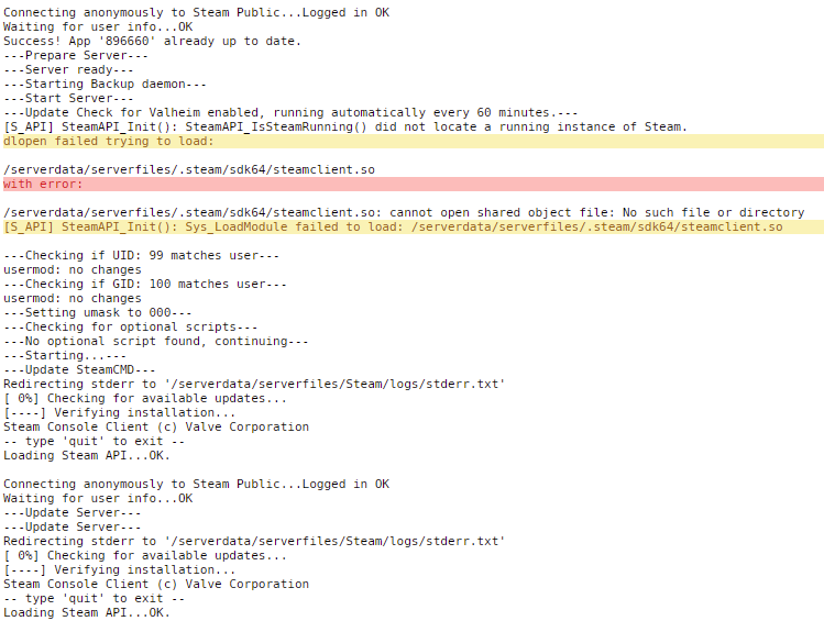

@ich777 Hey, I'm stuck on a loop when trying to start my Valheim container.  Have you seen this?  I was trying to console into the container to check the directory /serverdata/... , but it keeps booting me from the shell when it loops.  TIA
Are you sure that you are not affected by the world reset bug?
Also please check if you password is 5 characters or longer.
The container loops because something is wrong with the game itself or the savefile.
-Not sure about the world reset bug.  I'll have to look into that.
-Password is 5+ chars
I did try restoring from a backup an hour prior and that didn't work.
I was playing the game an hour before the issue without issue.  Leading up the boot loop, I found an article that aimed at improving the lag in valheim.  This one was specific to a valheim dll within the server and client.  Increasing the bit rate of data flow by 4x by modifying the dll in dnspy.  When I made the changes and saw the server wasn't able to start up, I restored my backup dll (original) and still faced the same problem.  At one point, the container was complaining about Valheim+ being enabled, it said to disable and try again in the logs.  I disabled it and that didn't help.  Had never seen that before.
Yes, there is something wrong with Valheim+ when the container tells you that.
Please save you Backup folder somewhere save and start over by deleting the container (also not your settings from the template that you have made and also delete the valheim folder in your appdata directory) pulling a fresh copy from the CA App and let it start for the first time and then restore your Backup.
This worked perfectly! Thanks so much! @ich777
