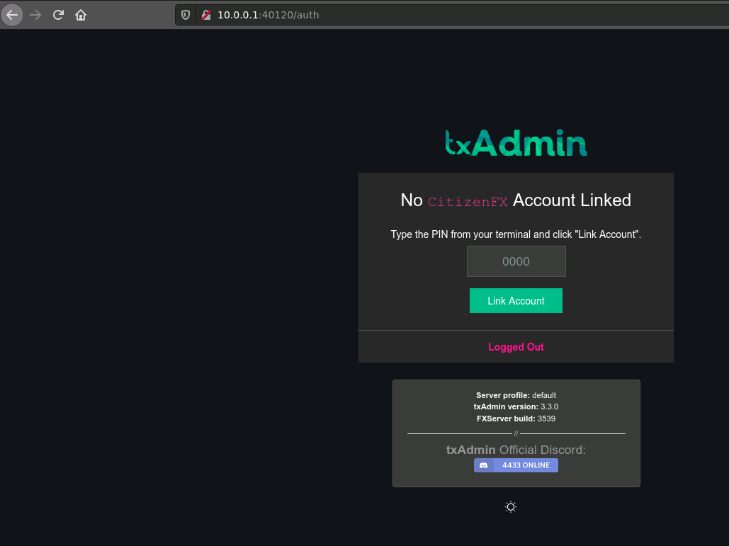

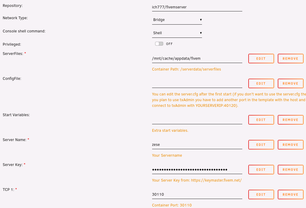

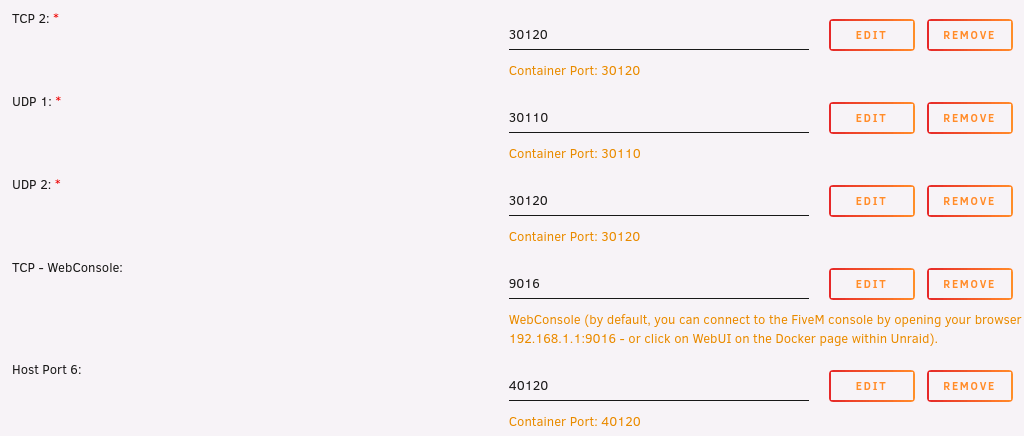

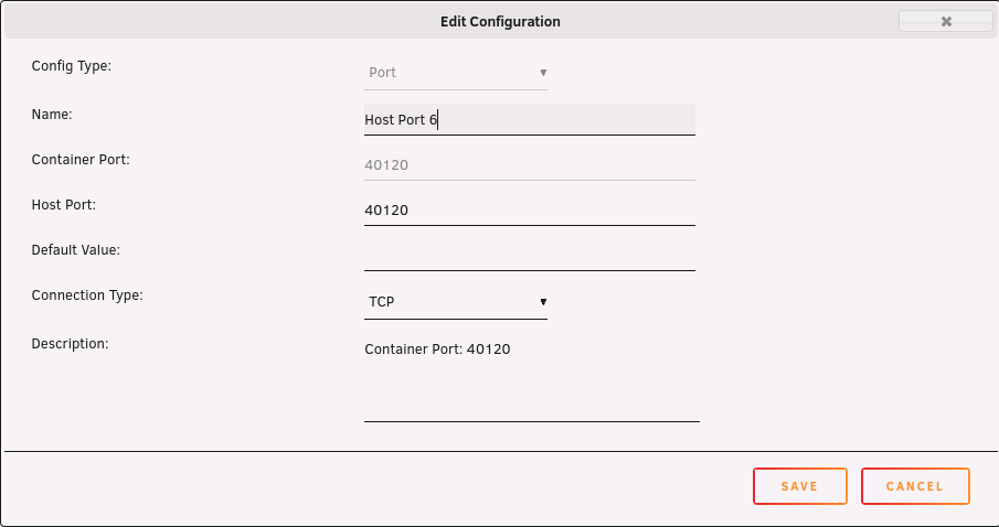

hello ich777, greetings from germany to austria ;) at first thank you for your work. i use your fivem server in docker without Unraid and it work. but i have only one problem. i dont get the webconsole or txadmin to work. i forward the port 9016 to my host but i cant reach. simliar at txadmin. i set +set txAdminPort 40120 at start variable in my environments but i cant reach them also. i hope you can help me.
Please read this post:
You have to start the container with an empty 'ConfigFile' Variable otherwise txAdmin won't load, also you don't have to fill in +set txAdminPort 40120 you only have to add the Port like in the linked post above.
i'm so sorry. what a disgrace... i don't have search this thread thoroughly. but it doesnt work. i pulled the newest image, delete all data without ressources folder and server.cfg and start the container without GAME_CONFIG variable. txadmin was not reachable. but i got an other solution. i build my own image in base of your dockerfile. only thing i changed was to remove the values on START_VARS und GAME_CONFIG so they are empty on startup. now i can access txadmin and my server is running fine :)
But why?
Wouldn't it be better you try to run it through this container otherwise I will give no support... :/
Also, when you remove the environment variables START_VARS and GAME_CONFIG this is pretty much the same as you leave it empty in Unraid in the Docker template. :D
I tried it now on my server and it works just fine (attached a few screenshots and also the log):fivem.log
You have to create this port mapping in the template:
i tried to leave GAME_CONFIG and START_VARS empty in your image. after container start the values are filled with "template", so i got the message that config file "template" was not found.
Are you using Unraid?
You have to create the Variables and leave them empty otherwise they are filled with template.
no, i dont use Unraid. i use docker only (with portainer).
Then create those two environment variables and leave them empty and delete the value 'template' after the first start, this should also work ;)
i tried this also but after every container restart the values are reappear
This seems like a limitation from Portainer. :P :D
I've updated the container so that these values are now empty by default.
Please pull it again from Docker Hub it should now work.
i restarted my container 5 times and the values are still empty und txadmin are also reachable :D
THANK YOU!
