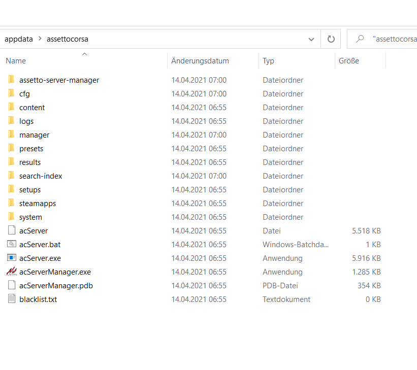

AssettoCorsa is not the easiest thing to setup I think especially with AssettoCorsa Server Manger...
May I ask where that all the files come from? If you look at my AssettoCorsa folder you can see I don't got that many files in there, have you changed something in the Unraid Docker template?
On 4/12/2021 at 3:44 PM, mikeyvt said:
- I try and launch the 'acserver.exe' file from the appdata folder.
Why did you try to launch that from the directory? The container does everything for you...
- When I try and launch the 'acservermanager.exe' file from the top level 'assettocorsa' appdata folder it says it can't find the 'Aseettocorsa.exe' file in the parent folder.
Again, exactly the same question as above.
I would recommend to start over again by deleting the container, after that delete the assettocorsa directory in your appdata folder and then grab a fresh copy from the CA App with the default settings and after that try to enable the AssettoCorsa Server Manager.

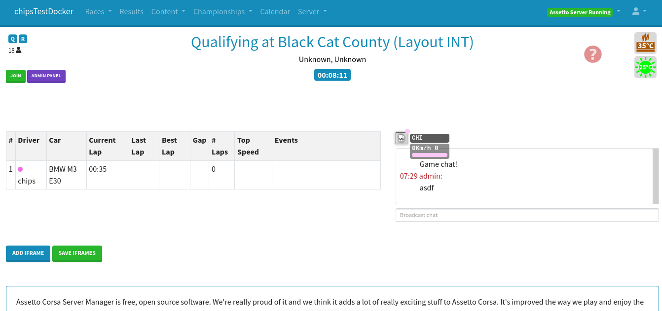

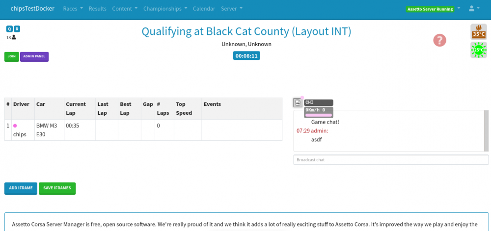

So, I have tried it on my own now and it works just fine, I've connected my PC over my WLAN Hotspot from my phone (of course I disabled the wired connection) and tried to connect to the server and it works just fine, the screenshot is from my Laptop that is connected to my local WLAN:
