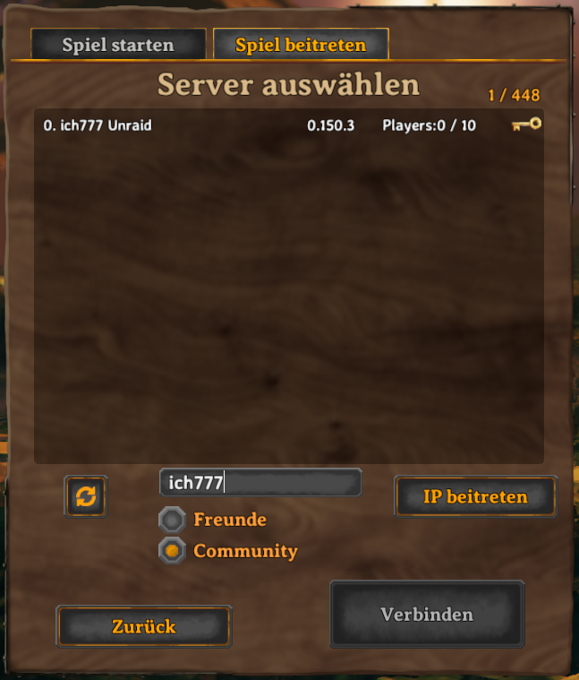

Valheim Server update? client version 150 and server still has 148
  • Replies 12.6k
  • Views 2.2m
Have you enabled the autoupdate within the container?
If not please restart the container then it should update (my containers update the game on every start/restart of the container through SteamCMD), mine, with the auto update enabled, did the update about 8 hours ago.
Here is the part from the log where it updated:
UPDATE CHECK: ---New version of Valheim found, restarting and updating server in 10 seconds---

And here a screenshot:
Success! App '896660' already up to date.

everything seems ok.. bit its still 148
update: now it has updated via autoupdate...

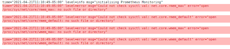

@ich777  Have you seen this in the logs for AssettoCorsa?  I'm still able to use the container just fine but this always seems to be in the logs after start up of the container:
Please ignore the errors, Assetto Corsa Server Manager can't get/set certain system variables becaus the Server Manager is running in a container without privileged rights but the variables are set to the right value.
EDIT: Also please note this is a message from the Assetto Corsa Server Manager and not from the game.

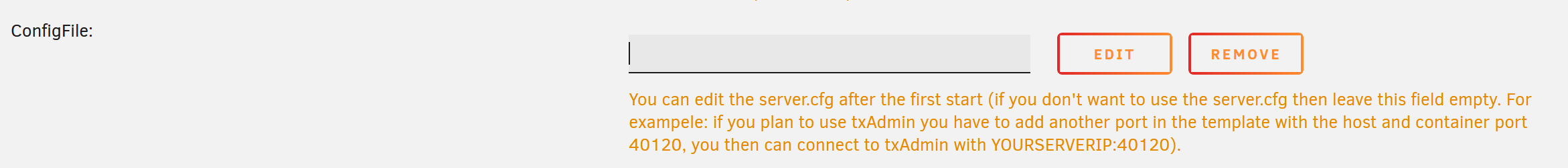

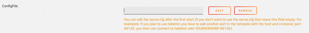

With the FiveM server is there a way to have it automatically start up TxAdmin when the container is started.  I'm having to stop the container then run the run.sh to have the RP parts of my server running.
To start FiveM with TxAdmin only simply leave the variable 'ConfigFile' empty:
Ok just did that the problem I'm having now is everytime i restart the server the txadmin is brand new and makes me run a recipe . . . not sure why nothing is saving.  I'm setting it up again in txadmin and maybe it wasn't getting saved since I had the container stopped.  Hopefully it will start saving now.
Edited by Kirball
Eventually because you run it manually, this should not happen since TxAdmin should save into the home directory if I'm not mistaken or am I wrong?
It doesn't seem to be saving anything if I restart my server I have to run the recipe all over again and everything is gone.
1 minute ago, Kirball said:
It doesn't seem to be saving anything if I restart my server I have to run the recipe all over again and everything is gone.C
Sorry I usually don't give support on mod servers since I'm really not familiar with modding the server (except for CounterStrike:Source and GO).
If you find out what it doesn't save or why it's not saving, please feel free to contact me again.
One thing that is a little strange to me because I have two users that use the FiveM Container with TxAdmin and they have never reported that something isn't working or saving.
