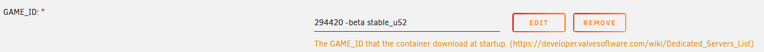

So I am using this for  7 days to die and am trying to disable automatic updates to the server. i see mention of doing it but not instructions. can someone please help me out?
Please join @Spectral Force's Discord for support on 7DtD: https://discord.gg/VwwYA5h
He is the specialist for this game but I think if you add something like: '-beta stable_u52' (without quotes) to the GAME_ID it should work, of course you have to set the version you want to stay on:

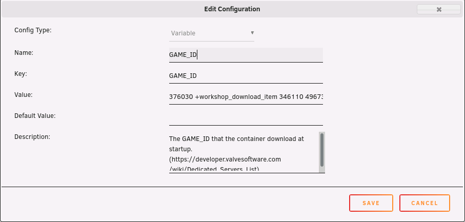

Are we able to add to the arguments for SteamCMD?
For example, on windows this is usually the default you use to start an ark server:
steamcmd.exe +login anonymous +app_update 346110 validate +quit
But i'd like to also tell it to do this:
+workshop_download_item 346110 496735411
Obviously the docker doesn't use WIndows, this is just an example.
Your work is amazing by the way!
Yes and no, but I think you can't download the game and also workshop content in one line or am I wrong?
Please look at the first recommended post from @Cyd here: Click
I really don't support installing mods but if you only would install this single mod and it is possible to do this one line that it looks like this: "steamcmd +login anonymous +app_update 346110 +workshop_download_item 346110 496735411 validate +quit" (but I don't think that's possible then simply add it to the GAME_ID:

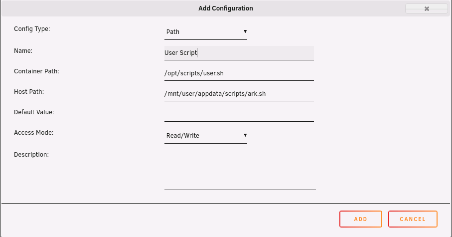

If a one liner like this isn't possible you can also create a ark.sh somewhere on Unraid and put this content in it:
#!/bin/bash
su $USER
${STEAMCMD_DIR}/steamcmd.sh \
  +login anonymous \
  +force_install_dir ${SERVER_DIR} \
  +workshop_download_item 346110 496735411 \
  +quit
exit
After you created that file on Unraid go to the template and mount it in the container like (in this example it is located in /mnt/user/appdata/scripts/ark.sh):
This script will then be executed before the update check of Ark itself is running but it should be also work even when the game is downloaded after the workshop content is downloaded.
Hope that helps, but I think the solution from @Cyd is more elegant.
