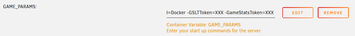

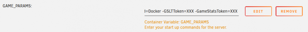

How do I add command line options to the executable the docker is launching?  I thought it was the Post Arguments field but it doesn't seem to be working.
I'm using the Insurgency Sandstorm docker and trying to add the tokens that allow stats.
I have post arguments as:   -GSLTToken=XXX -GameStatsToken=xxx -GameStats -ruleset=OfficialRules
The docker command is:
root@localhost:# /usr/local/emhttp/plugins/dynamix.docker.manager/scripts/docker run -d --name='InsurgencySandstorm' --net='bridge' -e TZ="America/Chicago" -e HOST_OS="Unraid" -e 'GAME_ID'='581330' -e 'SERVER_NAME'='DanithServer' -e 'GAME_PARAMS'='Oilfield?Scenario=Scenario_Refinery_Checkpoint_Insurgents?MaxPlayers=8' -e 'USERNAME'='' -e 'VALIDATE'='' -e 'PASSWRD'='' -e 'GAME_PORT'='27102' -e 'QUERY_PORT'='27131' -e 'UID'='99' -e 'GID'='100' -p '27102:27102/udp' -p '27131:27131/udp' -v '/mnt/user/appdata/steamcmd':'/serverdata/steamcmd':'rw' -v '/mnt/cache/appdata/insurgencysandstorm':'/serverdata/serverfiles':'rw' --restart=unless-stopped 'ich777/steamcmd:insurgencysandstorm' -GSLTToken=XXX -GameStatsToken=XXX -GameStats -ruleset=OfficialRules
31ee23b0a1903d3f3a81b8b73459ffb34785cbb2342344f21f4255478bb7f5cd
When it launches, the log has the error:  LogGameStatsServer: Display: GameStatsServer INIT: No authentication provided, -GameStatsToken= required for statistics collection, and I've tried moving the flags around with no change.
Whats the proper way of making it launch with extra command line options?
Simply drop them in the Game Parameters at the end like this (but make sure you put them on the end and also make a space in front of them):
