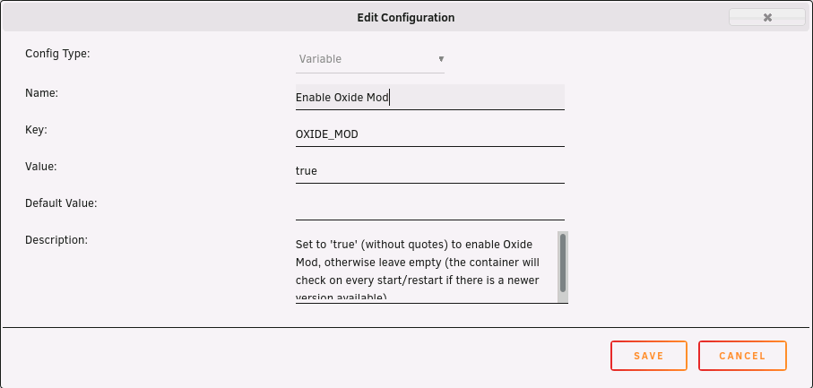

On 5/12/2021 at 9:28 AM, ich777 said:
Done.
Please force an update from the container and create a variable like this in the template:
Currently I'm don't checking if there was an update, but I'm installing the Oxide Mod every time the container is started/restarted so this should be no problem and since the Oxide Mode is not that big and doesn't contain much files there should be no problem.
You can prevent this by creating a variable with the Key: 'FORCE_OXIDE_INSTALLATION' and as Value: 'false' but I don't think this is necessary in your use case.
Hope this is what you where after. :)

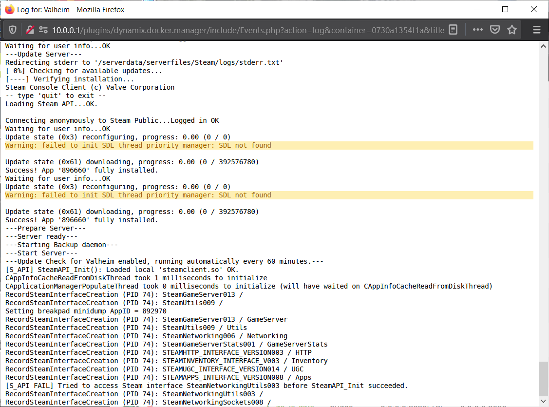

My valheim server doesn't seem to be starting.
---Prepare Server---
---Server ready---
---Starting Backup daemon---
---Start Server---
---Update Check for Valheim enabled, running automatically every 60 minutes.---
---Server ready---
---Start Server---
I followed the guide at unraid.net but i just recently started having this issue.
Isn't there more in the logs, it should look something like this:
Is it restarting?
Please try to restore your world from a previous backup from the backup folder.
Is it restarting?
I have unistalled and reinstalled so i do not have the backups. i used appdata cleanup app to cleanup after the unistall and deleted the appdata folder. I am still having this problem. my logs cycle through this.
Connecting anonymously to Steam Public...Logged in OK
Waiting for user info...OK
Update state (0x5) verifying install, progress: 0.00 (0 / 1056739773)
Update state (0x5) verifying install, progress: 10.04 (106107512 / 1056739773)
Update state (0x5) verifying install, progress: 34.41 (363574512 / 1056739773)
Update state (0x5) verifying install, progress: 50.44 (533068128 / 1056739773)
Update state (0x5) verifying install, progress: 68.30 (721717184 / 1056739773)
Update state (0x5) verifying install, progress: 92.31 (975488256 / 1056739773)
Success! App '896660' fully installed.
---Server ready---
---Start Server---
---Checking if UID: 99 matches user---
usermod: no changes
---Checking if GID: 100 matches user---
usermod: no changes
---Setting umask to 000---
---Starting...---
---Update SteamCMD---
usermod: no changes
usermod: no changes
---Starting...---
Redirecting stderr to '/serverdata/serverfiles/Steam/logs/stderr.txt'
[ 0%] Checking for available updates...
[----] Verifying installation...
Steam Console Client (c) Valve Corporation
-- type 'quit' to exit --
Loading Steam API...OK.
---Update Server---
---Validating installation---
Update state (0x5) verifying install, progress: 22.20 (234544877 / 1056739773)
Update state (0x5) verifying install, progress: 41.81 (441804021 / 1056739773)
Update state (0x5) verifying install, progress: 76.19 (805090469 / 1056739773)
---Server ready---
---Start Server---
Have you installed a Cache drive, if yes can you please tell me to what you appdata is set in the Share section in terms of "Use Cache" is it set to "Yes"?
If it is looping something is very wrong.
  1. Please try these steps one more time:
  2. Delete the container
  3. Delete the folder that lives in your appdata folder for Valheim
  4. Make sure that in your appdata folder the directory "valheim" is really deleted
  5. Pull a fresh copy from the CA App
