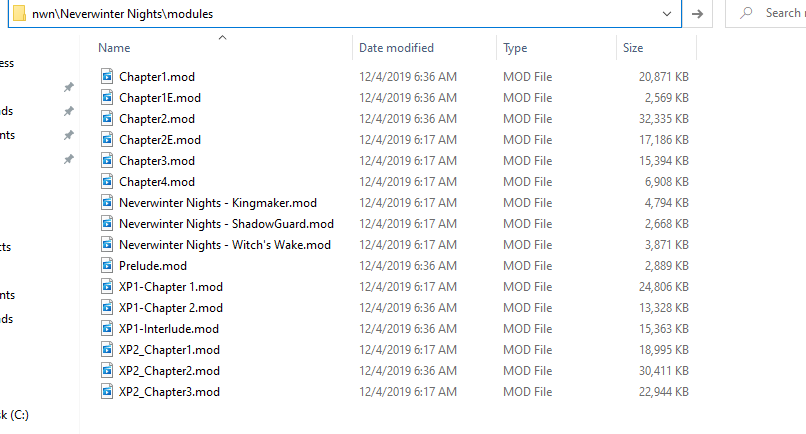

Gosh it's been so long since I did this. I want to say yes I just renamed them and made the extensions .mod  . I'd say try that and see. I will say I now have these files as a backup in case I need to ever do it again. Hope it works!
Yea, that didn't work, same thing, no modules in folder.  I feel like I'm missing something simple.
Have you installed a Cache drive in your system? If yes, make sure that the share that the game files are on "Prefer" or "Only" in the Share tab in Unraid at "Use Cache" otherwise if you set it to "Yes" unRAID will move the files from the Cache files to the Array and the Container can't find the files anymore since in the template the path to the files is usually set to "/mnt/cache/appdata/..."
I do not have a cache drive, but your post got me there.  The server files location was set to /mnt/disk1/appdata.  I changed that to /mnt/user/appdata and that appears to have gotten me going.
So, what module do I load if I just want to play the original campaign?  Do I have to specify each module individually or ???
I think so but eventually @HellraiserOSU can help, since I did this container by request.
Thanks!!!!

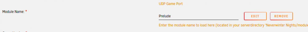

If you want to play the original, Prelude is the one you want  to start. The docker config will let you set what module it loads up initially. After that  the save file takes over.
