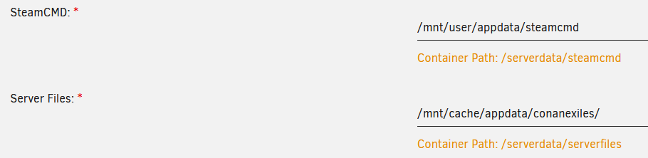

so  the ONLY change i have made was the installation directory so it installed into a share that is NOT on a cache drive..
https://pastebin.pl/view/ad2a3afb is the errors im getting...
i changed the pre set installation folder from a cache share to a non cache share..
/mnt/user/No cachish/Conan/ for steam CMD
/mnt/user/No cachish/Conan/ for server data
heres a pic

Please don't point SteamCMD and the Gamefiles directory to the same location!!!
Try to do it a little different for the Gamefiles since it can split between disks and do it something like /mnt/disk1/No cachish/Conan

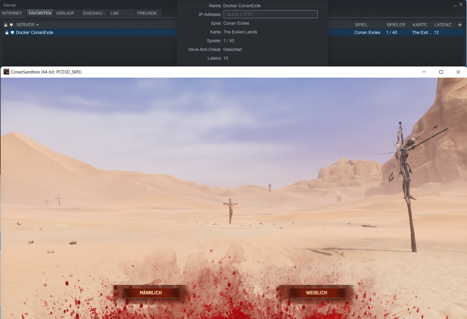

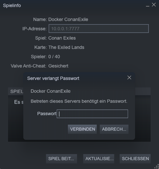

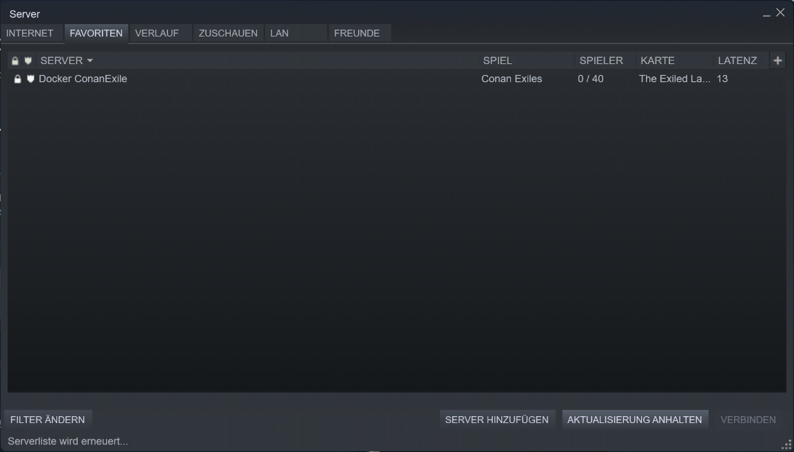

As promised, the screenshot (I absolutely changed nothing and left everything at default, I think you can see what I want to say with that picture on top is the Steam Server Browser where you can see that 1 player is connected to the local IP and in the bottom window you can see the game itself):

Then please answer the question that I've asked on the last page... Is your share where the game "lives" set to Use Cache "Prefer" or "Only" ("Yes" and "No" won't work with the default settings from the template since if you choosen "Yes" then the mover will move the files from the cache drive to the array)?

Also I just wanted to show that the container is running in the basic configuration and you basically have to change nothing so that you actually don't have to search for anything or think the container is not working.
Anyways, how did you connect to the server in game? Have you also tried to click on "Direct Connection" in game?
EDIT: One thing, please always use physical paths to the game files since most games won't work if you use /mnt/user/... (Don't Starve Together, TeamFortress2,...) but keep in mind if you use /mnt/cache/appdata/conanexiles your Use Cache setting is set to "Prefer" or "Only"):

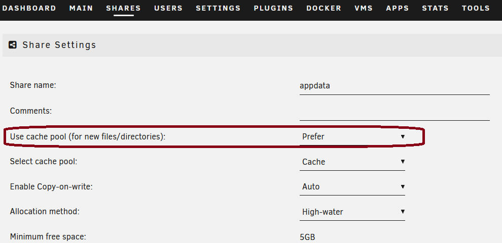

my appdata is set to yes..    I will change that to prefer and try installing without making any changes..
i was installing it under mnt user ..    good to know for the future as i never knew this!  Thank you!
That is most likely the issue here, does your mover run very often?

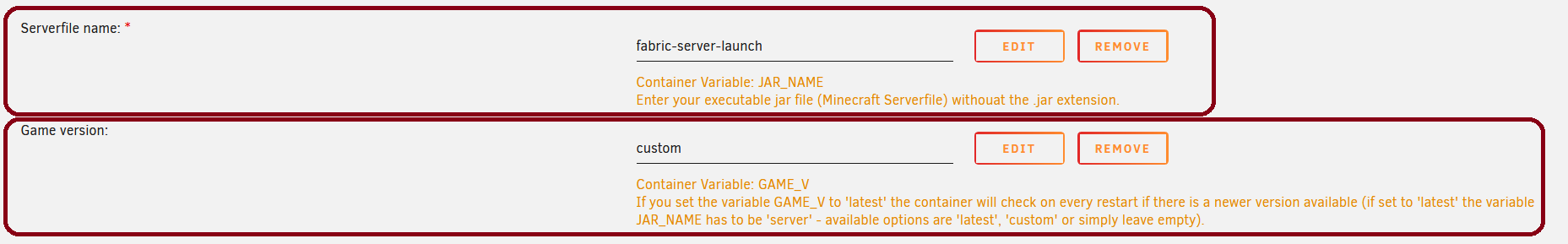

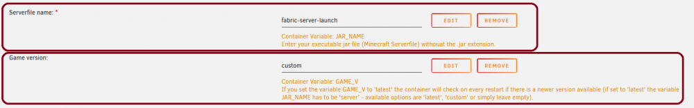

I'm so sorry, I didn't see the response because I thought that was for someone else.  I've added the fabric server files and mod to the minecraft server container, but I can't get the server to start as a fabric server.  It just keeps starting as a vanilla server.
Disregard, I figured it out.  I set the server filename as "fabric-server-launch" and it seems to have started up fine.

Did you also enter the port 7777 to your IP (eg: "yourUNRAIDIP:7777" and click on refresh on the bottom from the Steam Server Browser)?
If you want to connect from ingame click on "Direct Connect" on the bottom and enter yourUNRAIDIP and the port 7777.
