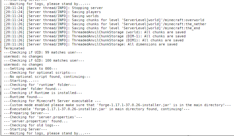

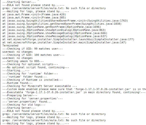

You all have a running Forge Minecraft server. Maybe you can help me. My son asks for a "Minecraft Sky" server. If my research is correct this Client Mod needs the modded Minecraft Server of the Forge Project. So I downloaded "forge-1.17.1-37.0.26-installer.jar".
Then I tried two different ways, but both do not work:
A) Install Vanilla first:
After installing the MinecraftBasicServer and checking that it runs properly, I copied the "forge-1.17.1-37.0.26-installer.jar" into the server's folder:
In the next step I changed the docker settings accordingly and restarted:
But by that it reboots forever:
B) Install directly with forge.jar
As the first way wasn't successful I deleted the container and all files again and started the container directly with the changed serverfile name:
Except of the missing Eula it has the same problem:
Any hints?
From what I see in the logs it seems to me that something is wrong with the Java version or better speaking it's the wrong version for this Forge version.
Btw, I hate Forge, it runs for a few days/hours and randomly it stops for no reason and won't start up again... :/
You can try to change the Java version to something like jre8 "basicjre" in the Advanced Settings in the template:
Steps to perform when changing the Java version:
  1. Stop the container
  2. Delete the "runtime" folder from the Minecraft directory
  3. Change the Java version and start the container again
EDIT: Or eventually try "jre11", Java 16 is needed for the vanilla Minecraft servers.

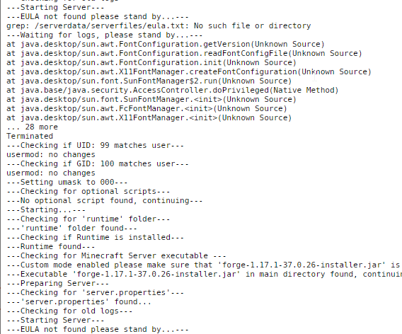

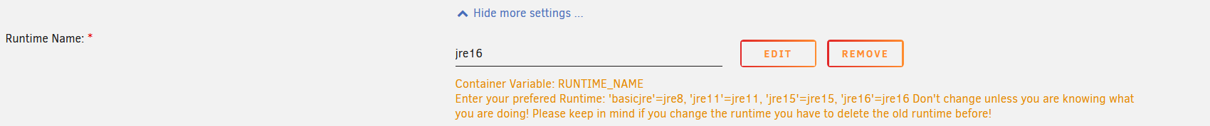

jre11 and jre15 did not work. jre11:
I did a little bit research and 1.16 needs jre8:
https://forums.minecraftforge.net/topic/101889-can-you-make-a-forge-server-with-java-16/
So I tried "basicjre", but still not working:

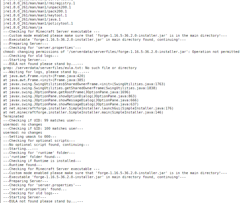

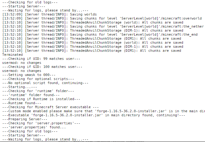

As they were talking about 1.16, I downloaded forge-1.16.5-36.2.0-installer.jar and tried it with "basicjre", but still not working:
As I'm still not sure if I need to install Minecraft Vanilla first, I downloaded and installed 1.16.5 vanilla with "basicjre", which works flawlessly, then I stopped it and changed the server name to "forge-1.16.5-36.2.0-installer", but still no success:

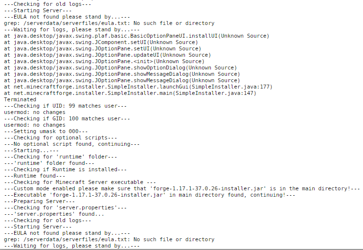

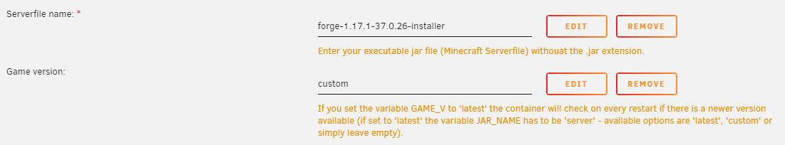

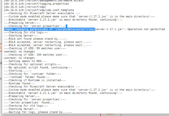

This is just the installer, but I've tried it now in many different ways and don't get it to work.
From my understanding how it works is you run the installer to install the libraries and everything necessary for Forge and then pass this line to the JVM extra parameters: @libraries/net/minecraftforge/forge/1.17.1-37.0.1/unix_args.txt to actually load Forge but when I do this I get a Java error.
I've run the installer locally on my Windows machine and copied over the files to the server directory, just be sure to select Install server in the installer, this should basically do the trick.
But as said above can't get it to run because I get another Java error and giving up for now...
What is even more funny, the installer needs Java 8 and the game, at least from what I know needs Java 16, only discovered this because I also tried to install it it directly in the container itself...
One little hint if you get it to run you have of course to increase the RAM size because Forge uses a lot of RAM.

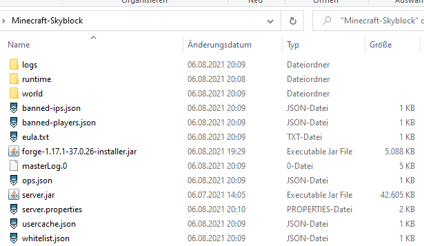

Finally I was able to start the installer (1.17.1) and install the server in a windows environment and extract the server.jar. After pasting forge's "server-1.17.1.jar" (Download) into the basic minecraft docker path, it installed (jre16) and started with an error message, but which could be solved easily:
I'm not sure if it wouldn't even possible to execute the installer inside a docker as there is with java -jar forge-installer.jar --installServer a terminal command available. But I totally skiped Forge, after I surprisingly found out that my son wasn't talking about the mod Minecraft "Sky". Instead he meant "Skyblock". A simple map 🙈

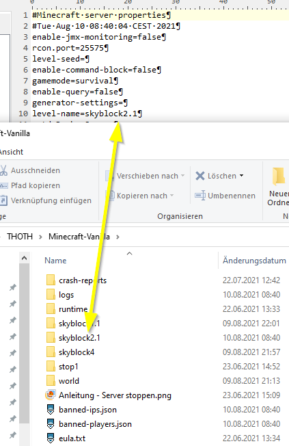

If anyone likes to know how this works. Download the map:
https://skyblock.net/downloads/
Stop the container, extract the map to the container's path and name the folder for example "skyblock2.1" and inside of the server.properties, rename the world to "skyblock2.1", too:

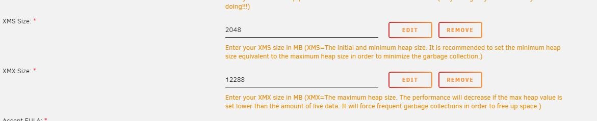

Hey, smb know how i can change the max Ram usage from the minecraft docker?
i set XMX to 12gb but it still uses like ~18gb
1.thumb.JPG.dd69b85c7391bd036707b24cbf9c5663.JPG2.thumb.JPG.8187af1b367b700512227a7ade08062a.JPG
Open up the Advanced View in the Docker template and append at "Extra Parameters":
--memory=12G
--memory=12G

59 minutes ago, Cornflake said:
thank you
But keep in mind that if you limit it like that the server will/is most likely going to crash.
