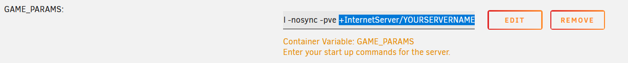

7 hours ago, icepik said:
Is there a way to just prevent steamcmd from running when the docker starts up?
Do you already joined @Spectral Force's Discord?
The container shouldn't update itself when you have the value in place, it's basically the same as if you do it manually and it shouldn't update to anything higher.

On 9/1/2021 at 12:19 PM, ich777 said:
Just append this to your GAME_PARAMS in the Docker template (well change YOURSERVERNAME with your server name):
+InternetServer/YOURSERVERNAME
After doing this, this changed my map from a workshop map called California to PEI. What am I doing wrong?

also I noticed it creates another file for the server. It was using Default in appdata/Unturned/Servers but now it created a new one called UV6J83~V
Can you edit this file?
I'm not too familiar with Unturned but maybe it needs another confog for internet games...
tried and for some reason still on PEI
Is it possible that California is a non standard map and that's why it's not working when you enable internet play?
You can also try to remove that parameter and/or replacing it with '-california':
no clue. I did change that to -california whenever I set it up.
