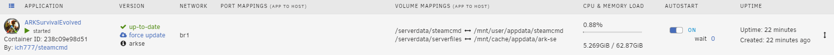

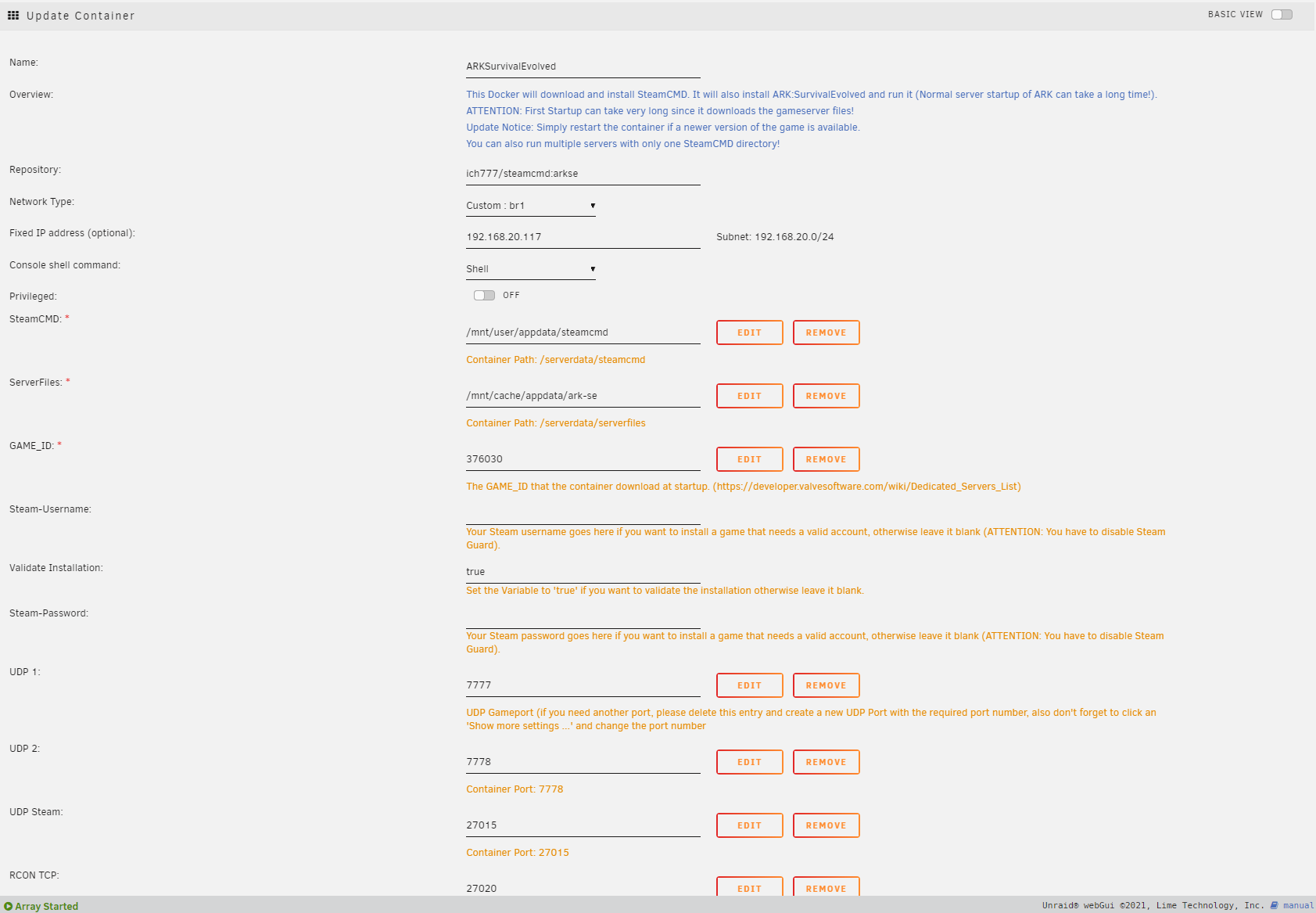

Still having trouble getting Ark Survival Evolved server to work.
Here is what I've got.  I went back through the thread and didn't see @Cyd reply, did I miss it?
I tried removing the container, deleting the folders it created on the drive and still nothing.
All of my port forwarding for the UDP and the TCP ports to the container are setup.  Only forwarding UDP traffic to the UDP ports and only TCP traffic to the TCP port.  (UDP:7777,7778,27015) & (TCP:27020).
The firewall allows the traffic inbound as well for these ports to the container.

Have you tried to run it in the default bridge mode?
Please remove 'true' from Validate Installation, that will do nothing on a fresh installation.
From what I see the server runs fine... Can you also post the log output?

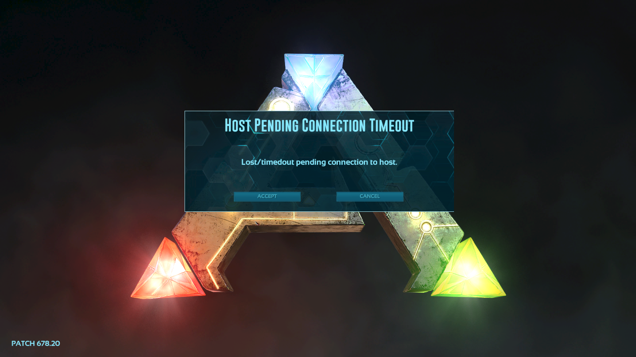

42 minutes ago, Saiba Samurai said:
Tried to connect, prompted me to Install BattleEye..
Through what? Steam Server Browser or in game?
BattleEye is not necessary, look at the template, BattleEye is disable.
Btw it never asked me to install anything on my PC.

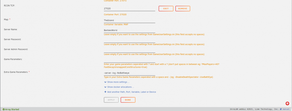

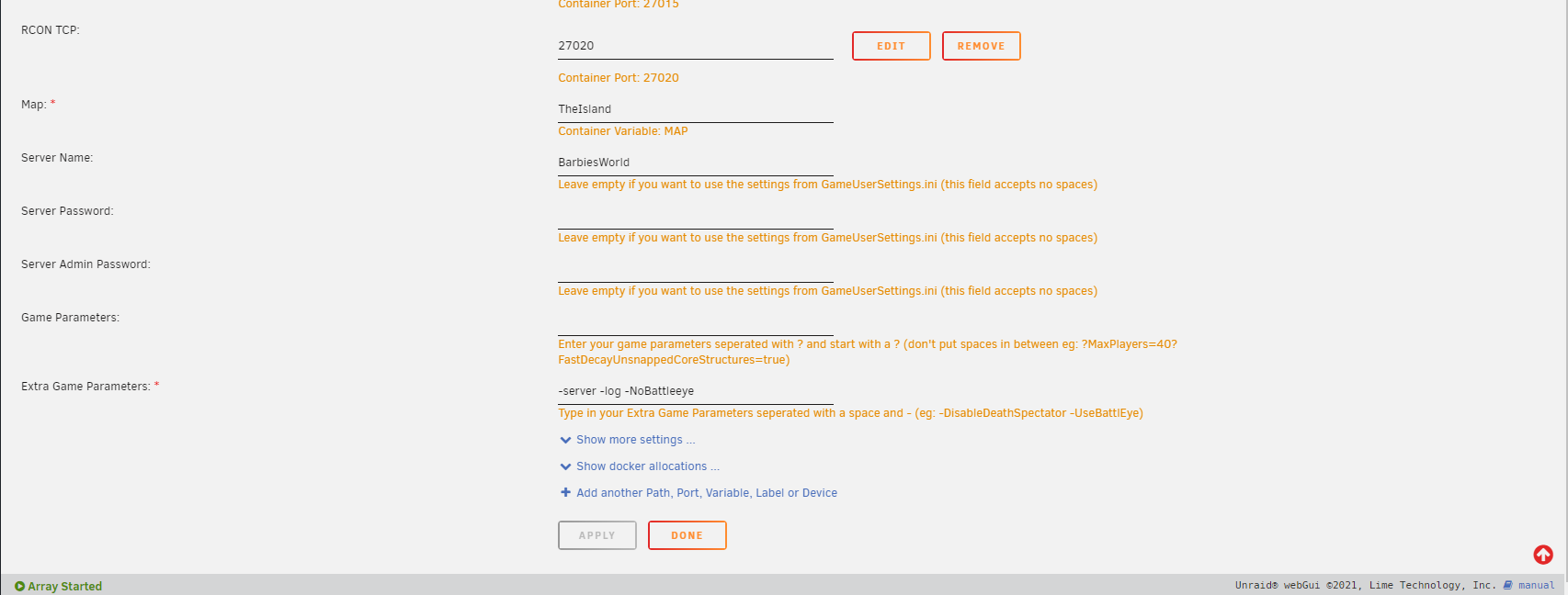

So it's working... no changes from last post other than using BattleEye.
So I put in -NoBattleEye to try and not make it a requirement.  When I launch the game and choose the option to not use BattleEye it would not connect, and it would try to get me to install BattleEye.  I did some googling and there were posts talking about that flag not working.  So I tried with BattleEye and it worked.
This is still in Bridge mode, which I do not like.  I am not sure what would prevent my machine from getting on the container.  I can ping it without any issue.  But this is definitely something funky with the network.  So at this point it's confirmed not a container thing!

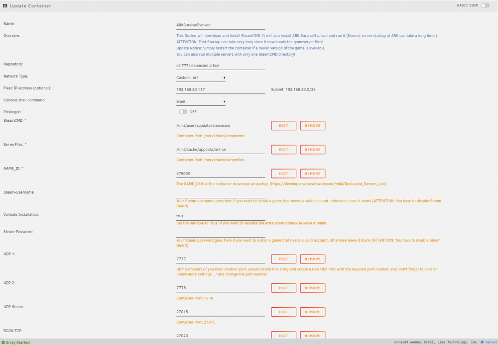

I have another unusal problem with an ARK Docker, Where the config files are missing but the server is listed and working.  I am using @Cyd Templates for the ARK Cluster all is working but the config files location /linuxserver is missing on map Valguero_P config
Here is my Docker config file
The docker is up and running and even found in the browser.
When I browse to that location, no config files to be found.
Edited by deaerator
I suspect that SMB share isn’t pointing at the cache drive, open a terminal on the UnRaid machine and ls -l /mnt/cache/appdata/ark-se/ARK6-Valguero_P I bet you will find them there.
I too roll a UDMpro and all of my ark cluster (10 arks), a valheim server and a pair of foundryVTT containers live in my UnRaid box. I will post some configs tomorrow if I remember.
No, its not there
