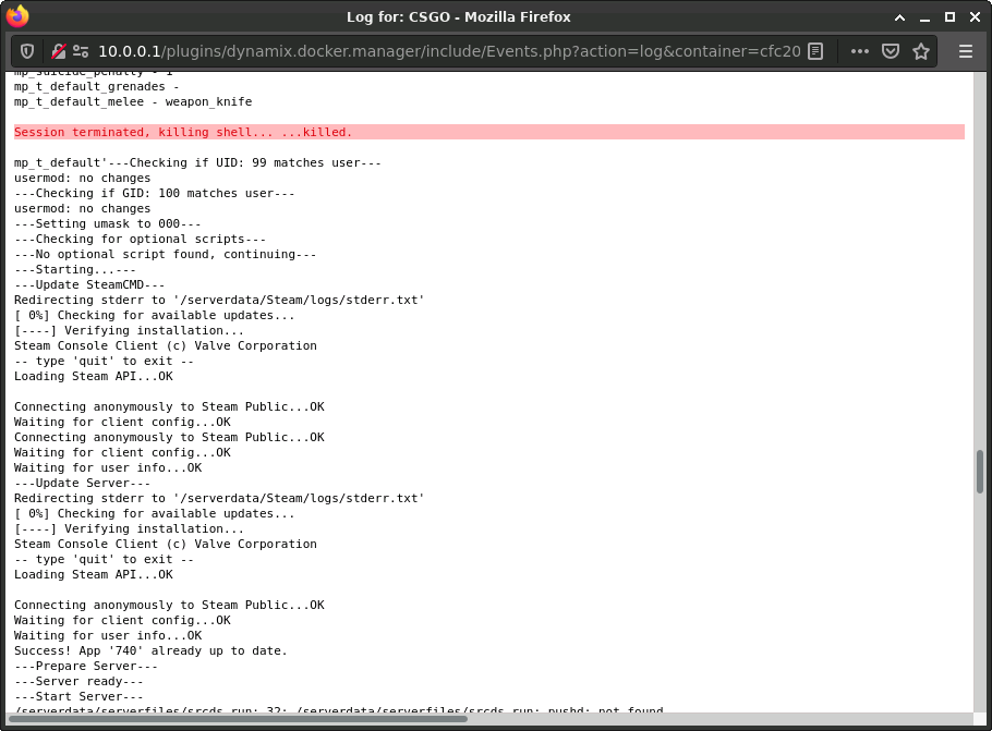

24 minutes ago, Niyah said:
It is still verifying the install everytime I restart / launch the docker !
Would it be because I'm using MetaMod & SourceMod on it ? :(
No, can you post a screenshot from the paths in the template? I think there is something wrong.
Usually the server doesn't do this every time, on my system the server updated (haven't started it in a long time) and after a restart it starts just normally without validation, have you maybe installed something else (mod or something like that) that is forcing a validation?
1 hour ago, Niyah said:
It still happen, the docker is verifying install at every start even with a totally clean install ! :(
Is the container installing the game completely new or is it just verifying the game?
Have you set the share to use cache only in the share settings?
2 hours ago, Niyah said:
Re-made the share & the docker, still doing the same things.
Edit:
Honestly ; as long as the server is working I don't really mind the docker verifying the files ; It's rather quick anyways ! :) Thanks a lot.
I still can't reproduce this on my server, as you can see from the screenshot above the red line is from where I restarted the container and you can see almost at the bottom that the log says "Success! App '740' already up to date." and it continues without any updating, somthing forces your container to update:
Have you put in Steam credentials to the template if yes, please remove them since they are only needed if the are marked as required with the read asterisk (*).

13 minutes ago, codearoni said:
I was wondering what the right approach would be to get that update in your gameserver docker?
Restart the container, if it doesn't pick up the update give it a little time please.
On some systems it can take a few hours to actually pick up the update, don't know what's causing that, maybe try to restart your router/firewall and then try to restart the container.
If you run Unbound, PiHole, AdGuard or something like that in your network please try to restart these too.
You can also try to set Validat to 'true' but if you affected by this issue that it isn't picking up the update from Steam right away you have to wait... :/
 @deaerator if you enter the containers console and navigate to /serverdata/serverfiles/ShooterGame/Saved/Config are they there? From the containers console run 'ps axfww' to see the whole command line that got passed to ShooterGameServer, maybe there is an alternate dir specified?
Maybe try copying in one of the folders from another ark... then see if it loads settings from them.
