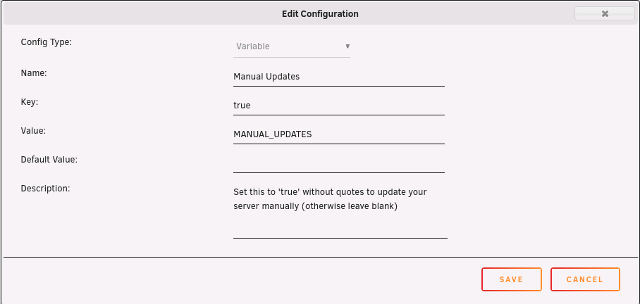

I found an error in my template, will change that ASAP, please click on "Edit" at the Manual download and change it like this:

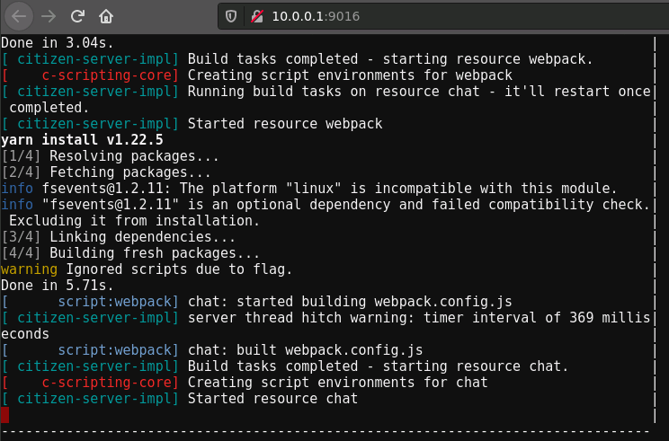

I do notice it opens up to port 8080, so I force it to 9016, but same thing.
I don't understand what you mean with that, I've now tried it and it works just fine.
Are you connecting to "YOURunraidIP:9016"?
Here is a screenshot from the WebConsole:
Keep in mind the WebConsole is only available if the server is fully started!
Also attached the log from a full server startup: fivem.log
