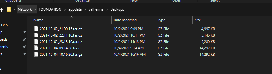

On 10/1/2021 at 12:11 PM, ich777 said:
Please try to stop the container, remove the Backup folder, start the container again and see if the backup archives are created properly...
Is it possible since the last update that the worlds where reset, I'm not too sure about that but I think I've read that somewhere...
Yea it might be the case.  The cache settings is set to yes.  When i browser the share i see everything no matter where it resides on cache or disk.  They should be identical.  Unless I am missing something about how unraid shares work.
Either way we restored and continued our efforts on the Valheim server.  Just curious as to why i dont see more backups when the system is online 24/7.
Edited by TCMapes

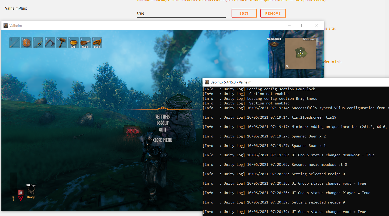

Playing Valhiem. Want to give Plus a try. Set it to true for ValheimPlus. Restarted server. Updated config file. Installed the client. Client shows "Version 0.203.11 - Valheim plus 0.9.9" in bottom corner.
Log on the server has "Peer 76561197966542871 has incompatible version, mine:0.203.11 remote [email protected]"
This makes me think the server isn't loading ValhiemPlus
Can you also post a screenshot from your Docker template?
I think that's the issue.
Since the template uses /mnt/cache/appdata/... it writes it to another directory, I always recommend to set the share where the game files are on to "Only" or "Prefer".
Have you installed another cache that is called "cache"?
I've tried it now on a new installed instance and it works just fine:
I hope this screenshot makes sense to you... :D
As you can see from the game log it says: "Successfully synced VPlus configuration from server" (sorry for the cut off image).

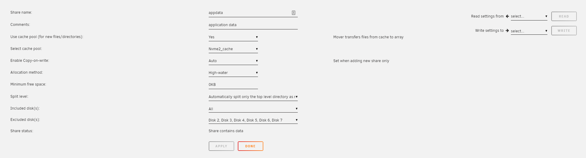

On what share is the game on and to what setting is the Share set in terms of "Use Cache"?
How often do you invoke the mover?
Can you send me a screenshot from the template where I can see the path mappings?

Appdata share: https://gyazo.com/4ab476cad2a55365fbdbc347944c4422
Arrays: https://gyazo.com/92ae4fa0e857e3205f0cbd2c3c9e74c2
I just noticed the mnt/cache/appdata/valheim2 could that have anything to do with it?
