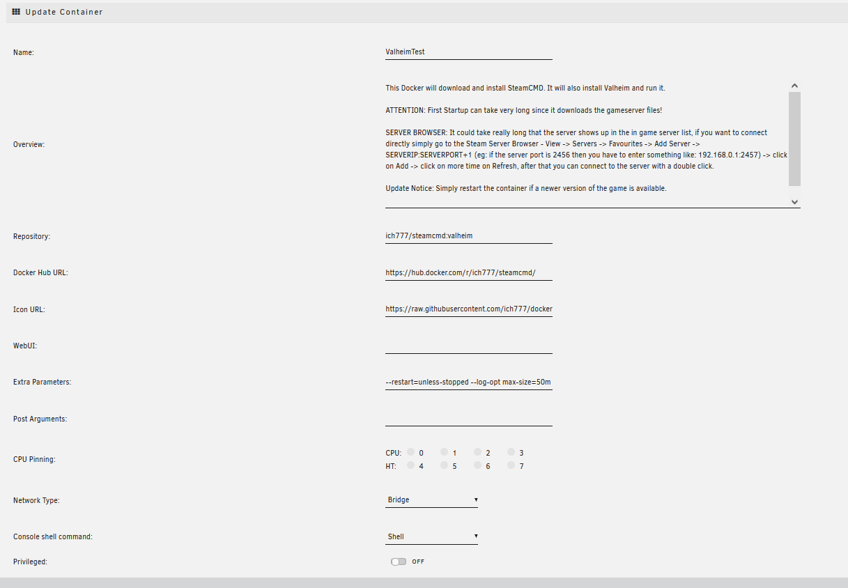

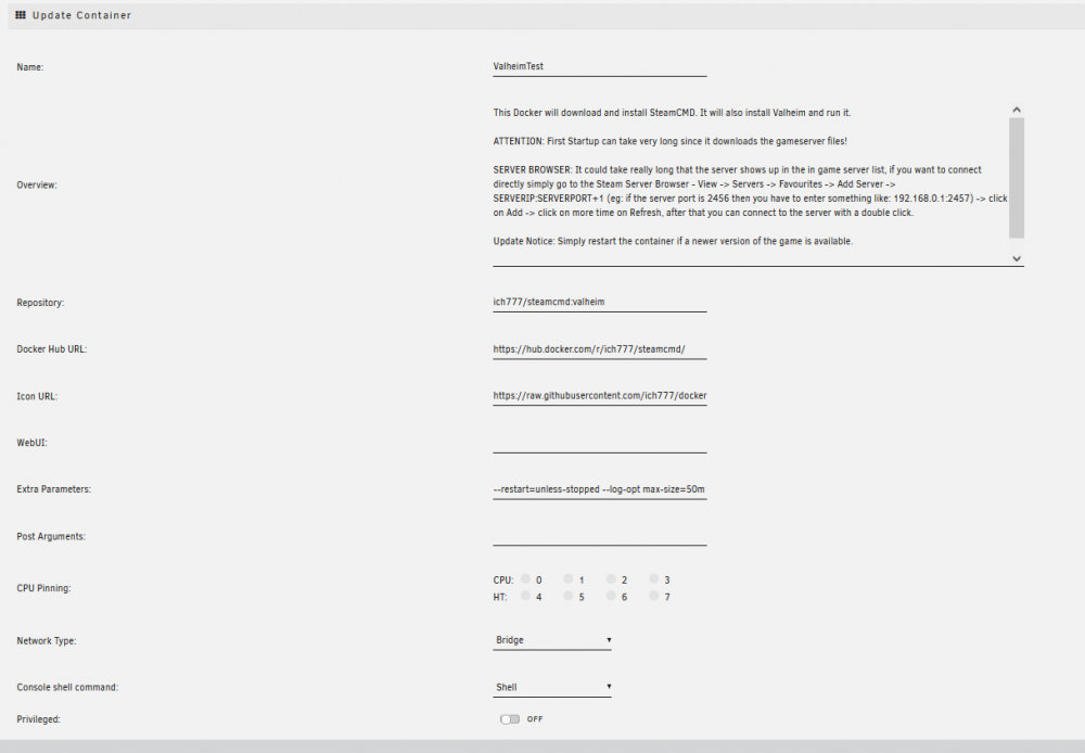

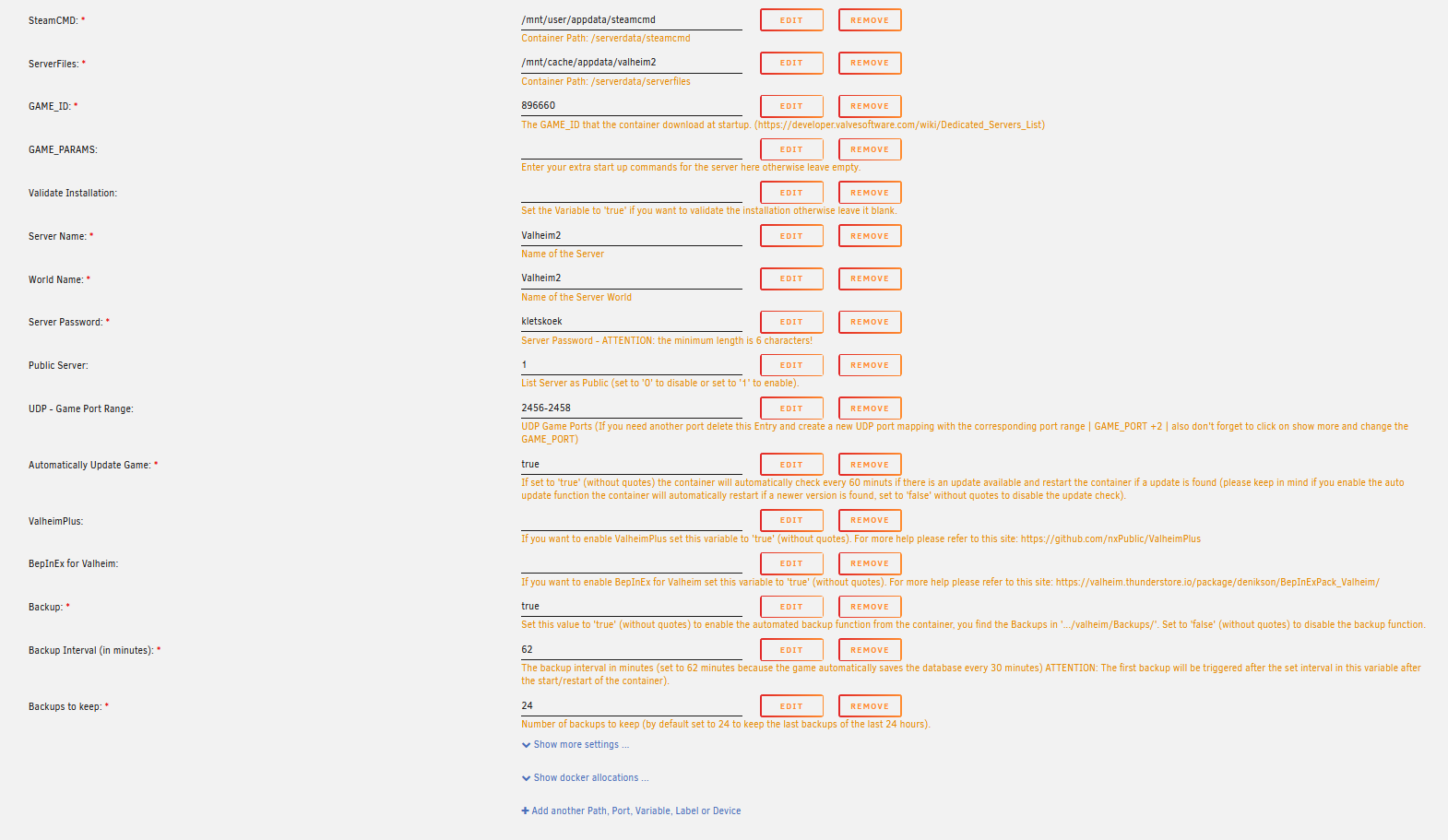

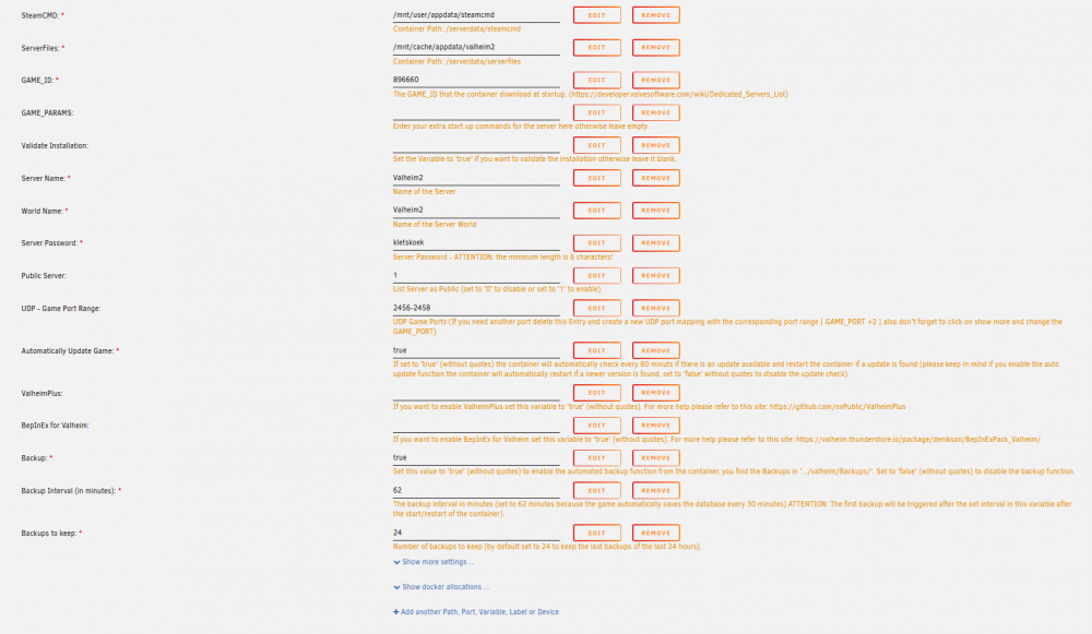

10 minutes ago, ich777 said:
These are the same pictures, please post the paths from the template, you can post screenshots here to, simply drop them in the textbox or press CTRL + C if you have them in the clipboard.
@Koen that can't work, you have set your appdata to Use Cache "No" and the game points to /mnt/cache/appdata/valheim2
Please set the path in the template to /mnt/user/appdata/valheim2
After that it should work just fine.

Unfortunately that didn't change anything, it still won't donload more files and after around 10 minutes the container goes to 0% cpu and 0% ram usage
Please delete the whole container and the directory in your appdata directory that was created for the container, then I would also recommend to reboot unRAID.
After that go to the CA App and redownload the template and change the path to /mnt/user/appdata/valheim2 before you start the container for the first time.
