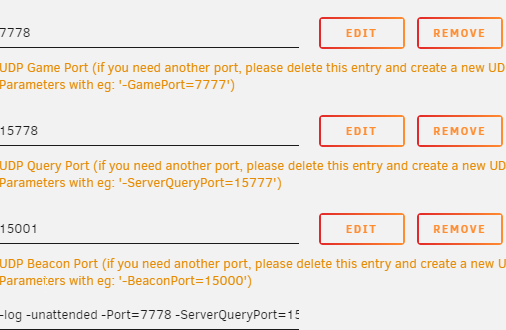

17 minutes ago, ich777 said:
Only the game directory, the SteamCMD directory can be the same (this is also mentioned in the description from the container).
I hope you have als read that you have to delete the ports and create new UDP ports within the template and add 3 options to the Game Parameters if you want to change the ports, a simple change from the ports won't work.
I have changed the directory for the second docker, edited the ports listed in the template and added the parameters however the server just doesn't seem to show as online.
My original server for friends etc is still working fine, this second one has a mind of its own
According to the wiki for dedi servers the param is now just '-Port=xxxx' for the UDP Game Port
This was changed I think, since when I created the container it was GamePort.
Can you try if it is still working with GamePort?
EDIT: Forget it I saw in the Wiki that it says it was changed with patch 0.5.0.4
Oh and you just changed the ports that where already in the template or am I wrong, that won't work because you have to delete them and create new entries with the same container and host port as you set in the Game Parameters.
i try to run 2 satisfactory Server, too.
I am able to run 2 Server, everyone has it´s own config and folder. This works.
Important: you must DELETE the default three entrys in the docker config for the ports and create new one for 7778, 15778 and 15001. Then it will be work. I have made the same mistake in the first attempt´s.
But my problem is, i can not connect to the second Server. The first run´s great with default ports. The second with modified Ports give me the error "invalid authentification token". i don´t know why...
I'm confused by what you mean here
The three template fields were changed with a +1 increment and all three port params were put into the Game param field. Is there something else I am missing?
Delete, create new one and set the extra game parameter.
my look like this and it work:
Yep, only said this because in the previous screenshot you had the origonal entries in the template and only changed the ports, that was my point. ;)
Sent from my C64
It wasn´t me. It was Forsco. :-)
Hope he got it now.
Sent from my C64
Thanks! Didn't realise the container ports were staying as the defaults, thanks guys!
All working now, and can connect 👍
@MX-Hero, make sure you've updated your -GamePort=xxxx param to just -Port=xxxx
Thanks man! That was my mistake. i´ve missed that. Now both servers are running great.

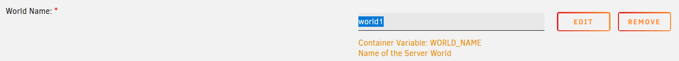

20 minutes ago, Erhnam said:
Have been running valheim server succesfully. Started a new world recently and now i would like to run both worlds. At the same time or with easy switching.
I don't know what you mean exactly, I think you don't want to run two servers at the same time with two different worlds or am I wrong?
If you want to switch between worlds simply change the name in the template from the world back and forth, just be sure that you use always the same two world names:

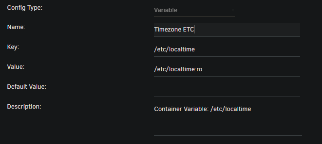

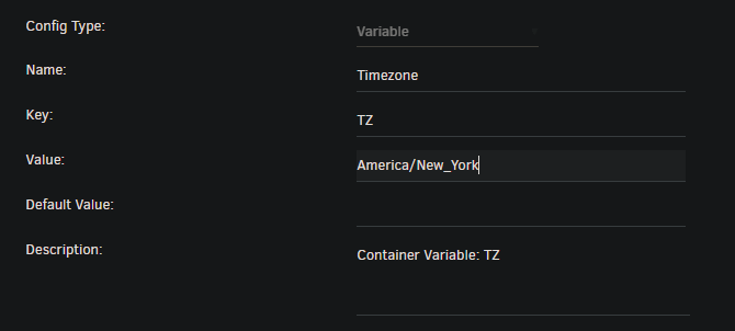

I might have missed it somewhere in the documentation, but is it possible to get the times in the logs to match your local timezone rather than UTC? I've tried adding the TZ variable:
-e TZ="America/New_York" \ (example)
to the container as well as:
-v /etc/localtime:/etc/localtime:ro \
But the logs seem to revert back to UTC (I'm +9.5):

EDIT: Actual Unraid Template screenshots would probably help:
This won't work because there is no routine built into the container that will actually make use of the variable.
Anyways your second screenshot seems wrong, you try to pass through a Variable instead of passing through the path or better speaking the file, this will do basically nothing, it should look like this:
I would recommend to create a post on the Community Forums/Steam Community Hub from the game as a feature request, maybe there is alread  a option built into the container to use the local timezone and not UTC.
Right, my bad. I'm used to manually spinning up docker files in non-Unraid environments and added the Variable path to substitute for -v.
As for raising it under Satisfactory Steam Community/their own QA website, they have announced plans to spin up Satisfactory Server as a docker hub container, but no ETA on when that will actually come to fruition.
Not a big issue, I just like things to represent actual time zones of where I am. :)
