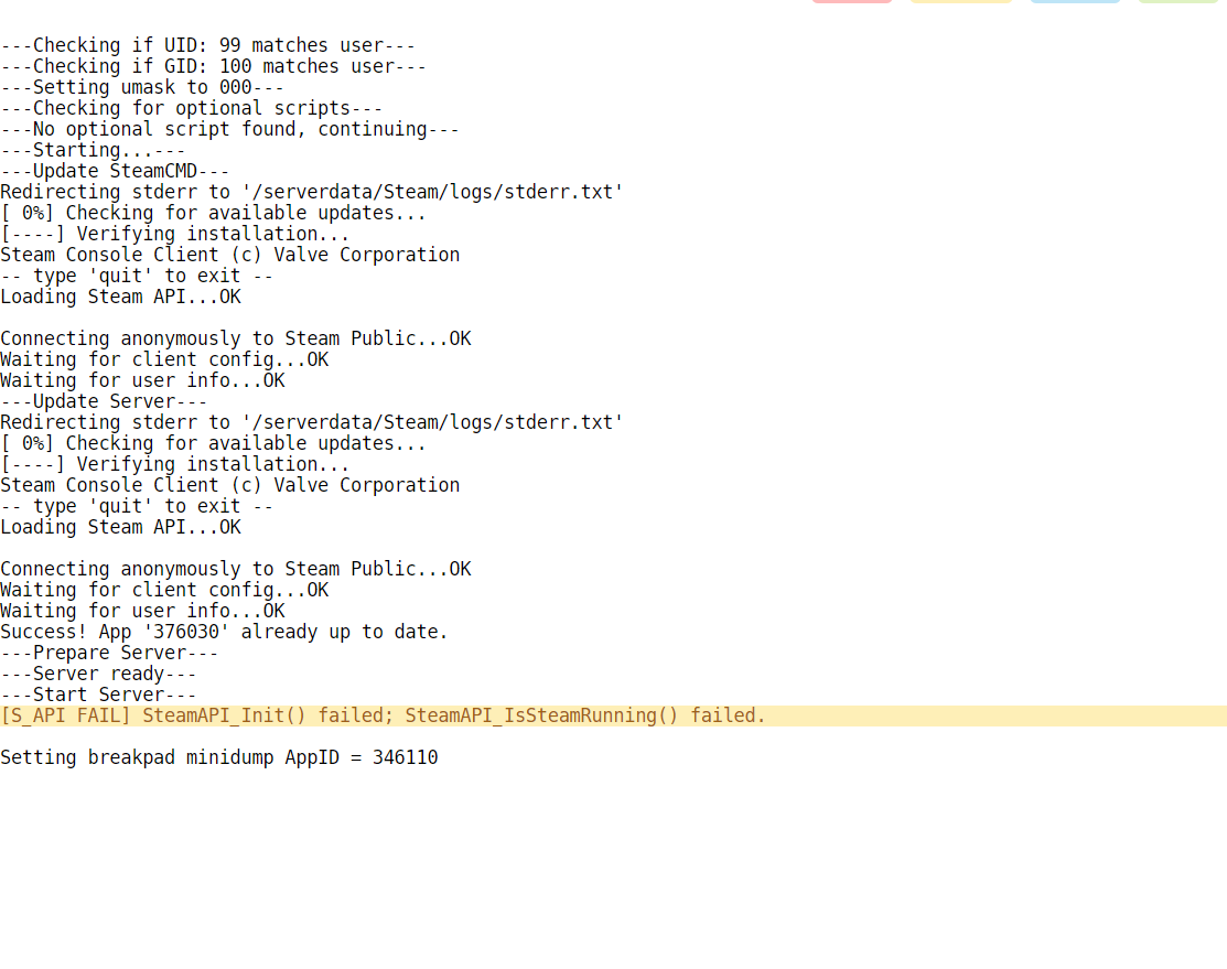

I'm a little new to unraid and wanted to try out the ark survival docker and It's not working I went to the ini files because I just came form linux to unraid and its driving me nuts!!
What have you done so far?
Have you changed any setting in the template?
Have you installed a Cache drive in your server, if yes to what is the setting "Use Cache" set in the Share settings?
Have you put in Steam credentials to the template, if so please delete them, the credentials are only needed if they are marked as required with the red astersik (*) -> see also first page.
2 hours ago, Optimum Frost said:
anyone know of a video I can follow or even a proper setup guide?
You don't have to do anything, let the container do it's thing and watch the logs, after it downloaded the game it will start the dedicated server and that's it.
The container is not different to a server on bare metal with the only difference that the download through SteamCMD and start from the Server itself is automated.
Can you send me a log from the container so that I can see where it is actually failing?
Thanks for replying this is what I did.
I downloaded the ark survival docker
added server name, server admin password
changed map to TheIsland
added ?RCONEnabled=True to Game Parameters
then added -NoBattlEye -noantispeedhack -crossplay to Extra Game Parameters:
I do have a cache the is says "yes:Cache" on all my files
I left the steam credentials blank
and not sure if it makes a difference but i am using ark on epic games

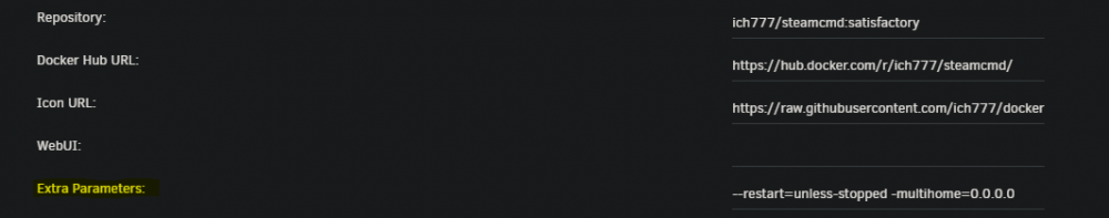

Just FYI, the new 5.0.6 update for Satisfactory borks the server, it will not start. Its been reported on their bug tracker already, so avoid restarting your server until they issue a new patch.
Satisfactory Q&A (satisfactorygame.com)
EDIT:
NEVERMIND. ISSUE IS FIXED WITH -multihome=0.0.0.0 in the docker settings under "game parameters". Add this to fix your servers!
Issue was caused by CoffeeStain adding IPV6 support

@DazedAndConfused Are you adding the -multihome part to the Extra Parameters template under Advanced View? Or somewhere else?
If I add as you've pasted above, I get:
invalid argument "ultihome=0.0.0.0" for "-m, --memory" flag: invalid size: 'ultihome=0.0.0.0'
If I add a double-dash ( -- ) :
unknown flag: --multihome
Adding to Game Parameters starts the container, but throws the error listed on the QA website:

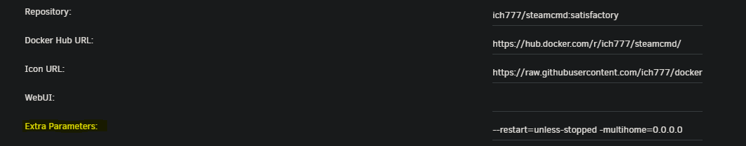

Yes, under "game parameters" in the docker, just add "-multihome=0.0.0.0". For whatever reason your error is reading in the parameter as "ultihome=0.0.0.0". I have no idea why its reading "-m" as an argument and missing the rest of it.
Edited by DazedAndConfused
Ahh, Game Parameters and Extra Parameters aren't the same thing (that's where I was getting confused):
vs:
As the error suggests, 'ultihome' is because '-m is another abbreviation for --memory in unRAID, and it's in the wrong format.
Just tried again under Game Parameters only, and (after a few restarts) it seems to have registered. Thanks @DazedAndConfused.

Thats my fault, I said extra parameters first when I meant game parameters. Im glad you've got it working :)

From what I see in the log the Server is running.
Have you installed Steam? Maybe try to add it in the Server Browser as a favorite.
@Cyd do you have a guess what's wrong?

@ich777 I saw your question about the -multihome thing I posted and the answer is....probably. They released some patch notes today saying they fixed whatever the issue was that caused the Linux based servers to stop working after the IPV6 implementation. Ill remove the -multihome option and update my server later and let you know if it works with the new changes the devs made.
I have now integrated it in the template, I think it will no one hurt or be a problem for new downloads/servers.
