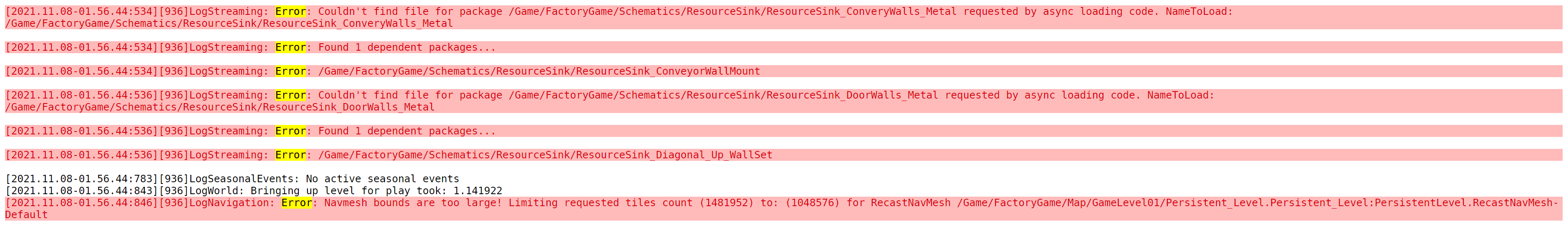

An observation when I checked the logs of the docker:  (Attached the full logs, but also a picture of a snippet I'm concerned about).   I guess it's looking for files that aren't there?  When I use Krusader to browse to the folders it refers to, they don't seem to exist.

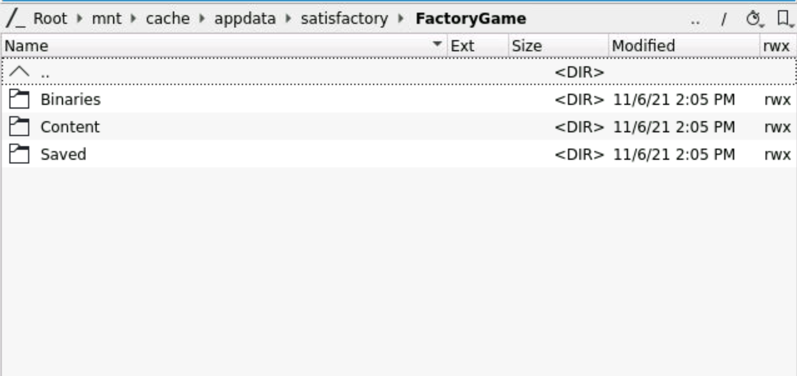

I'm attaching the screen shot of the errors and my directory showing the folders seems to be missing.

Missing the following, according to the errors:
/Game/FactoryGame/Schematics/ResourceSink/ResourceSink_ConveryWalls_Metal
Game/FactoryGame/Schematics/ResourceSink/ResourceSink_DoorWalls_Metal
Why aren't these here?  Is this because something is crashing before these can be created the first time the server runs?
[UNSURE...BUT MAYBE AN ISSUE?]
Also, I am not sure what this means by "Found 1 dependent packages".  Meaning, it found packages which were depending on These ConveryWalls and Doowalls resources but can't find them?  Kind of hard to understand based on what's written there.
[HONESTLY NO IDEA]
"Navmesh bounds are too large" error.  No clue.
This is just normal and can be ignored, the dedicated server doesn't need that files and the developers removed them to save space so the users don't have to download the whole game.
This can be also safely ignored, as said above this game is in pretty early alpha and not every error message is actually an error.
