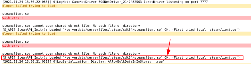

Trying to run a satisfactory server, and keep getting:
steamclient.so
with error:
steamclient.so: cannot open shared object file: No such file or directory
[S_API] SteamAPI_Init(): Loaded '/serverdata/serverfiles/.steam/sdk64/steamclient.so' OK. (First tried local 'steamclient.so')
dlopen failed trying to load:
Have tried force updating, setting verify to true, even chmodded all steamcmd and satisfactory files to 777.
the server seems to be "up" but when I connect to it, it bumps me out and spits out something like:
Name: IpConnection_2147478390, Driver: IpNetDriver_2147478407 IpNetDriver_2147478407, IsServer: YES, PC: NULL, Owner: NULL, UniqueId: INVALID
Any thoughts?
Please read the full log, it is actually loaded a little below (please always post the full log output, this makes troubleshooting much easier).

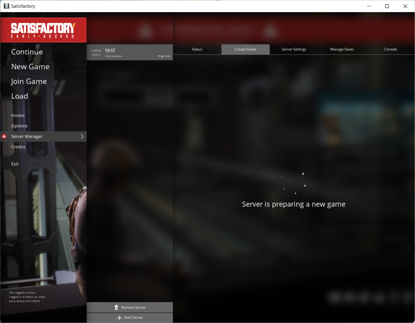

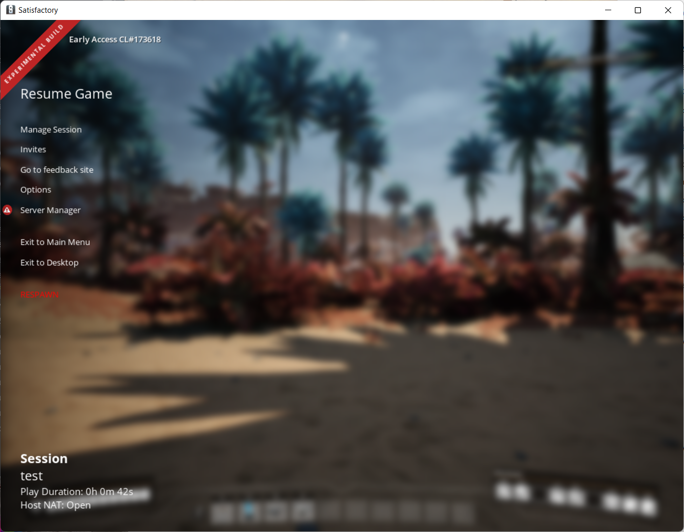

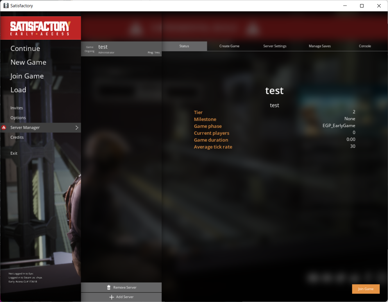

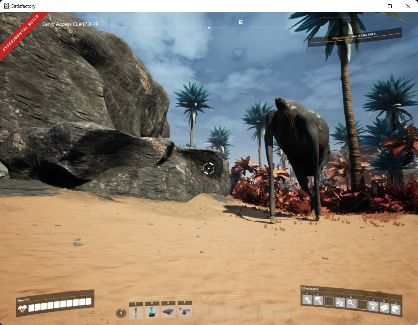

but I'll turn it off for now and wait for you to investigate.
Everything is working fine after:
  1. Enter the server IP
  2. Creating a Game
  3. Join the Game
Attached a few screenshots, as you also can see I'm on the latest Experimental build from Satisfactorio:

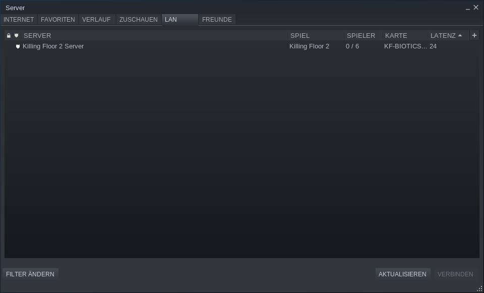

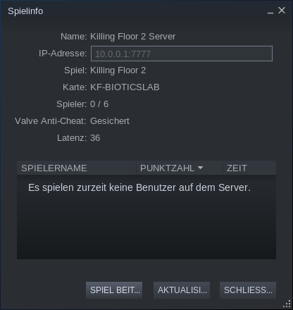

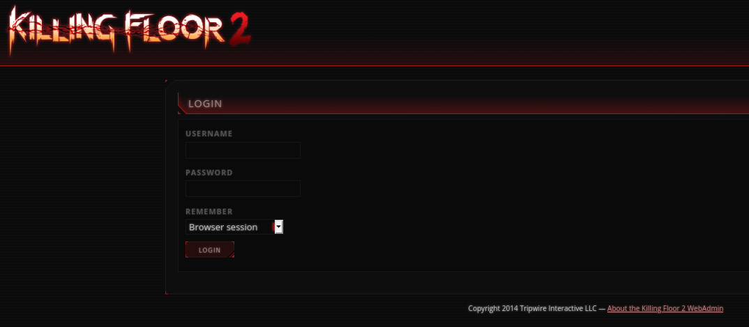

anyone have lucky getting a KillingFloor2 server up? I have a valheim server running fine. Switched some ports around to differ from valheim, deleted a reinstalled the docker for KF2 multiple times. I have done both br0 and host network settings. I can not hit the webadmin page for it no matter what i do. I leave all settings default with only changing the network settings and still nothing. need help!
I would recommend that you leave the template as it is without switching to br0 or host (because then the port mappings actually don't work) and only delete and create ports for the ones that you need to switch around, in this case also don't forget to switch the ports also in the configs otherwise it can't work.
Because you have to enable it first like it is described here: Click
You don't need to download the files like it is described in this tutorial, simply stop the container, edit the files and then start it back up.
What I've found is that the file "" is actually named "LinuxServer-KFGame.ini".
After you did that you should be greeted with:
I actually installed the container to test this, here are also two screenshots where you can see the server is running and reachable through the Steam Server Browser:
