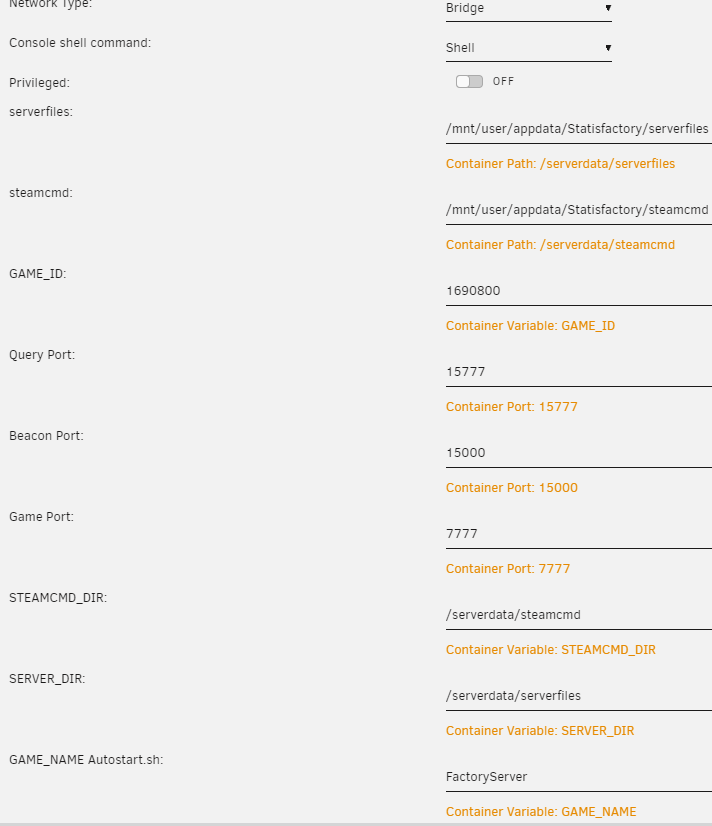

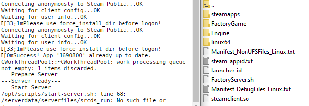

The Statisfactory Servers are released and im trying to get it running with the Generic SteamCMD Docker.
Has anybody an idea how to point the serverstarting script to the FactoryServer.SH?
"/opt/scripts/start-server.sh: line 68: /serverdata/serverfiles/srcds_run: No such file or directory"
In my case its called "FactoryServer.sh"
I tryed setting the GAME_NAME Value of the Docker to "Statisfactory" and "FactoryServer" without success
PS.: i also get the weird Force_Install informations but i already assumed to ignore them

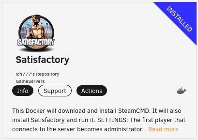

There is already a template in the CA App for Satisfactory:
Or what do you mean exactly?
Sorry im blind. i didnt see that. Thank you for your amzing work :)
