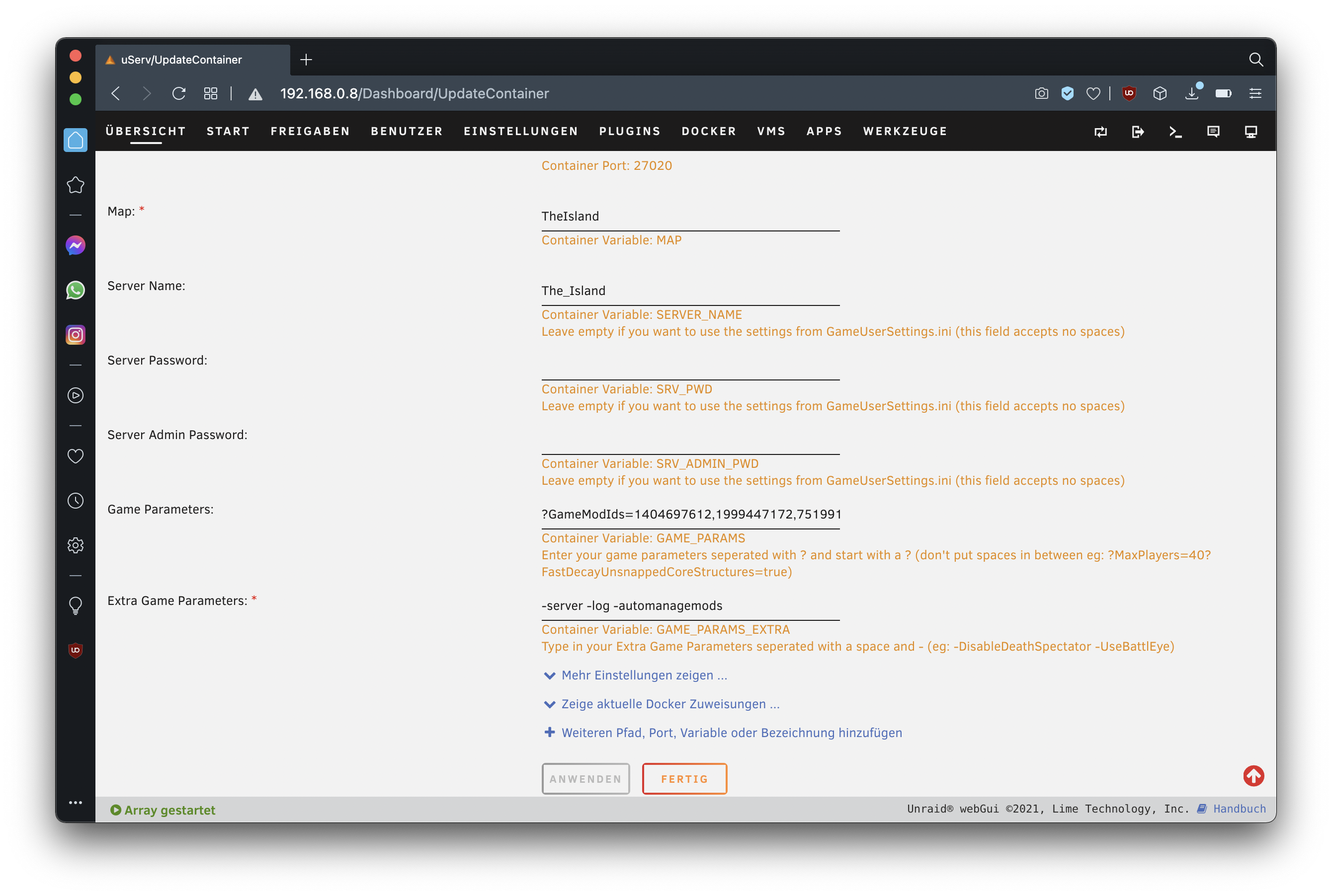

Thanks a lot of this work... I'm happy with my Ark-Server on my Unraid-Server, but one problem:
The changes to the gameusersettings.ini won't recognize by the server... Is there an option to change that? Or otherwise, where are the settings.ini stored, so i can change these?

Validation is off... I mean the settings for the server settings... This what in the template can change, but I've got a ini i want to use, because I have many changes to the engine, game and gameusersettings.ini.
By hosted servers, i can change these files, and the server will use it after a restart.

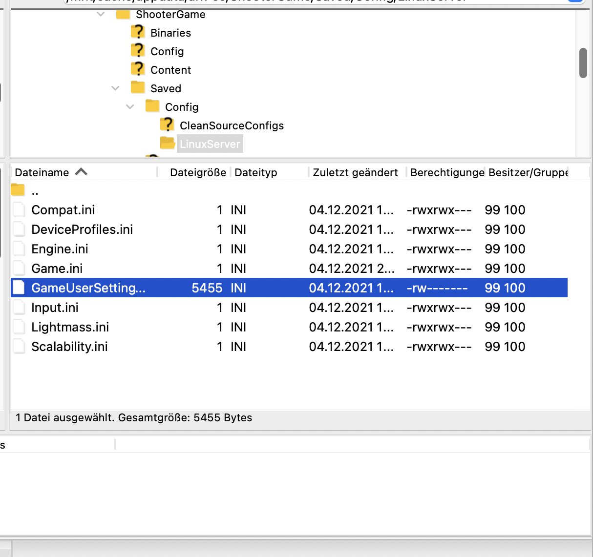

Yes... The docker is stopped... The changes in the template are recognized, but I don't find the file, where changes from the template are made off. The normal ini's are not touched... Like the server uses the dynamicconfig. But I don't made changes to use the dynamicconfig.
Like in the screenshots, the gameusersettings.ini with 5 MB is not recognize by the server.671499079_Bildschirmfoto2021-12-05um12_20_49.thumb.png.88d6a2fac26e294f9f8f8fc951d4a21c.png2047564156_Bildschirmfoto2021-12-05um12_30_31.thumb.png.cb317f4298e2dd809ac05aa86b4a4b22.png
Have you copied over the file or did you edit it, seems to me that you've copied it over or am I wrong?
I would always recommend to edit the file, or at least past in the changes.
Are you sure that this file contains no error, 5MB seems a lot to me...
Was file running on a Windows server before or on Linux?
As said the files should work fine if you change anything.
