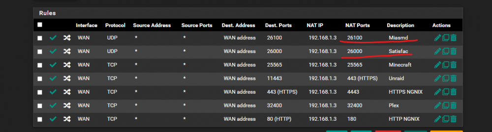

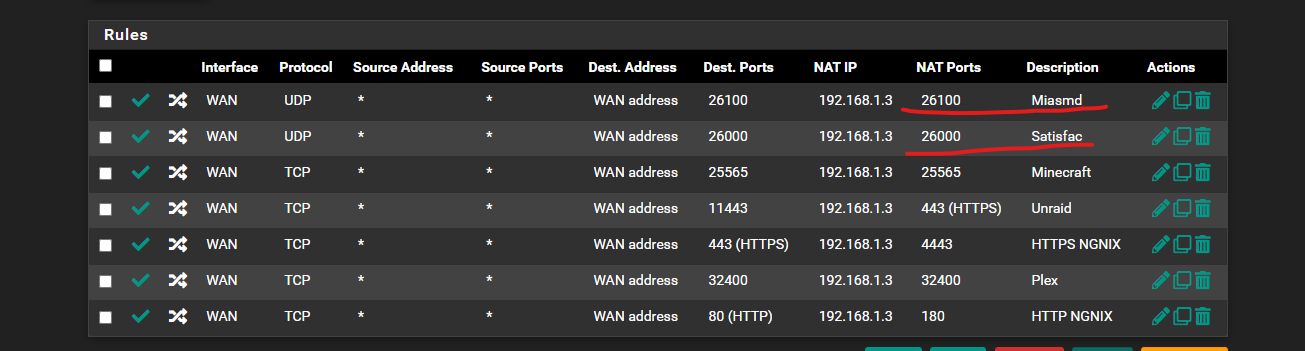

Hi i have just stated running the satisfactory server, my server is running on my unraid on the ip 192.168.1.3
i have tried forwarding the ip's, and no sucess, i even tried changing them around, and still no dice.
when just tried forwarding a minecraft port, and that does work, my plex and other port forwards works. just not this game.
anybody else run into this issue? image.thumb.png.4af9d8f792926dbd7a416ed114b1a663.pngimage.thumb.png.218fa860556d66fc55b2b1bbabbc0abf.png

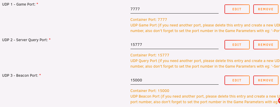

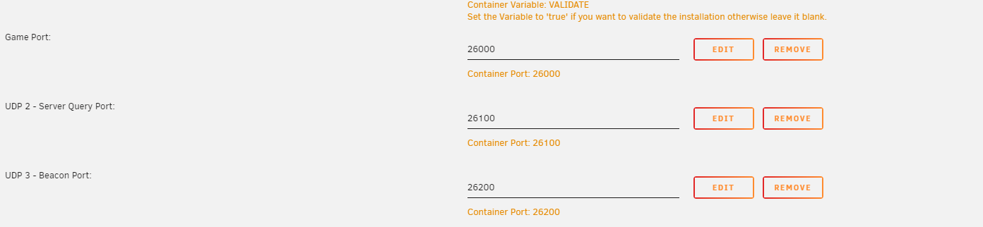

From what I see these are custom ports or am I wrong?
Usually the ports look like this:
Have you also configured the ports in the config to match your ports that you've specified in the template?
I would recommend to stick to the default ports and only change them if really needed.
