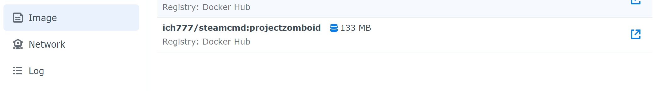

@ich777 Thank you so much for the quick reply!
I am not running unRAID. I am downloading the docker container through the Synology NAS Docker app.
Something really odd seems to be happening : I can download the container with the "projectzombaid" tag but once I run the container my NAS is unresponsive and crashes. (I have to reboot manually for it to respond again and be able to connect to the interface). I'm not to sure why. I will try to download the latest tag and run it see if it works.

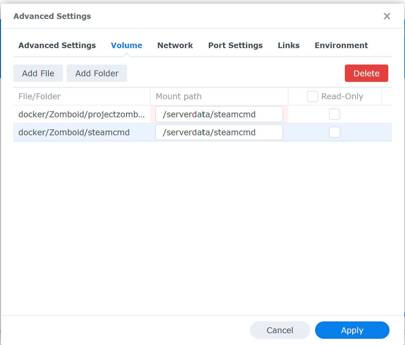

I've made a bit of progress. I managed to run the docker container on my Synology NAS (DS920+). I'm having a few issues with the following:
When setting up the Env Params :
GAME_ID must be set to 380870 based on SteamDB(https://steamdb.info/app/380870/) information, but on the list you provide (https://developer.valvesoftware.com/wiki/Dedicated_Servers_List) it is 108600. I'm a bit confused. I've used 380870 for now. It also say's "Game Purchase Required" and "Anonymous login" is no so I have to use my steam credentials is that right? (See fig. pz-list.jpg)
GAME_NAME: I can't seem to find anything regarding that for Project zomboid dedicated server. Does it need to be specified?
When creating the volumes :
In your run example is shows
--volume /path/to/steamcmd:/serverdata/steamcmd \
--volume /path/to/projectzomboid:/serverdata/steamcmd \
Shouldn't the second volume link to /serverdata/serverfiles instead of /serverdata/steamcmd?
I'm sorry for all the question and I hope I'm not too off the mark. Tbh I have no idea what I'm doing...

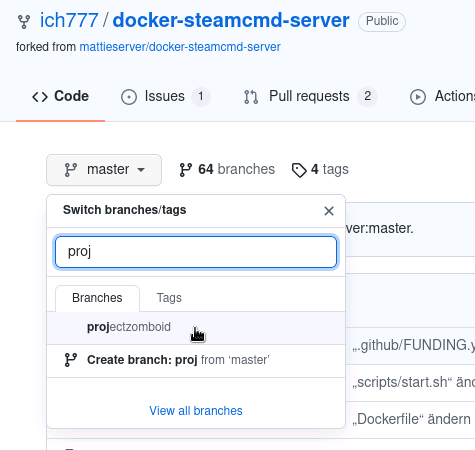

I think you are in the master branch on Github or on DockerHub (these are only examples).
Please head over to Github and click on the branches like this and switch over to the projectzomboid branch:
Here is also the direct link to the Github "projectzomboid" branch: Click

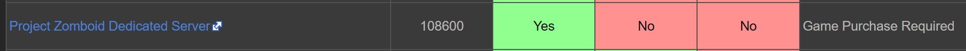

5 minutes ago, ich777 said:
Where did you get this?
From this list https://developer.valvesoftware.com/wiki/Dedicated_Servers_List but it seems it is an error, it is the id of the game and not the dedicated server https://steamdb.info/app/108600/.
I'm definitely on the right branch "ich777/steamcmd:projectzomboid".
108600 is the GAME ID from the game itself: Click
380870 is the GAME ID from the dedicated server: Click
The thing is I think the docker interface on synology NAS is very different from doing it on a normal set up. I have to set the volumes like this
Please read it again, don't use the same path, the steamcmd path is only for SteamCMD and the projectzomboid path is only for the dedicated server files:
With a dedicated path to SteamCMD you can point multiple containers who are using SteamCMD to this folder while having only one instance on the host for multiple containers, on your setup I would do it something like this:
File/Folder          Mount Path
docker/steamcmd      /serverdata/steamcmd
docker/zomboid       /serverdata/serverfiles

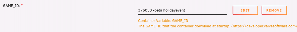

32 minutes ago, brainbudt said:
When I set the validate to true and restart it. It will keep in Version 340.3. Even after a few restarts it keeps on the same version.
See this comment: Click (keep in mind this is a post from 2017 but I think this should work)
Please append this to the GAME_ID: '-beta holidayevent' (without quotes)
(keep in mind you have to set the validate option to 'true' once so that it actually pulls the beta branch, don't forget to turn off validate after it pulled the update otherwise game starts will be much longer for ARK)
