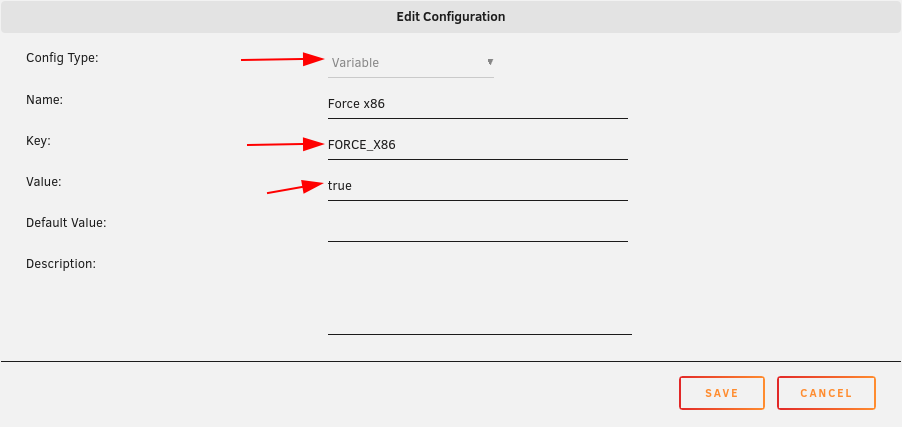

On 2/28/2022 at 11:03 PM, ich777 said:
I have now updated the container, please do a image.png.abf17aeac19b4ca80f1256ae1777c757.png from it on the Docker page (with Advanced View turned on - don't forget to turn it off afterwards) and create a variable like this in the template:
This will force the container to start the x86 version from the game.
If it doesn't work afterwards then I can't help since my suspicion would be that the developers introduced a requirement from one of the last updates from the game (not the container) that your Phenom II doesn't support.
I also had a user report where Satisfactory won't work on a Phenom II because they doesn't support AVX.
THX you very much. I can connect to the server now.

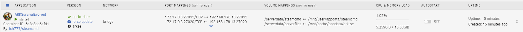

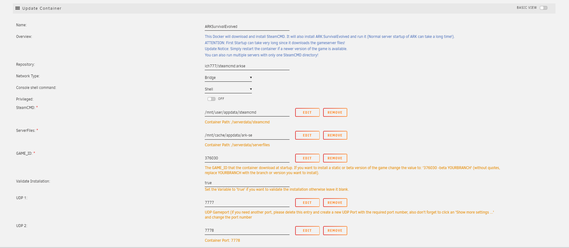

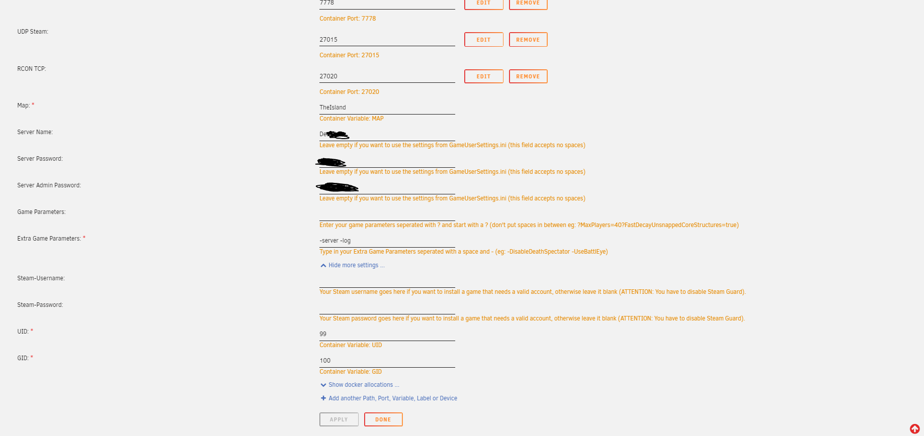

Hi, I tried setting up an ARKSurvivalEvolved Server for my friend for the last few hours but it doesn´t work and I don´t know at which part I fucked up.
This is my ARK Container:
and apparently the container is indeed hosting the game:
that´s at least how I interpret the ram usage.

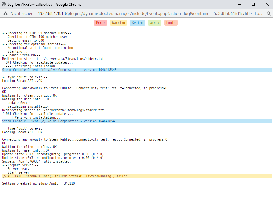

Here are the containers Logs:

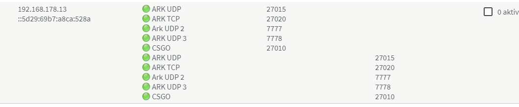

And here are my portforwarding rules in my FritzBox router.
I´m downloading CSGO right now just to check if it actually works.
Just from looking at my settings I´d think this would work, but the ARK Server does not show up in the games list of unofficial servers and even if I try to directly join it by starting a private game and then typing open 192.168.178.13 to join my own local server, it doesn´t work.
Can you please tell me where I fucked up?
Also, at first I tried leaving the passwords and server name in the docker template empty to configure it in the .ini file.
When I stoped the container, configured the .ini, started the container the settings would still be there, but as soon as I stop teh container again both passwords disapear from the .ini file.
I don't think you've made a mistake, looks everything fine to me.
Can you query it from the Steam Server browser (View -> Server Browser -> LAN)? It may be possible that you have to hit refresh a few times but it general your configuration is looking good.
Because you set it in the template and not in the .ini file.
Also keep in mind that you first stop the container before editing any file...
Another game but see the conclusion (EDIT) from this post:
Yep, everything looks fine to me too and the log does too.

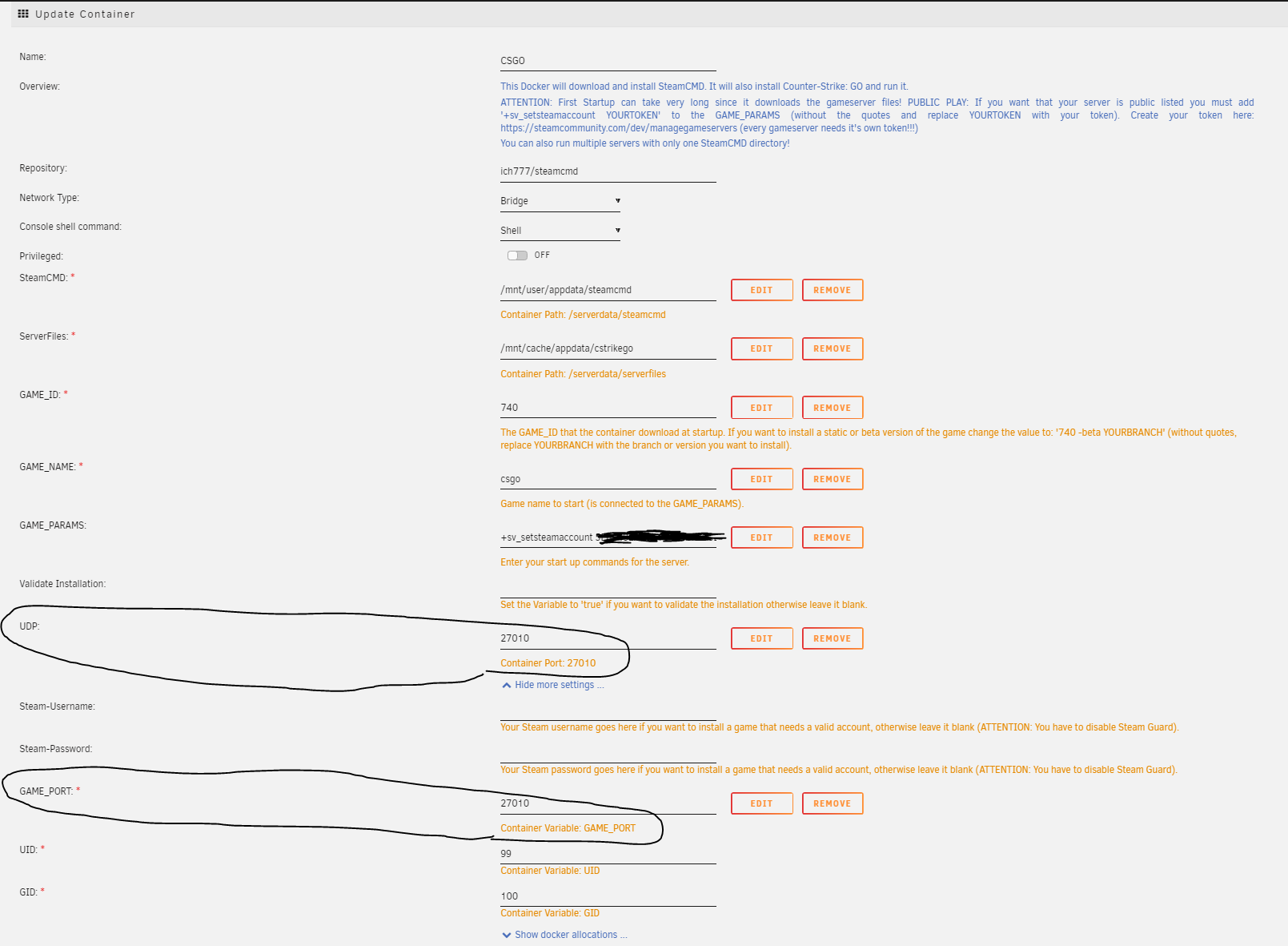

I hope you have already seen this tutorial on how to do it, also in the FAQ is how do you change ports (please follow this tutorial step by step):
https://unraid.net/blog/csgo
I saw also that you changed the port for CSGO, if you just changed it in the template to another port this won't work (please read the FAQ from the linked tutorial).
Please keep in mind that ARK is a very specific game and you need to set every checkbox exactly right to actually see it in the In-Game Server list.
But the container runs just fine on your system and is waiting for players.
ATTENTION: You actually don't need to forward the port 27020 is only RCON and this is rarely used and I really don't recommend to use it over the Internet because RCON is unencrypted traffic (clear text) and can be read by anyone.

Apparently my mistake was not having crossplay enabled. I wanted to do that after making sure it works, but apparently starting the game form the epic launcher already counts as a different platform, didn´t expect that...

First I had the fields empty in the template and only configured the ini file.
I only started using the template for name and passwords after the passwords in the ini had been reset multiple times after stopping the container.
I actually read that comment earlier and I did try it as you mentioned, stop container, edit file, have the template be empty, start container. But the next time I stop it passwords are both gone while the name is still there.
The CSGO Server is apparently kinda working fine, I can connect to it using the local IP and my ddns with the port specified behind the IP.
The only thing that´s kinda throwing me off is that it does not appear in Steams Server Tab.
In Steam in "View" --> Server--> LAN as far as I know I should be able to see all my local servers for Steam Games.
Thx for the advice, I deactivated the forwarding rule for that port.
Yes, if you have to enable it because it's basically cross play, EPIC store is not Steam. ;)
Yes, because it's done in the template... This is a game specific thing.

14 minutes ago, derWinky said:
Does it not List my CSGO Server because I changed the default port or what did I do wrong here?
Have you changed it like in the tutorial or did you just change the port in the template?
Also please note that valid Steam ports between 27015 and 27030 since you've choosen 27010 IIRC.
I think I did everything correctly
Yep, but as said, the default Steam port range is 27015 up to 27030, try to change it to one of the ports in that range, for example my CS:Source server has the port 27029 and CS:Go has 27030 and they both show up fine in the LAN tab from the Steam Server Browser.

Getting this error when i start arma3
OK
Waiting for client config...OK
Waiting for user info...OK
Success! App '233780' already up to date.
---Prepare Server---
---server.cfg found...
---Start Server---
21:21:17 Could not enable linux core dumps. Error 1 -
21:21:17 SteamAPI initialization failed. Steam features won't be accessible!
Is the container restaring or is it running?
How much CPU and RAM did the container use?
On what Unraid version are you? What CPU do you have?
Looks like it just cycles through the steamapi bit and fails
Unraid 6.9.2
