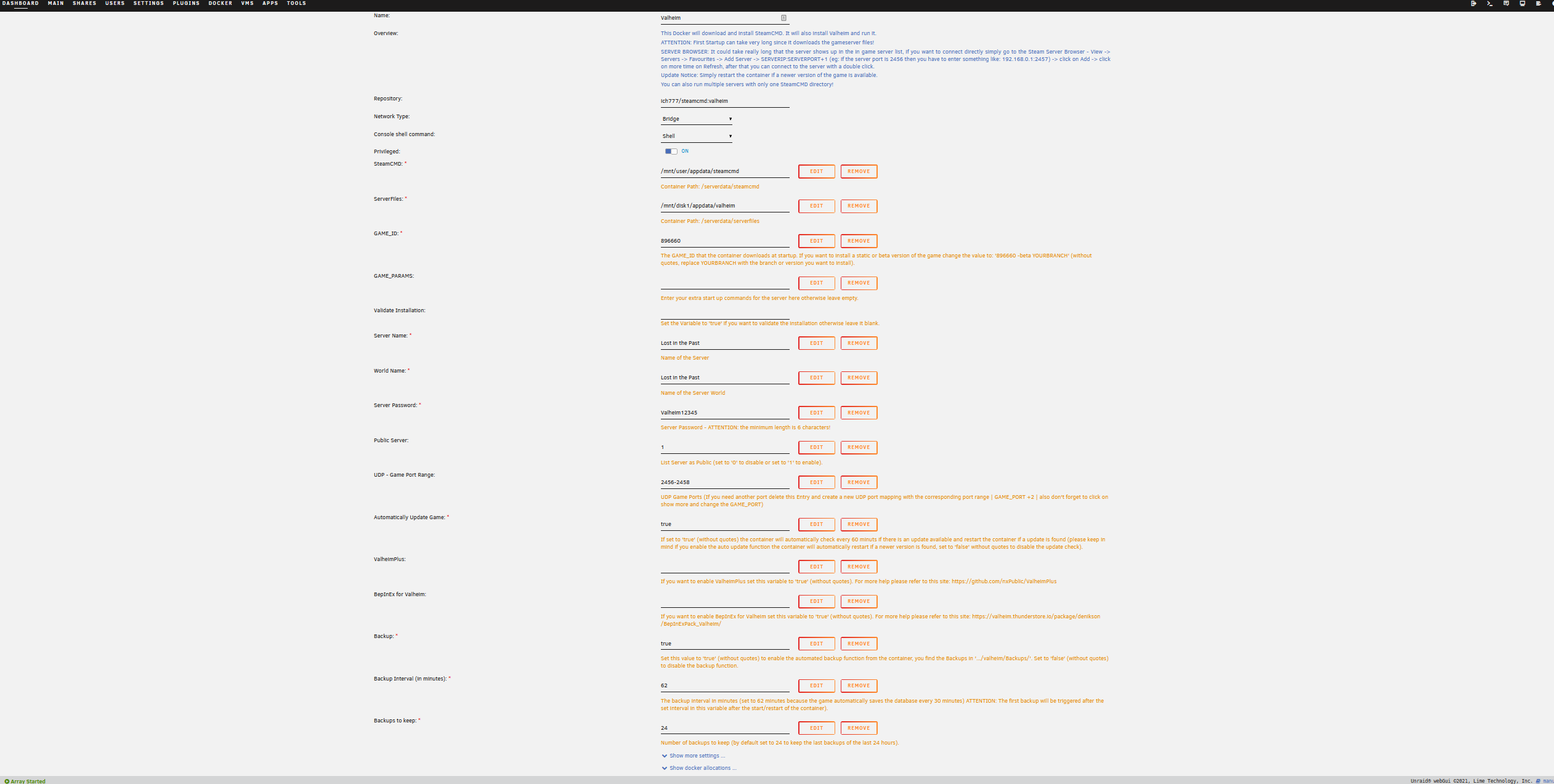

6 hours ago, deamonsatwar said:
1. cache drive?
Yes, a cache drive for Unraid? If yes, to what is the cache drive set in terms of Use Cache in the Share settings?
Can you share a screenshot from your entire Docker template?

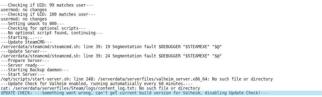

is there something wrong with the Valheim docker files? Unraid cant download those anymore?
Can you be a bit more specific please?

when i redownload Valheim it does not load any Files,  i disabled the check but still no game download.

do you believe in the possiblity that the User is mostly in fault?
i borked up my cmd files... It works again :D my bad sry for interrupting!!
So everything is working again for you?
What CMD files are you talking about?
Do you changed anything within steamcmd.sh?
image.thumb.png.01596a864dc2996a0f51608e17a51b9e.pngim actually not entirly sure about the cache drive my husband set up unraid ill have to ask him. for now heres the screenshot you asked for
Looks like you have no Cache disk installed.
Can you change the "ServerFiles" path to: /mnt/user/appdata/valheim instead of /mnt/disk1/appdata/valheim?
Maybe this will help in your case.

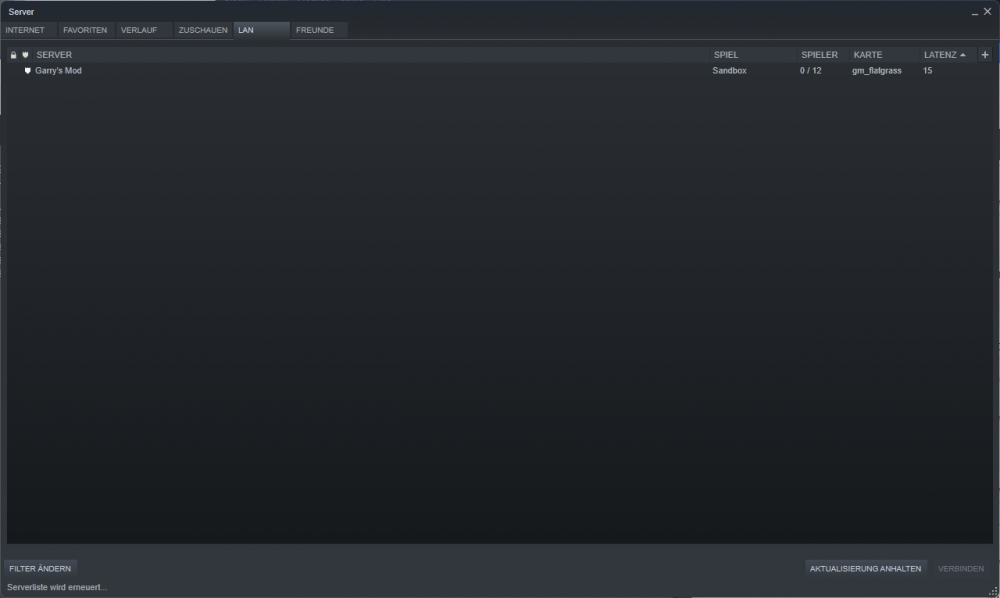

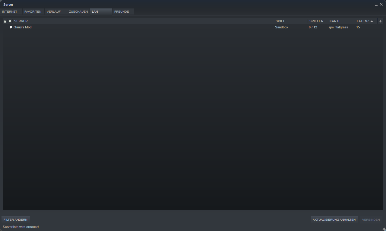

Hey, is GMod working for anyone?
The fresh install doesn't work for me. Unraid is in my local network but I can't find the server. Here is my log:

Is there anything to do before the server is working in LAN?
thx
Do you have a Cache drive installed in your Server?
Habe you changed anything in the template?
It looks like everything should work as expected, how did you try to connect to the container?
Currently not, but I have one laying around.
I've tried various changes, but also without.
I tried to find the server in the LAN server list but also tried to connect via IP:port
What changes? Have done anything to the port?
To what is the Game File path set?
Are the game files split across multiple disks?
I didn't touch the ports (27015) or the paths. Should I?
I tried validate installation and different game parameters.
SteamCMD: /mnt/user/appdata/steamcmd
ServerFiles: /mnt/disk1/appdata/garrysmod
I only have one disk and a paraty drive
No, of course not!
I now tried it now on my own and it works flawlessly:
...and here is the log: garrysmod.txt
Please keep in mind, I didn't touch a single thing in the container template and it worked right OOB.
On what Unraid version are you?
Please turn off validation, validation will cause a longer start because it validates the files on every start from the game.
I've now also pushed a update to the container, only a modernization and update thing.
(the above test was with the old version that you are running, the new container also runs fine)
Is the container on the same sub net as you local computer?
Yes
6.9.2
I will try the updated version
8 minutes ago, ra4e1 said:
6.9.2
Then it should work right OOB like it did in my case.
