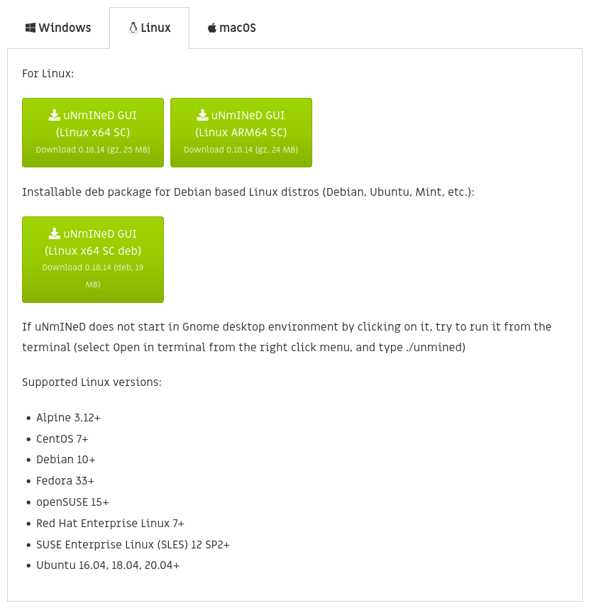

Could you look at https://unmined.net/ and see if it could be containerized? It doesn't have a nice webGUI, it's a desktop app, you point it at a minecraft world and it allows you to view the map including all the underground layers.
The license doesn't allow commercial use or distribution, so could you provide the framework and the end user can expand the tar.gz into an appdata folder?
There would be mappings for the application itself, and it would need a r/o mapping to the folder containing the minecraft world.
There are downloads for either a .deb package or a tar.gz
Sure thing, give me a few days... From what I saw from a first glance this is something like DynMap for Bukkit/Spigot right?
That should be totally doable.

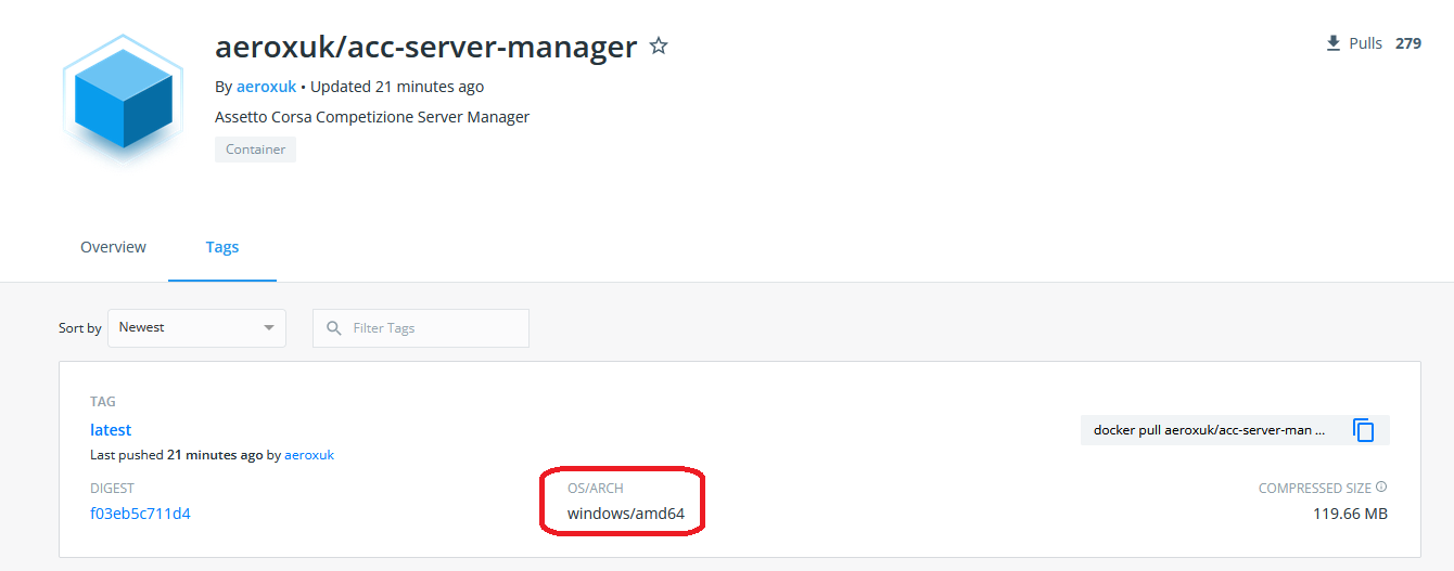

On 2/4/2022 at 5:50 PM, ich777 said:
No, first of all this is a container for Windows, I also think this is not the official one that is the same like for AssettoCorsa and also I need the Github Repository, keep in mind that I've found a few out there but none is the same as it exists for AssettoCorsa.
can you check these 2?
https://hub.docker.com/r/aeroxuk/acc-server-manager
https://discord.com/channels/557940238991753223/841323431601766442/842721564860481536
The first one is a Windows container:
(that won't work on Linux or better speaking Unraid)
I'm not that often on Discord, what is the second link?
i ask in emperor discord
second link
I don't want to maintain another template that I've don't made, sorry...
But you should be able to get it to run on Unraid...
