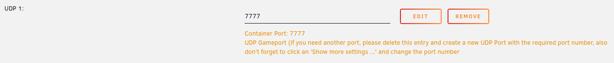

Hey Ich!! Another question. I needed to change my port in Ark so it doesnt conflict with satisfactory but now It is showing with the incorrect name in the server list and wont let me connect. I have a feeling that I'm using the wrong parameters for th edefault port.....Could you help me out? What info do you need?
image.thumb.png.cf7c3e7013aa2e36506b2dd9e7327d5d.pngIts not recognizing the 7778 port for ARKSEISLE
image.thumb.png.0227f53113d2721d46c80602ad751bb9.pngI did port forward the port range in my router
Please add a full screenshot from your Docker template.
From what I see in your screenshot you haven‘t specified a container port, have you changed the port in your game configuration file too?

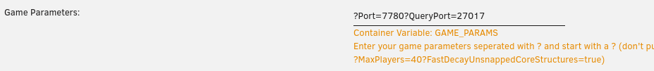

I did just find a typo in the query port under game parameters
image.thumb.png.ecad7c93a8093d3505a8b3591349d766.pngI got it looking better i think
Do you want to change the ports from AKR nor or Satisfactory?
Why do you use Host for Satisfactory?
Please tell me first what you want to do exactly and which container should have which port, please read the description again from the container, a simple change from the port won't work.
You have to change the port first in the configuration file (make sure you stop the container first), then delete the old port in the container and create a new entry with the Container and Host port the same, then start the container again.
Ok. By adding new ports and changing the container ports to what i wanted that seem to work for one of my ark servers

The reason im changing the ark ports is because I heard that Satisfactory will only accept 7777 as their first port. Not sure how true this is but anyway, If i can get the ark stuff figured out then i can add more ark servers.
I basically need ArkIsland to have a port of 7778, 7779
I need the next ark (ARKLOSTISLE) to use: 7780, 7781
Do this (this will override the config file):
in the template to change the ports (this will also change the second port to 7779) and you also have to change the query port from 27015 to 27016 (and so on) and then create the port mappings and of course delete the old ones.
The same goes for this container:
I think I got it. I'm able to have both instances running at the same time and I can connect to each of them. TY so much!!!!
