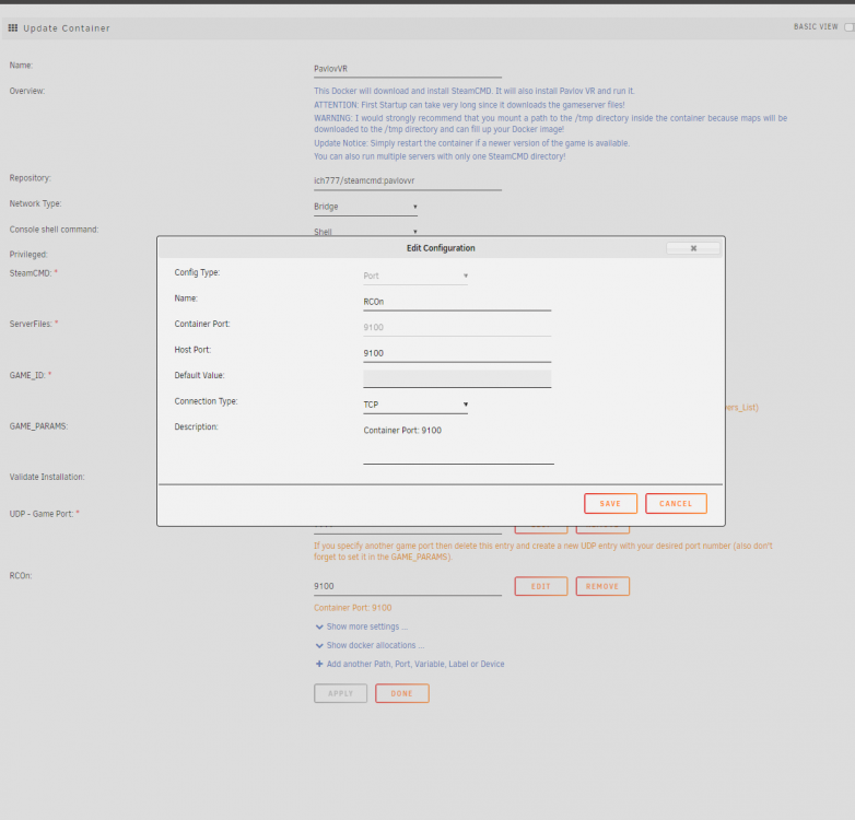

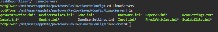

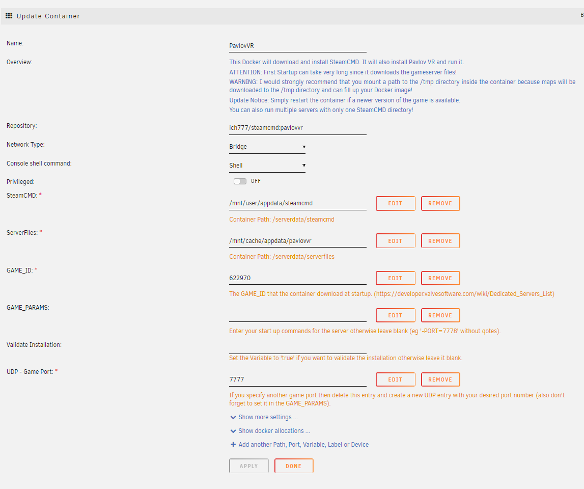

Hello thanks for the amazing docker! so I set up my server and its up n running but im having an issue connecting to Rcon
I havent changed anything from the default settings except added my own name to game.ini and added RconSettings.txt to the folder.
Hopefully you can help me out
Kind Regards
Markus
Link to comment

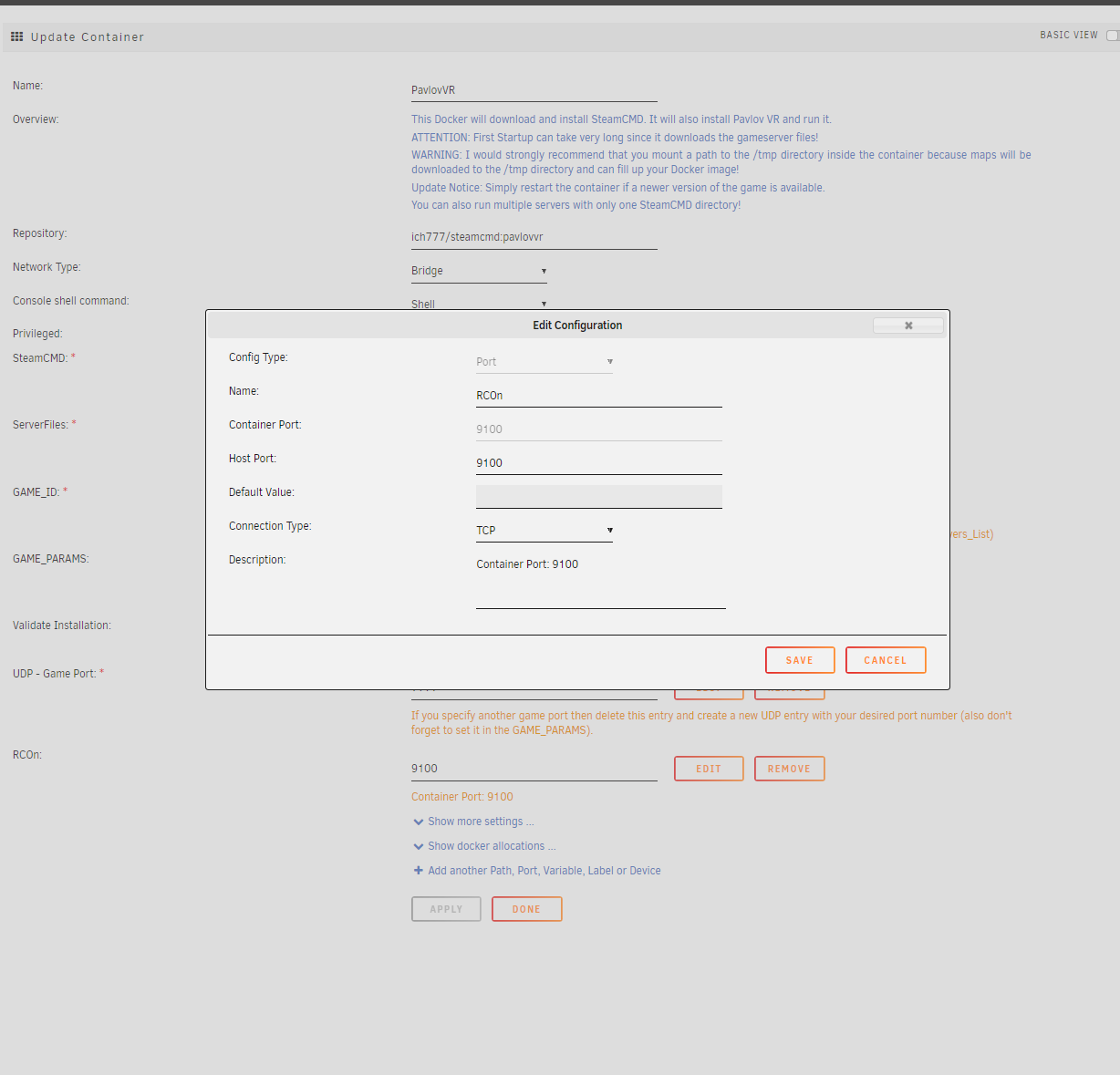

You also have to create a port mapping in the container.
Click on "Add another Path, Porta, Varaible, Label or Device" from the drop down select "Port" at container and host port enter your RCON port that you've set (in your case I think it's "9100") & make sure that it's the protocol is set to TCP, click on "Add" and "Apply".
Otherwise the port can't be reached.
Link to comment
Added the port as specified but still cant connect
Using rcon -H 172.17.0.4 -p 9100 -P 123123
failed to connecto to the given host/service
Link to comment
I have now installed the container and looking at the documentation you have created the file in the wrong folder: Click
I can connect to RCON but I actually don't can't test it if everything is working because I have to set up my VR and I don't want to anymore because it's almost midnight over here.
But what I can tell is that I don't get an error message like you do.
Link to comment
Thanks for everything I figured out the correct folder, I was going based on my docker experience. Thanks for everything its working now and great work!
Kind Regards
Markus
  • Like 1
