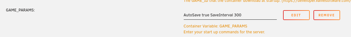

I seem to be messing up on the Stationeers Server quite a bit: I install the app from CA and start it and the last lines of the log are
[39;49m[37m[1;1H [1;1H> [1;1H [1;1H[33m16:59:47: Auto save stopped
[39;49m[37m[1;1H [1;1H> [1;1H [1;1H[33m16:59:47: Auto save started (300)
[39;49m[37m[1;1H [1;1H> [1;1H [1;1H[32mReady
which does seem alright to me.
However, I cannot connect, so I did some digging: Neither RCON nor the game itself can connect.
setting.xml contains the gameport, which is set to 27016, however in the docker there is only UDP port 27500 as the gameport. Just to test I added 27016, but neither 27500 nor 27016 nor 27015 seem to do the job, neither in LAN nor online.
Can you help me out here on what to check next?
Please read this:
If that doesn't work maybe @Marcel40625 can help...
8 minutes ago, ich777 said:
Please read this:
I have already found that, but I just used the template today and it already has the latest parameters, I double-checked that though and it is correct. So I would highly appreciate some help from @Marcel40625.
Thank you!

if you follow my hints it should work, but there is no rcon atm they removed it in the multiplayer update last month, and it might be you dont see the server in the ingame browser, try to connect via IP
Hi, I tried following your hints to the last details, it's probably me, but for the life of it I can not get it to run.
I have tried connecting via the local and external IP, I have tried 27016 and 27500 (the only discrepancy I could find in the manuals), I cannot even get it to connect, the logs show absolutely nothing.
I am sorry for being persistent here, but do you maybe have another idea on where to check?
did you changes the port mapping aswell when tried 27016?
@ich777 Dont know if you already did but now the default port of stationeers ist 27016, maybe change it in your template?
