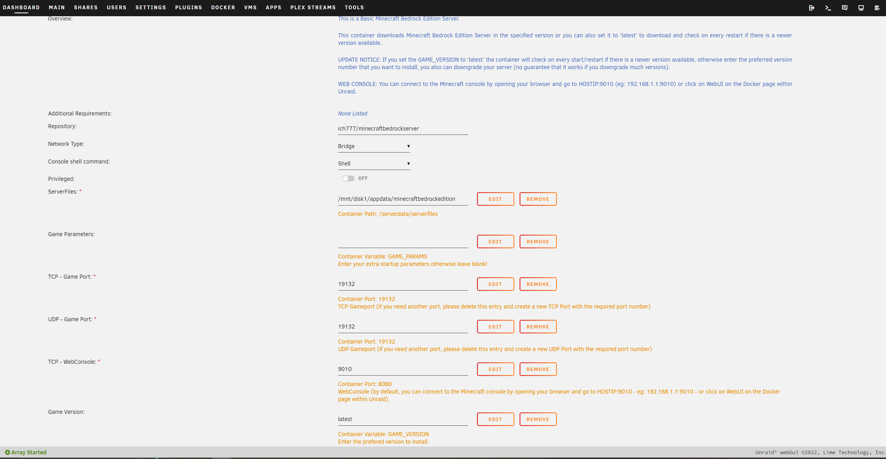

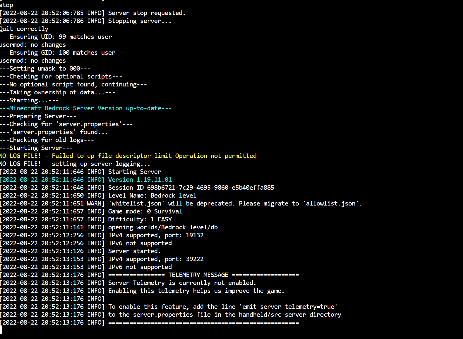

8 hours ago, unraid_countryguy said:
Is there an update, or another way to update the server for us? Thanks.
Restart the container and it should update itself as mentioned in the description from the container.
If it doesn‘t update itself please post a screenshot from your container template and also the log output.

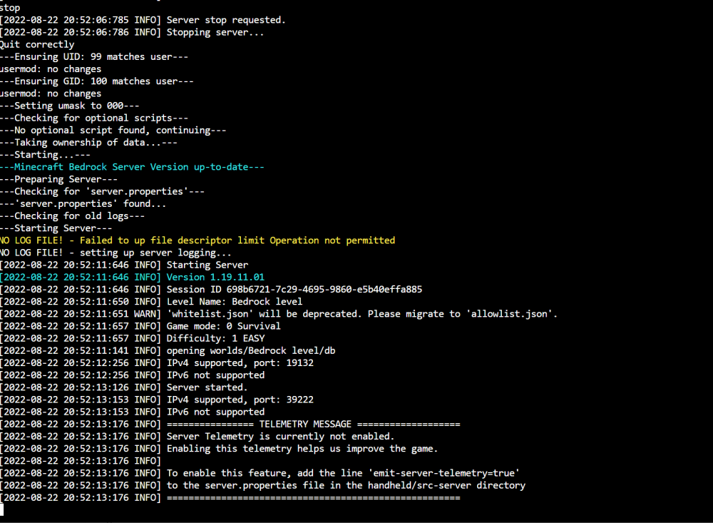

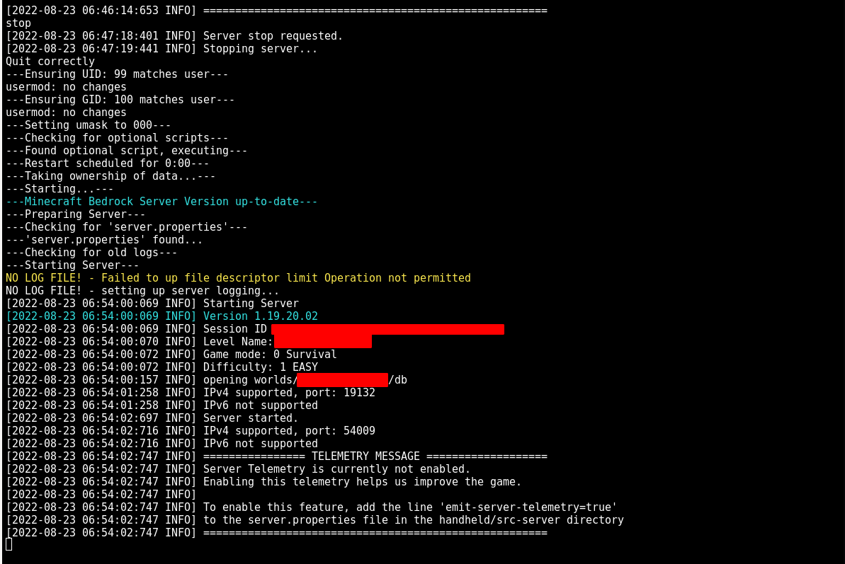

1 hour ago, unraid_countryguy said:
This is really strange since my server sits on version 1.19.20.02
Do you have any AdBlocking software somewhere on your network?
I think you can open this file from your network or am I wrong: Click
The container checks this file on every restart if there was a version change and compares that against the installed version.

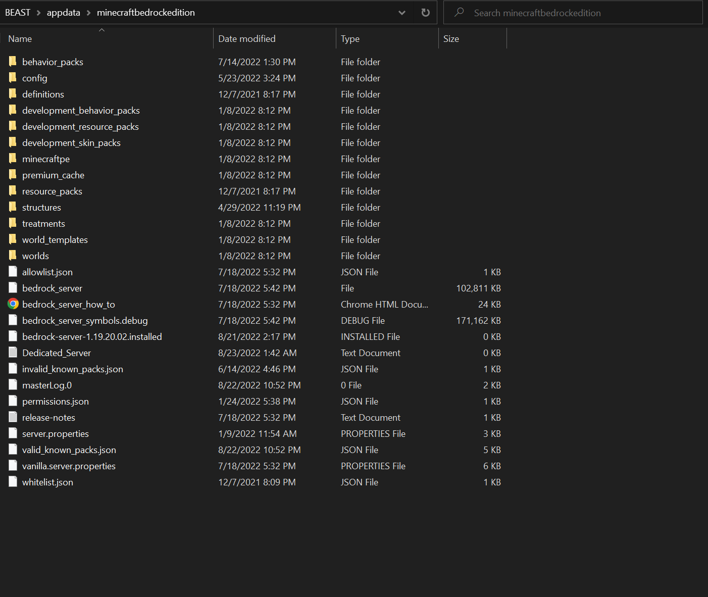

Can you also please post a screenshot from your root game directory for Minecraft Bedrock?
Here is a screenshot from my container:

Yes, I am able to access that file with no issues from a PC and a VM on the same unraid server.

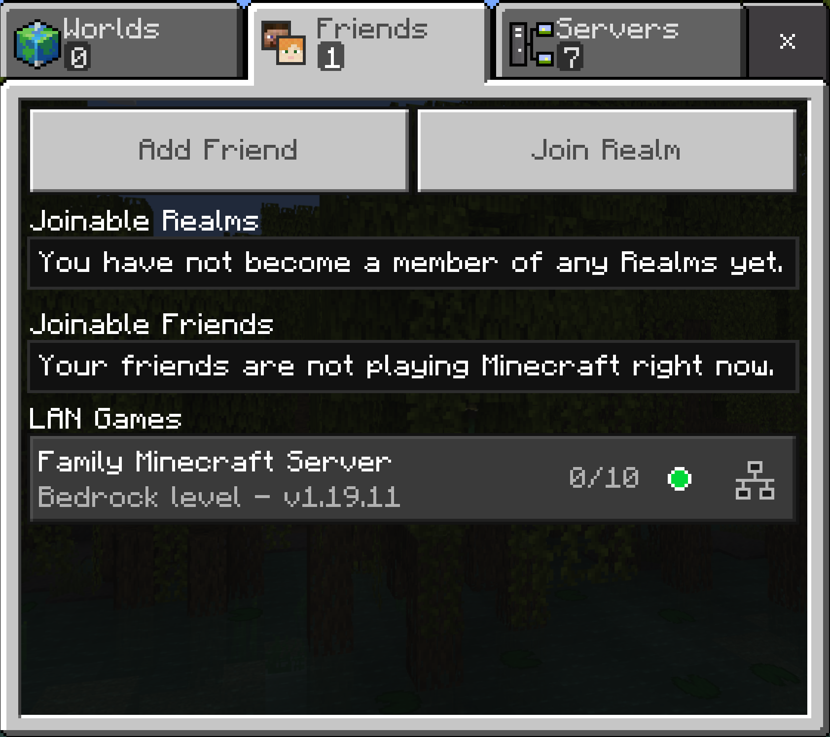

Here is the screenshot of the game directory. It's shows "bedrock-server-1.19.20.02.installed" but the game shows 1.19.11 when attempting to connect to it.
Please stop the container and rename the file to match your version and it should pull the update after you start the container again.
I really can‘t tell what is going on here…
That seems to have worked, not sure how it updated the filename but didn't actually update game. Thank you for your assistance, much appreciated.

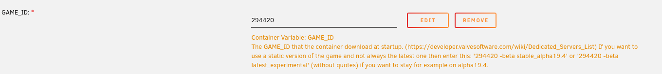

Is there any way I can roll back the 7DtD version on my server to 20.5? I've been away for a couple of weeks and when I've come back and tried to start my server up again I'm getting a message saying that I have 'Alpha 20.5' and my server has 'Alpha 20.6'  - I didn't realise it would update automatically but it appears to have done!?!?
I'm using the docker container but running Undead Legacy on it so need to keep the version as 20.5.
If possible join the Discord server from @Spectral Force here, since he helps me out with 7DtD, and yes it's possible to stay on a specific version.
This should also help:
I'm having trouble getting things installed with this docker. I am trying to install the Valheim docker, or any other game using  steamcmd for that matter, and the docker just restarts over and over again. Nothing shows up in the folder locations I've defined. I've followed steps on a couple of other websites and it seems so simple but it is really escaping me what I'm doing wrong. Could it be a permissions problem? Am I supposed to install steamcmd separately? Help!
Thanks for the reply - I did see the part you are referring to in the container settings - I've tried putting the GAME_ID to '294420 -beta stable_alpha20.5' and while it then tells me it's complete, when I'm trying to join the server it's still telling me that the server is on v20.6??
I think you have to turn on validation in the template, but please turn it off again after it downgraded the files since otherwise it would validate the files on each container start...
For further question please reach out to @Spectral Force on his Discord, he can surely help. :)
