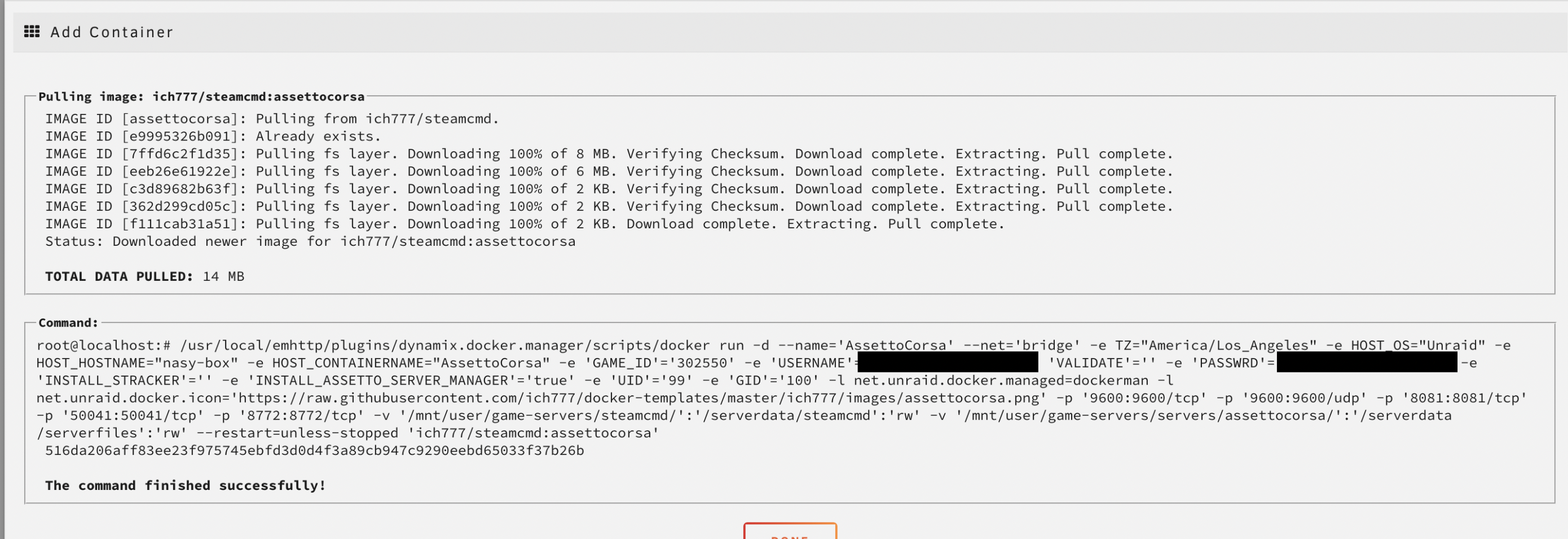

Hi all, excited and new to Unraid, still got a trial going but I think I am ready to commit soon. Have been pulling my hair out wondering what I may be doing wrong with this one though. For starters, I have made a new Steam account without Steam Guard to spin up an AssettoCorsa game server. I have included the command as an attachment.
108463712_ScreenShot2022-11-22at12_07_00AM.thumb.png.f16637c27f68700f636fa66e44664563.png
I tried the default install share locations in appdata and that seemed to not make it happy either.
It is able to download the server manager but it seems the issue lies with SteamCMD properly installing. I have consistently tried and the logs show it will download and just become stuck at 1% consistently every time.
On what Unraid version are you?
It seems that something is wrong with your Internet connection since I can start the server fine with and without the ServerManager, do you have any AdBlocking somewhere on your network?
I've attached the log from my server: AssettoCorsa.log AssettoCorsa-ServerManager.log

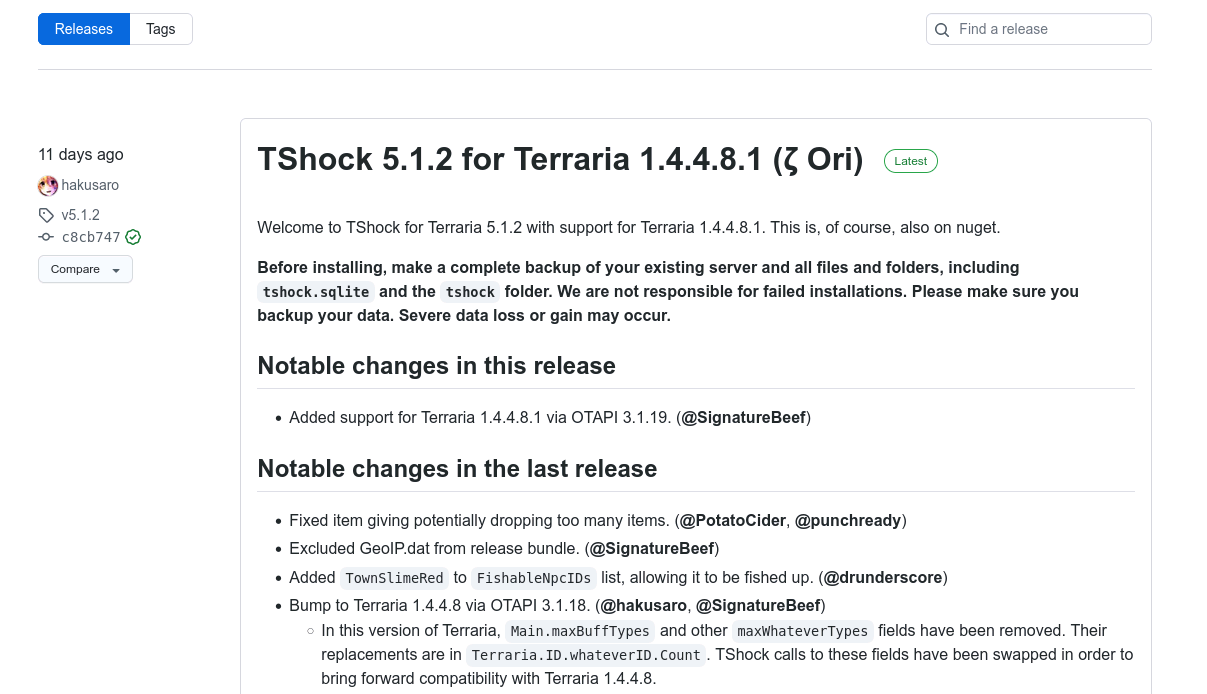

I meant that the Terraria-Tshock docker is not properly downloading Terraria version 1.4.4.9.
Yes, because the latest version from Terraria TShock is 1.4.4.8.1 on GitHub over here: https://github.com/Pryaxis/TShock/releases
There is no newer version available over on the Terraria TShock GitHub to download for the container just yet.
I see. I understand the issue is an update on their end now. Thanks again for the help! I appreciate it immensely.
I am on Unraid Version: 6.10.3. Had troubles formatting drives with the most recent versions and this was the most stable I could download.
I do not have active AdBlocking on my network, my PiHole (which my Unraid does not point to) is even disabled at this time. I am able to process other network functions on my Unraid node in different Docker apps like downloading ISOs, streaming my home media externally, and more. I was able to ping Steam through the AC console as well.
This was due to a bug in 6.10.3 and is fixed now.
Yes, but that doesn‘t mean there is something else wrong with you network.
As you can see from my logs above everything is just working fine.
I would really recommend that you upgrade to 6.11.5, delete the container and the assettocorsa folder in your appdata directory and pull a fresh copy from the CA App and see if that helps.
