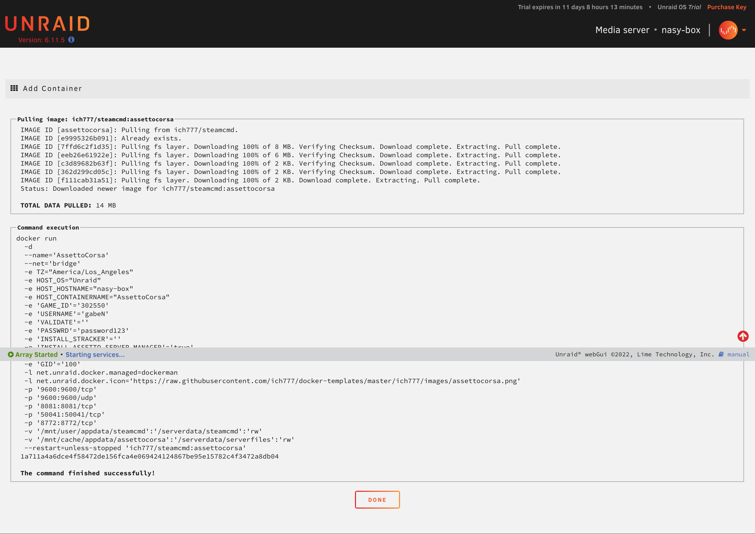

I updated Unraid to 6.11.5, I removed the containers and folders and tried again. Unfortunately no changes.
I did a retry of those steps after I added extra DNS servers to my config (1.1.1.1 and 8.8.8.8) because it seems some people had DNS issues from other googling. I even made a new Steam account just in case.
It seems to download these files to SteamCMD then complain that SteamCMD isn't installed correctly. I reviewed your logs and it shows it connects to the Steam API properly to login to the account. Mine never reaches that initial stage. It tries "updating"/downloading and fails there. Does anyone have any network troubleshooting suggestions?

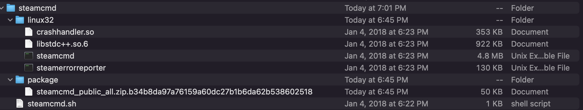

Have you removed the container/folders and everything related to the container and start over by pulling a fresh copy from the CA App?
To what is your appdata share set in terms of Use Cache? Can you also post a screenshot from the template?
I tried it now once again with SteamCMD removed/AssettoCorsa Server Manager enabled and have no issue whatsoever: AssettoCorsa-ServerManager.log
I can only thing of a weird network or disk issue...

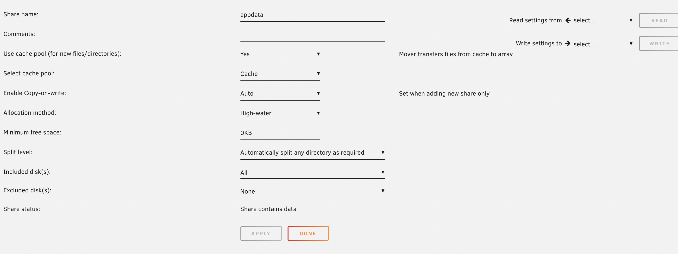

Please set the appdata share to Only or even better to Prefer, with that you make sure that the data stays on the cache drive and is not moved to the Array, that's actually maybe the issue in your case...

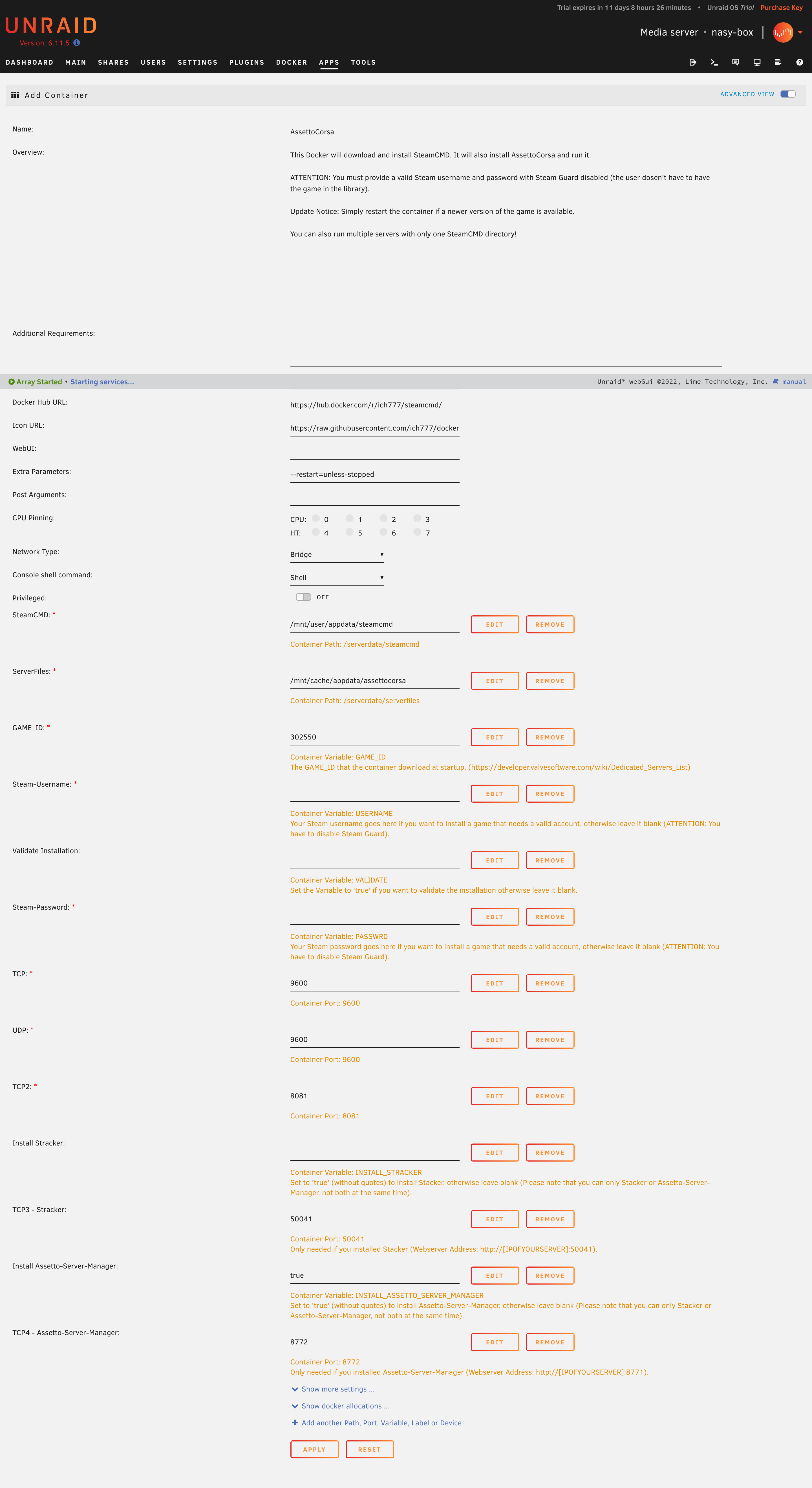

Can you also post a screenshot from your Docker template?
I set my appdata share to Prefer and tried a run with setting it to only. Both exhibit the same behavior.

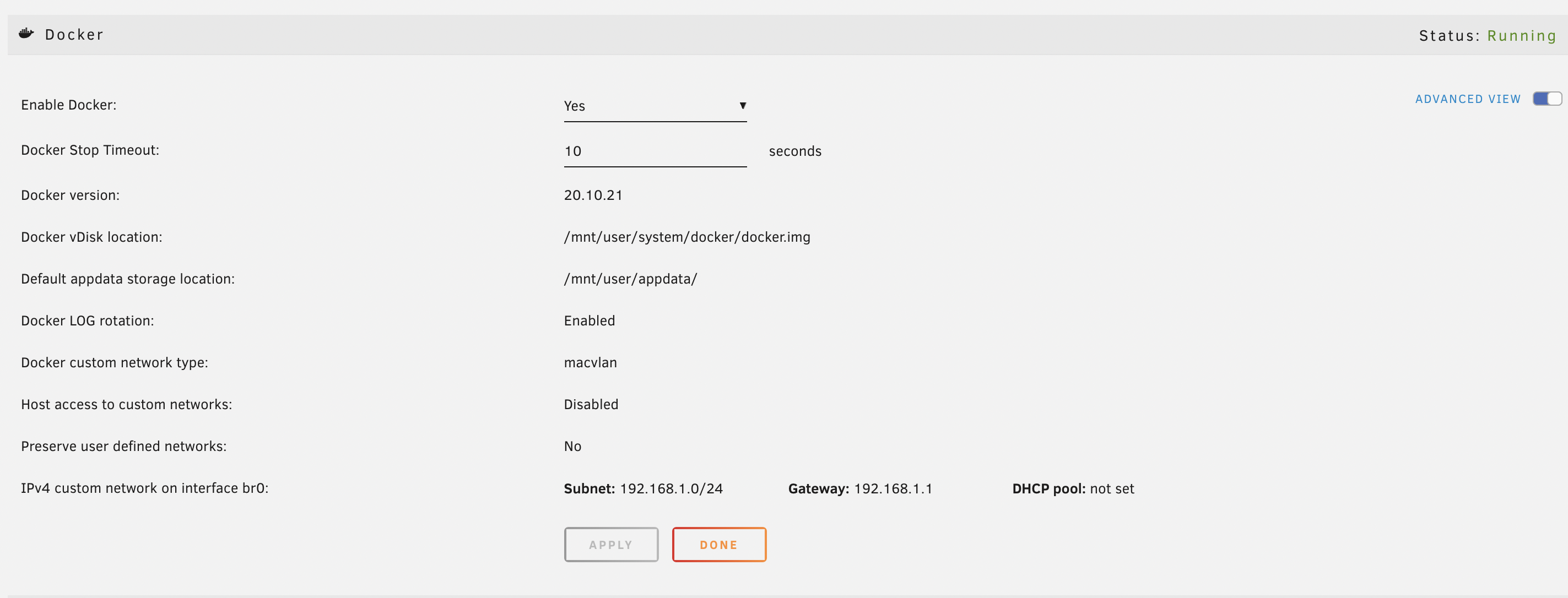

Here is my Docker settings page
1940726038_ScreenShot2022-11-23at1_58_56PM.thumb.png.e1149fa51affc7f4511b1585626c664d.png

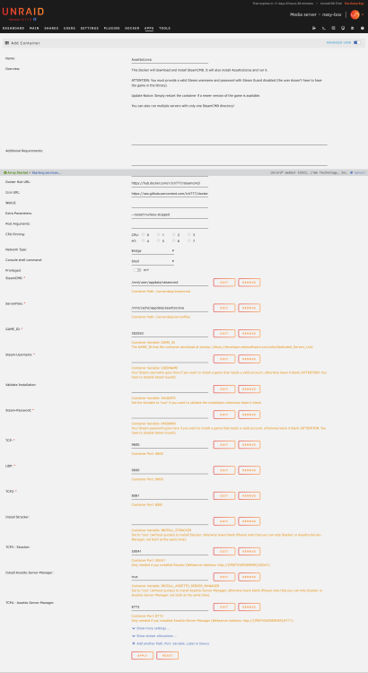

And here is my Assetto template. Is this the docker template you're asking for?
On a retry run, I think this is the furthest I've seen the "download" go. I'll kick off some WireShark and see if I can spot anything out of the ordinary. Network wise, the server has worked perfectly in all other applications.

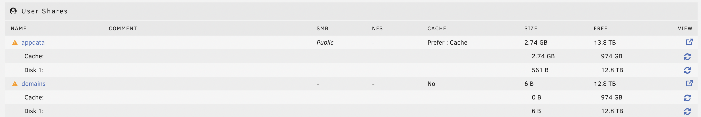

Making that change by itself won't actually move anything. Mover would have to run to get it moved, and nothing can move open files. Disable Docker in Settings then run mover.
Go to User Shares, click Compute... for the appdata share to see how much of each disk is used by the share.
Thanks for the heads up. I ran mover in the Settings > Scheduler > Mover after disabling docker and the appdata migrated over to the cache, see:

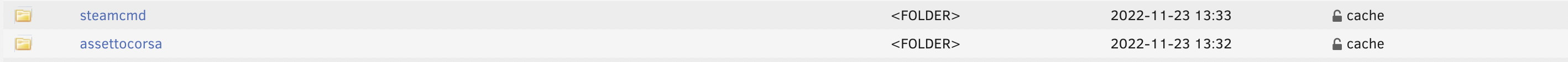

1125877516_ScreenShot2022-11-23at3_37_52PM.thumb.png.a7826db9fbabcb9169b55b7515d609ba.png
Once I did that, I retried installing the app from CA after forcefully removing rm -rf the directories (which got rid of the bothersome mod_tires.ini). They show up in the cache now, see:
1294848246_ScreenShot2022-11-23at3_34_55PM.thumb.png.10ad41048b4720f93f78bfc754092f7c.png
Still the same behavior. :(

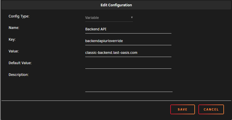

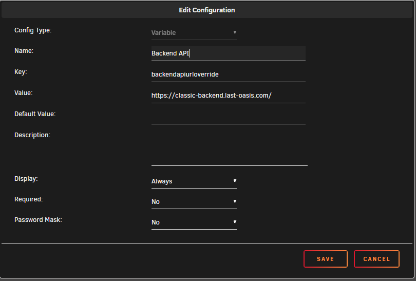

Awesome! The time zone definitely worked. It did show both, but my variable took precedence.
However, with the backendapiurloverride, that isn't the case..
That screenshot is from the log. Because that's still somehow there, it won't verify, and shuts down the server.
Did I do this correctly?
Edit: I realized in posting this that I had put the whole URL. Testing without it.
Edit 2: Yea, it doesn't even show my variable in the logfile at all.
Edited by Majesticwalker
post-test
Please read how to do it again from my post, I‘ve even put in the correct Key and Value for the Variable, just copy paste it from my post above (just copy paste it, without https://)
This variable is case sensitive and you don‘t have to append anything to your Game Params.
I had already changed it...
but in the logs, it is not capitalized... it's in all lowercase
Edit: I don't understand why putting it in all caps works?? the logfile showed the other one all lowercase
Edit2: I can't thank you enough. It looks like it's going to run smoothly. Thanks for all your time and patience <3

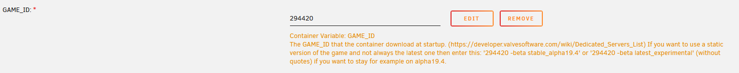

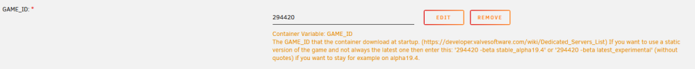

I'm running a 7days server, and I want to prevent the server files from being updated (because I'm using the Ravenhearst mod).
Is there a command in the docker configuration to prevent steamcmd from updating?
Thanks in advance for the support.
It's right in the description from the container:
I don't know on what version they currently are but if you put something like this in the GAME_ID it will stay on the specified version:
294420 -beta stable_alpha19.4

Wondering if this is still true for recent releases of Unraid?  I'm up to date with current stable 6.11.3.
Having an issue reaching ANY ports for Ark Survival container in bridge mode in spite of port forwarding them all from my router which is connected with IP passthrough on my AT&T modem.  I know it's working (port forwarding and IP Passthrough)  because my plex container in host mode is able to have 32400 port open and working on my router and is reachable from outside my network...the issue is, none of the Ark Survival ports on the container are responding.  I may just not understand how bridge mode works in this instance...
Edited by devnet
My first question would be, why are you still on 6.11.3? 6.11.5 is the most recent release.
Bridge will always work fine as long as you don't change the ports, I run all of my containers in bridge mode and many other people too and have no issues at all.
The main issue here is that those ports appear to be closed because you are testing with a external site that rely on a answer from the ports but since this is a dedicated server it won't answer to standard protocol requests since it uses a proprietary protocol, this was discussed here very often.
Have you yet tried to connect from outside your network to connect to the ARK instance (maybe hair pin NAT is not working correctly)? Have you made sure that the right port with the right protocol is forwarded (TCP/UDP)? Are you sure that your ISP isn't blocking UDP port forwarding or certain ports? Have you yet tried if you can see the server from your local network (with the local address and port) in the Steam Server Browser?
Plex works in most of the times because it is working completely different and even can work with a CG-NAT Internet connection because they can make use of a relay server.
