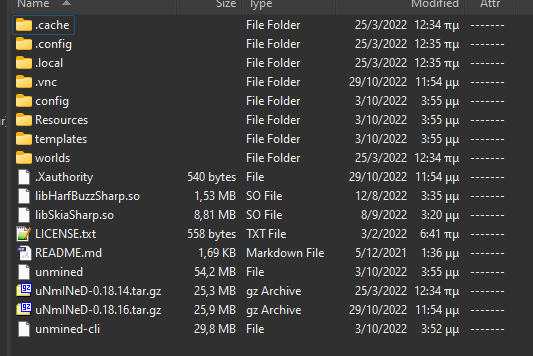

How does the folder structure look on your system?
like that
EDIT: Note that I used to use this container. It did work in the past. I didn't touch it, except possible updates.
EDIT #2: What if I manually extract 0.18.16 and drop it over the existing?
EDIT #3: I did what I say above and it worked. Wonder what will happen in next update though. "Something went wrong" is not very informative, as it seems to BE able to download .16, but doesn't extract it. Could it be a security issue?
Edited by NLS
If you read on you'll see that it says "can't download uNmINeD-GUI', so the download simply failed, nothing more but I don't know exactly why...
This shouldn't happen at all.
Will investigate that further.
EDIT: I really don't know what happened there, even if I do it like in your case it is working and updating just fine:
