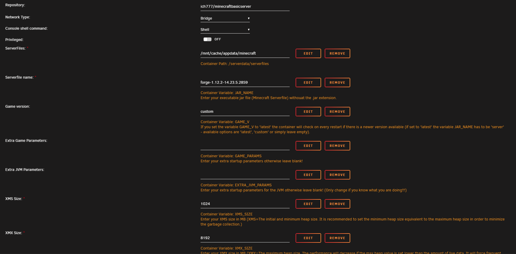

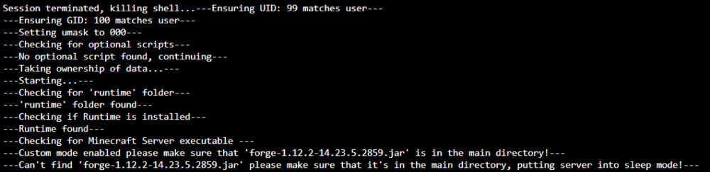

Server: Minecraft
Issue: Anything outside of "latest" server version, the Docker cannot find the Forge .jar. Using an older version of Forge which requires jre11 (which already has been setup in edit and confirmed working). Tried shortening the names of the .jar files as well, so see if that helped. Nothing I can see out of place.
(trying to run a server with Zombie survival Mod. Only thing I can find is Forge, but I'm aware that it can be picky within Docker.. so if you recommend anything outside Forge that'll support mods, I'm all ears to suggestions)

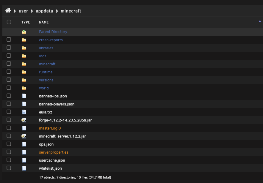

To what is your appdata directory set in terms of Use Cache in the Share settings?
Make sure that it is set to Only or Prefer. How did you copy over the .jar file? Did you copy it over to /mnt/user/... or /mnt/cache/...
That's the only thing that I can think of why it can't find the files.
However Minecraft should work if you change the path from /mnt/cache/... to /mnt/user/... in the template.
You can set the JRE version by clicking on Show More... in the template.
Cache is set to 'Prefer' on /appdata.
Attempted uploading the .jar via SMB share to the /mnt/user/appdata, as well as through GUI within Unraid to the /mnt/user/appdata share via (I think) Dynamix.
Set JRE to "jre11" appropriately as well within the RUNTIME_NAME variable. Confirmed visible/downloading via logs on bootup.
.. changing from /mnt/cache/... to /mnt/user/ may have done the trick. Logs showing it found it at least. :) I'll continue to work with it from there. Appreciate the help.

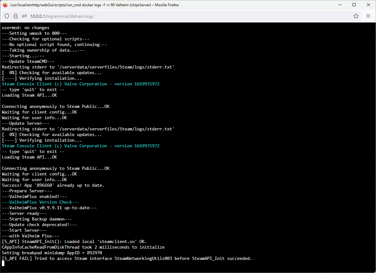

On 12/15/2022 at 11:44 PM, ich777 said:
This is really strange, it looks like that ot updated the game just fine and is on the latest version.
Can you please double check that you haven‘t enabled a beta branch on your local PC?
I ran into this issue too, and I think I've figured out what's going on... it appears that the Docker is auto-updating to a public testing branch that Valheim released on the 16th.   But in the Steam Client, you have to select that beta for your game client to update... I had to go to Properties->Betas->select "public-test" beta.   Then my steam client updated, and I was able to connect to the docker again without the "incompatible version" issue.
I don't have any real customized settings on my Valheim docker, and no game params defined... it just seems it has auto-selected that "public-test" branch and updated itself from it.   And so you must do the same on your steam client, or you'll get the version mismatch.
@ich777 any thoughts on why it might be grabbing that test build they put out on 12/16, instead of the default standard branch? I can't see anything in the logs/settings about why it might chose that over the standard build.  I am wondering if it was the way they Irongate published it to steam?
Usually the container should not auto update to a public test branch, the auto update feature is now also disabled because it only causes trouble with the latest update and has been officially deprecated from my side.
Maybe the developers messed up again, wouldn't be the first time... :D
I've never get a mismatch so far, even after updating my old container to the newest available version I'm able to connect just fine.
As said above the only real explanation to this is that the developers messed something up because the container will always pull the stable version, however if you where on the experimental branch and you want to go back to the official public version it is always recommended to change the GAME_ID to:
896660 -beta public
and turn validation in the template to 'true', after it finished updating the game you can stop the container, set the GAME_ID back to:
896660
and delete the value 'true' from validation.
Maybe that's why my container was never messed up, I never where on the experimental branch. :)
That might be, because I had been on the beta branch for a few weeks before Mistlands update became public.  Then I took the beta tags out of my docker settings, and at that time it did update to "stable" Mistland release just fine and have been playing with that for a week or two fine.   But perhaps that is what led it to take this "public test" beta they pushed out, and my local steam client didn't, which led me to finding what happened :)
Thanks for the tips, will try those later and see if it does revert the docker to the non-beta build.
You can always force the public version from the dedicated server with:
896660 -beta public
Just ignore the "-beta" part, this is just a way of forcing the branch from SteamCMD.
