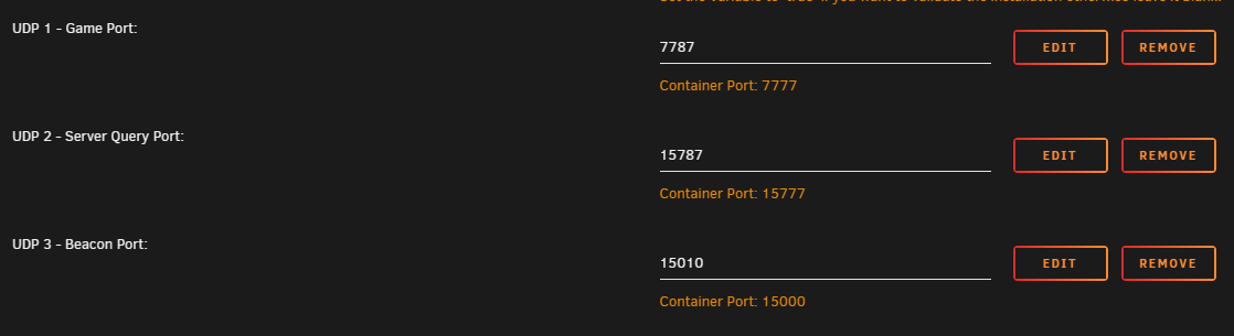

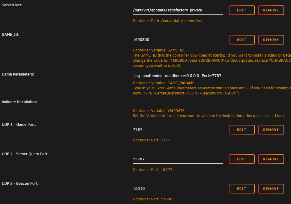

Hi! I've got a new Unraid server spun up and am hosting a Satisfactory server on it with no issue using your docker image.
I'm attempting to host a second instance of the server for a private game. I've found and followed the steps outlined in this Reddit post:
And here are my settings:
(The ones not pictured I have left as default.)
Attached is my log.
satisfactory_log.txt
The container starts, but I am unable to connect to it from my client on my gaming PC. It shows the server as offline / pending authentication. From the errors I'm assuming it hasn't actually started. I'm sure I'm missing something dumb - anyone have any advice?
Thanks!
This is for both of you:
You have to change the ports in your server config or your startup parameters.
If you have done this, also don't forget to delete the existing port mapping(s) from the container template and create new one(s) with the according port(s) that you've set in the config/start up parameters as the host and container port(s) (and also don't forget to choose the right protocol too!).
The existing ones won't work anymore because you've changed it in the config/start up parameters.
Also please don't try to attempt to change only the ports which are also exist currently in the template, that won't work for most games, you have to change them in the config/start up parameters, delete them and create new ones with container and host port set to the ones from the config/start up parameters.
I believe I have done this. I've deleted and created new port mappings in the template and added the appropriate parameter with matching ports.
Here are my settings:
-log -unattended -multihome=0.0.0.0 -Port=7787 -ServerQueryPort=15787 -BeaconPort=15010
and
Thanks for the help!

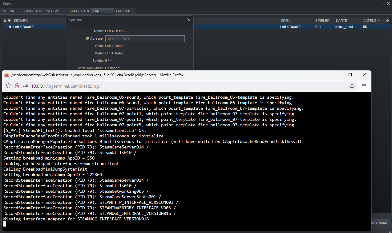

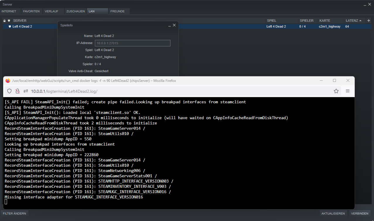

When trying to start L4D2 server, I keep getting Missing interface adapter for STEAMUGC_INTERFACE_VERSION016, and it stops there.
The old ports are still in there since the container port is 7777 and the host port is 7788.
You have to entirely delete the old port with the container port 7777 and you have to create new port mappings with both the host and container port set to 7788. For the other ports you have to do the same too.
You have no basically told that you want to use port 7788 inside the container and you forward port 7777 from the container to the host 7788 which can't work because the server uses as said above 7788 in the container. I hope I've explained that somewhat understandable... :D
This is not affecting the game server at all and the server is running at that point.
Can you see it in the Steam Server Browser? If not, can you see it in the Steam Server Browser?
You just repeated yourself. No, it is not showing up.
Sorry it's not that easy when you have to watch your little son and give support at the same time.
What I wanted to write was: If not, did you change anything in the template?
Yeah, I know the feeling, as I have 6 children. The only thing I have changed was +maxplayers 4 +map c1m1_hotel. Is there something else I need to change?
No, you don't need to change anything usually, I just installed the container and it just works on my machine with the same message:
Even your settings are fine:
Do I need to change something to get the server name to change? That way in case someone else has the same name?
I don‘t understand, go to the LAN tab in your Steam Server Browser, I can‘t imagine that someone else on your network has the same server name.
You can change the server name in the server config file in the l4d2 directory (please make sure you stop the container first before esiting the config file).
You‘ll find the Steam Server Browser in View -> Server Browser -> LAN
