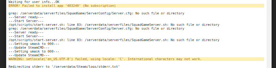

Hi again.
It makes this error when im trying to install the server: image.png.b0d7575ae870d506c5a5474f65165bc5.png
Do i have to own the game on the account that i uses to install steamservers?
41 minutes ago, Pede said:
Hi again.
Btw im trying to install the Squad docker
53 minutes ago, Pede said:
Hi again.
Please don't use a username or password if there is no required mark in the template.
For this docker leave the username and password empty. ;)
Stupid Steam. And me.

---Update Server---
WARNING: setlocale('en_US.UTF-8') failed, using locale: 'C'. International characters may not work.
Redirecting stderr to '/serverdata/Steam/logs/stderr.txt'
[ 0%] Checking for available updates...
[----] Verifying installation...
Steam Console Client (c) Valve Corporation
-- type 'quit' to exit --
Loading Steam API...OK.
Logging in user '****' to Steam Public ...
Logged in OK
Waiting for user info...OK
ERROR! Failed to install app '376030' (No subscription)
---Prepare Server---
---Server ready---
---Start Server---
/opt/scripts/start-server.sh: line 61: cd: /serverdata/serverfiles/ShooterGame/Binaries/Linux: No such file or directory
/opt/scripts/start-server.sh: line 62: ./ShooterGameServer: No such file or directory
It definitely looks like the container can't get out to the network, and/or Ark isn't getting installed for some reason?
Thanks!
--P
Remove the account. I just installed the docker and logged in anonymously and it downloaded, and installed just fine. After that it looks like you would need to stop the container then add the account info and start it back up. Atleast, that's what I'm guessing:
Connecting anonymously to Steam Public...Logged in OK
Success! App '376030' already up to date.
