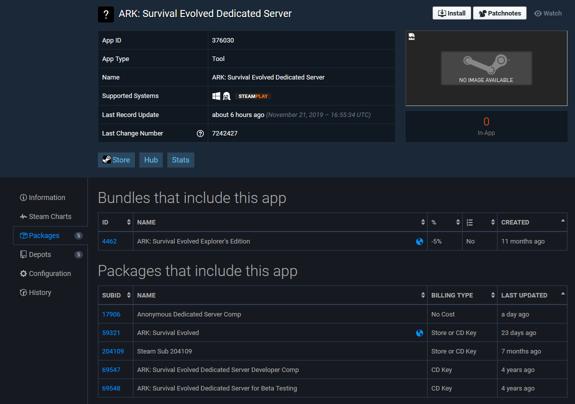

5 hours ago, pengrus said:
Yes, Ark requires a username, had to set up a separate account for that with SteamGuard disabled.
Now that i'm at home i could try it out and ark doesn't need a username or password, downloads just fine, the error that you get is just that this account doesn't had the game in the library (also one other reason why you don't have to specify a username) -> also attached a picture of the steamdatabase where it shows that this needs no login.
5 hours ago, Masterism said:
After that it looks like you would need to stop the container then add the account info and start it back up.
Really mine showes up just fine without a username and password in the server list the only thing that needs to be set is the filter: show custom servers.
All I did was download the docker and let it install. I don't have Ark installed atm to see if the server is up. Most of these game servers don't require a steam account. Also with a the couple servers that I have tried to use an account with, it just failed. So, don't use an account and it'll work! :D

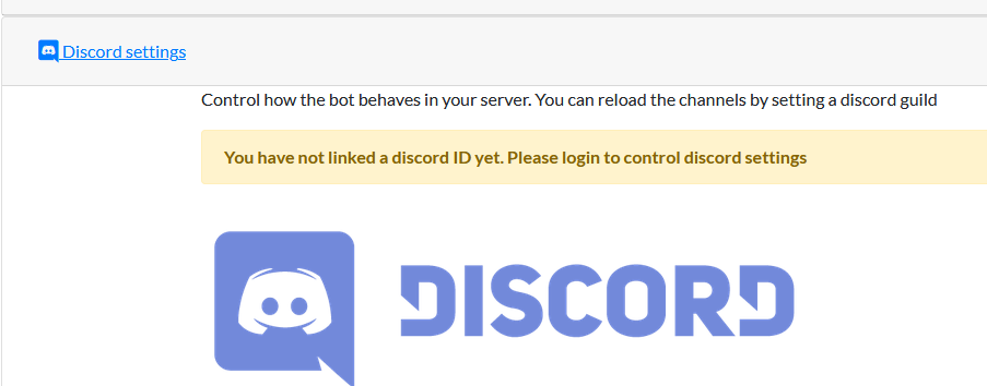

I don't know if this is because of the docker container or my reverse proxy, but when trying to link the Discord Id in the CSMM docker, I get an Oauth error. So I'm able to use Steam of course to authenticate to get this to work, but when I go here..
And I click on the link I get this
Any ideas?
Please refer to this guide, have you created all the required things (ID, secret, token)?
You have a reverse proxy for this container?
Don't do that please, it's not necessary because all the services run without root privileges and in an isolated Docker environment.
Btw yes it may be that it's not working properly because you reverse proxy the container.
You can also post a issue on Github *click* with your error (please also include that you use my container on Unraid.
Edited by ich777
Yes, everything's setup with the ID and secret. etc.. I have narrowed it down to the return URL
On this post though you said you need to setup a reverse proxy

OK I'll try not doing it as a reverse proxy.  Thanks!
