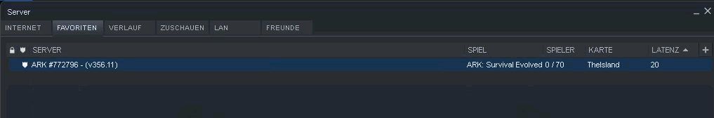

I cannot get my Ark server through UNRAID Docker to show up in any server browser.
How did you get yours to show up so people can connect?

I tried all this and it still would not show up in any game browser.
How long roughly should I be waiting? Because I've let the container run for 8 hours before and came home after work to see if it was in steam or ark server browsers, and it was not.

Did you port forward every port? I don't know what other docker you have but you cannot have 2 server on same port even on different internal ip. Even if you route from a different port, the game will want to say hey that's my port, connect to this port. If the ark browser cannot connect, it won't show.
There's also a good 10 to 20min delay between server up and seeing it on the browser.
I'm probably sure you have a port forwarding issue. Your last screenshot showed 2 ark server, which would cause problem if neither of them use different port. You can check on ark wiki for the port used and how to change them (its not just changing the port in the docker template, ark require extra game param)

Thats not my screenshot, I was asking how they allegedly have their server working.
I will recheck my port forwarding real quick, but I highly doubt its a port issue on my end.
Ark should just "work," but its not showing up in the browser(s).

I pulled a fresh copy from the CA apps now like you recommended and there is "slight" progress.
My server now shows up in Steam server list under LAN tab. However it still will not show up in the public list.
The ports are forwarded properly in my router and everything.
What game parameters do I need to enter to make the server show up publicly so people can connect?
Are you sure that you've set all options correct in the in game server list? This list is a mess from my perspective because if you have set one option wrong it will prevent the server from showing up.
Also keep in mind that it can take a bit until it shows up in the in game server list. Are you sure that hair pin NAT is working correctly? Have you yet tried to connect from a computer from outside your LAN? Are you also sure that you are not behind a CG-NAT? Please double check the port forwarding and only forward the ports with the appropriate protocol as listed in the template, if a port is listed as only UDP then forward only UDP and not TCP/UDP same goes for TCP ports.
There is none, the game will show up by default in the public server list by default if everything is forwarded correctly and it is actually reachable from the Internet.
