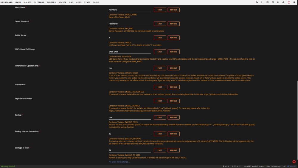

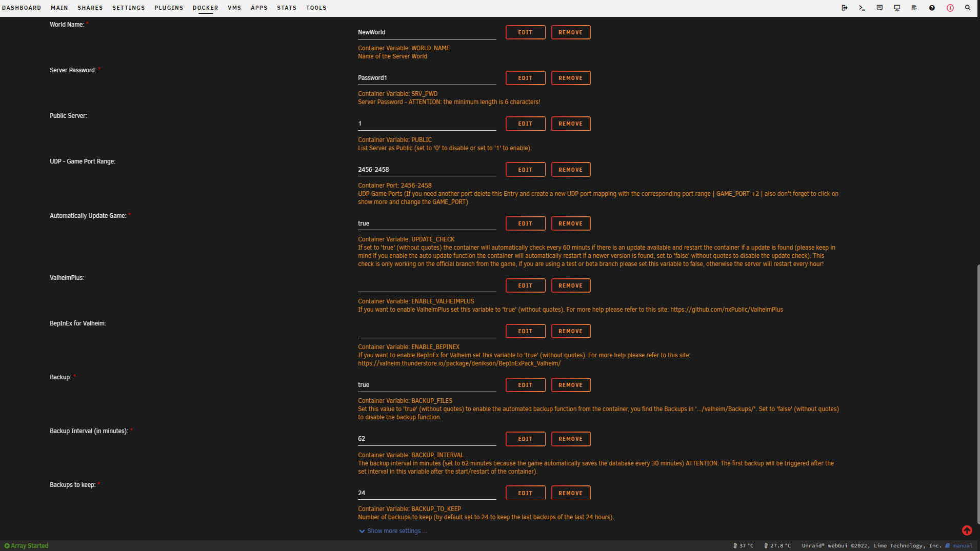

Hello @ich777,
I hope you are keeping well.
I am just trying to create a Valheim server and for some reason my server appears to be looping. I haven't changed any settings other than the server name, password, and validate installation = true. My appdata sharing is set to cache=prefer.
It seems to keep saying "---Update check deprecated!---".
Any ideas? Thank you as always.
Zee
Attached Valheim logs:
valheim server log download.txt

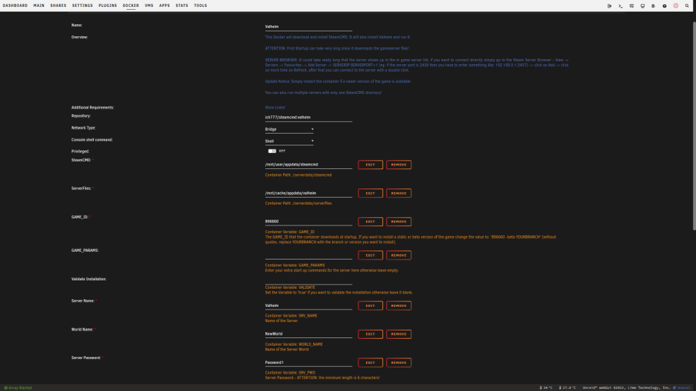

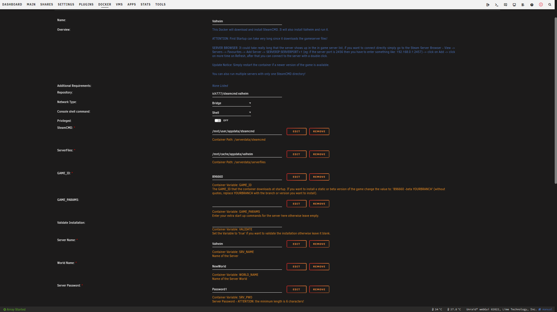

Please post a screenshot from your template.
On what Unraid version are you? How long is your password and of which characters does it consist (I only recommend using upper-/lowercase letters and numbers), please make sure it is at least 6 characters long. Please post your Diagnostics too.
Please turn this setting to false, this is only meant if you have issues updating the server.
Attached screenshots & anonymised diagnostic files as requested.
Latest version 6.11.5.
Removed validation=true, no change.
Thank you
diagnostics-20230309-1749.zip
Edited by Zee-Unraid
51 minutes ago, Zee-Unraid said:
Thank you
Sorry, I really can't reproduce this on my server:
Please try the following:
  1. Remove the container
  2. Remove the valheim folder which is located in your appdata folder
  3. Pull a fresh copy from the CA App from the container
  4. Leave everything as it is and click Apply
