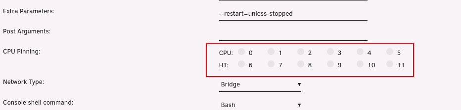

My next question is where can I allocate the amount of resources (RAM, CPU etc.) go into the server?
You can do all of that in the Docker template, just enable the Advanced View in the top right corner after that you can assign cores to the container and limit the RAM.
CPU Pinning should be pretty obvious:
You can limit the memory that a Docker container can use with this parameter:
--memory=4g
you have to put this parameter here:
The above example will limit the Docker container to use only 4GB of RAM, but I would strongly recommend to not limit RAM usage because you will most likely cause crashes from your game server.

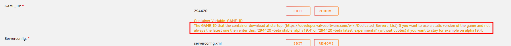

Hi All,
I am running the 7DaysToDie ich777 docker server and while I am excited for Alpha21 we might not want to be done with our current game by the time A21 comes out of beta and the server updates. I know how to create a "static" version of the game on the Client side, but I am not sure how to prevent the server side from updating on next reboot once the developers/steam set the update to live.
Any thoughts/help would be appreciated.
I would strongly recommend that you read the descriptions from the variables in the template:
You can also join @Spectral Force's Discord server, he helps me out with 7DtD support: Click
