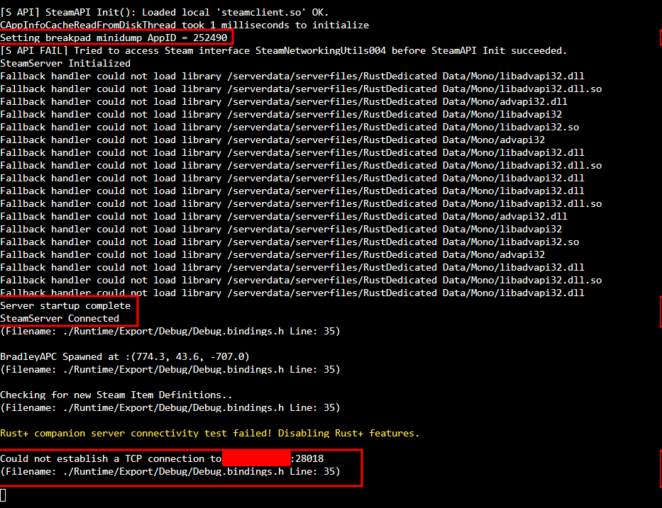

Hi there.
I've read multiple articles and it starts to feel like chasing my own tail. Never going to get it.
I'm trying to run a RUST server and installed your docker. First with my implementation and that didn't work. So started searching and came back empty handed. So removed the docker and removed the appdata part. Did a fresh install just like ich777 mentioned in this topic. But still can't connect to the server. Heck Steam says Hostname or IP adress invalid.
In my router i've fowarded:
UDP xxx.xxx.xxx.11:28015
UDP xxx.xxx.xxx.11:28016
TCP xxx.xxx.xxx.11:28017
TCP xxx.xxx.xxx.11:28018
I don't see any IP adress popping up in the log file. I could miss it but ich777 mentioned the last 2 lines or so.
Also have read you should wait until: "BradleyAPC Spawned". Well that I did find.
Some thing that does strike as odd: "Invalid Position: chicken.corpse"
So to summ it up: How to get it visible? I really want to host my own server, just to fool around in and to start learning the game.

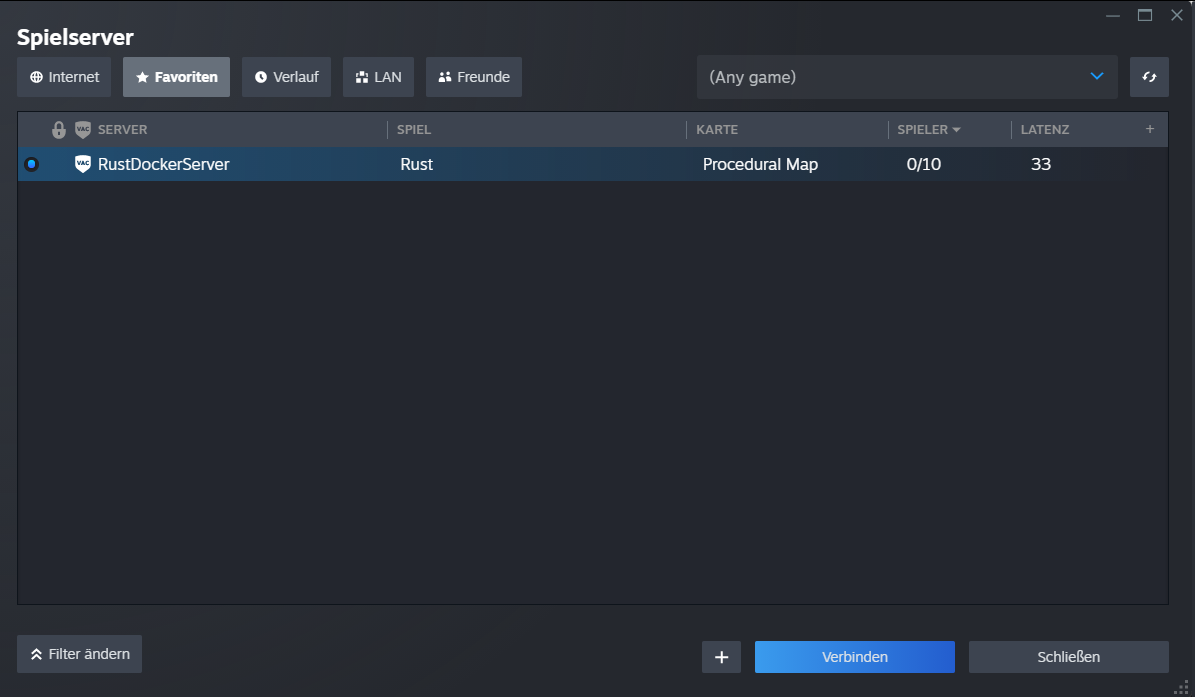

How long did you let the server run? It seems that it is still starting because of the high CPU usage, the first start from RUST can take very, very, very long (I think mine took about 10 minutes and remember this was after the download from the game finished).
After the container or better speaking the server started something like that should show up (keep in mind I didn't forward the ports to the outside world, that's why you see the last message):
As you can see the server shows up in the Steam Server browser just fine (even not forwarding the ports to the outside world) if you are adding it with YOURSERVERIP:28016
On 6/16/2023 at 9:43 PM, Black_SwanNL said:
Also the docker is using CPU power as seen in the screenshot above.
As for the CPU usage and has nothing to do with the container this it the dedicated RUST server, however that is pretty normal IIRC for RUST, on my i5-10600 it utilizes in idle almost 8% CPU.
This is because it is an old i5 6600K. Was my old game pc before. Saving up for a new mobo and cpu. On the wishlist is a i5 13500.
And the above is why I couldn't connect. I was trying YOURSERVERIP:28015 and not YOURSERVERIP:28016.
I feel like an idiot right now.... I thought gameport was the port to connect to. But changing it to the querry port:
And that is why sometime you need a community. You can't do and or know it all by yourself.
Thank you ich777
