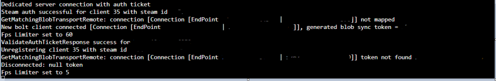

I'm on unraid, here's the container:
I agree it's convoluted, but I don't have any other log output before the container reboots.

I can not reproduce this on my server, I've attached the log and it starts up just fine: dontstarvetogether.log
On what Unraid version are you? The dedicated server starts up just fine on my system, of course I have no token installed but it is starting fine.

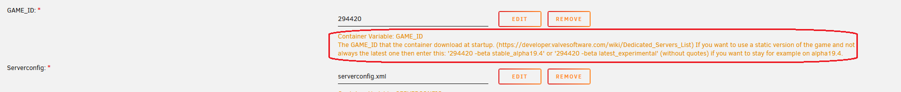

Can't seem to get 7DtD experimental to start after today's update. It was working before, but now it's once again getting stuck on "memorysetup-temp-allocator-size-gfx=262144". I've still got "headless=" in the boot.cfg and have "-batchmode -nographics" in the GAME_PARAMS.
I would recommend that you join @Spectral Force's Discord server for 7DtD help because he helps me out with it since I'm really not familiar with the game: https://discord.gg/VwwYA5h

Hi, Is there a way I can set my 7daystodie server to be a specific version? Maybe a game parameter or something?
Have you yet read the description from the variables in the template?

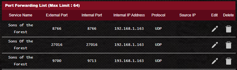

Has anyone had issues with getting port 9700 to work? I've setup port forwarding in my asus router. I've also tried using two different ports 9700 external to 9701 and also 9713 internal. Hopefully that makes sense. Neither has worked. The other two ports(8766,27016) are fine.
The server works if I use LAN+"SkipNetworkAccessibilityTest": true. And my friend can see the server and start to connect over the WAN but it gets stuck. I feel like I'm almost there.
I have a motorola cable modem connected to my asus GT-AX11000. Port forwarding setup on the asus router.
Nope, tested and verified that it is working just fine.
Just make sure that you just don't only forward the port to another port so to speak 9700 <-> 9701, you also have to change it in the config and delete the old port entry in the template and set the port to the same in terms of host and container port if you want to use another port.
Forwarding ports to different port numbers doesn't work for most game servers.
For a more in depth explanation look at the recommended posts on top for Valheim to run multiple servers, the only difference to Valheim is that you have to change the port in the config file <- please make sure to first stop the container before changing any config values!

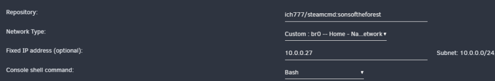

********UPDATE  - RESOLVED
I deleted everything and started over. This time time I used the br0 interface to give the container an IP on my 192 vs the internal 172 address. No idea why it worked but maybe something to try if anyone else has issues.
Thanks for the reply!
According to the ISP documentation 9700,9701,9713 are not on the list of ports blocked.
I think I've changed the ports in all of the correct places.
This is the router:
Unraid/Docker
From the logs during boot
I grabbed this image when my friend and I were trying to connect over the WAN
Edited by thomps84

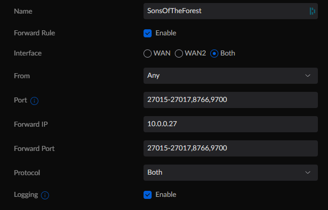

I have tried to create a container for Sons Of The Forest, but found it was trying to use IPv6, I got around this by specifying the binding address to the local IPv4 address. I can now see the server in-game when on the same network, but no one else connecting externally can see it.
I have tried specifying my external IPv4 address in the binding address but this breaks the server entirely (as expected), all required ports are forwarded, and the container has been given its own IP on the network. The built-in port checker in-game is successful.
Any idea on what I could be getting wrong? I've setup many game servers in the past and never had this issue.
Even when I connect to a VPN from my PC the server disappears, then re-appears when I disconnect it.
I have CG-NAT disabled so I get a real external IP from my router.
There are no conflicting port forwards in the router settings.
Network Settings
Port Forwarding
Server Config
Edited by Spoods
What do you mean with that, you can't disable CG-NAT, that's something your ISP has to change and give you a real IP.
It should only listen to IPv4 since the default format from "IpAddress" is "0.0.0.0" which tells the game only to listen on IPv4.
Maybe ask your ISP if they block some UDP ports, another user reported a similar issue but I can't reproduce this on my end everything is just working fine with the default ports.
What does the log tell you, it will tell you if a port isn't properly forwarded or better speaking not reachable from the outside world.
I opted for a static IP, so now I have a non-natted external IP address.
Was not sure if 0.0.0.0 is used as a 'use any interface' option before and the logs indicated it was using IPv6 address at the time.
I would but I've already fixed the issue anyway (updated my first post with my fix) I currently have 5 people on the server so no need anymore.
The self-test in the server told me the ports were open so I really have no idea why it didn't work originally with the default ports, I'd have expected that test to fail if the ISP were blocking them but it didn't. ¯\_(ツ)_/¯
I just know that using alternative ports fixed it for me.
