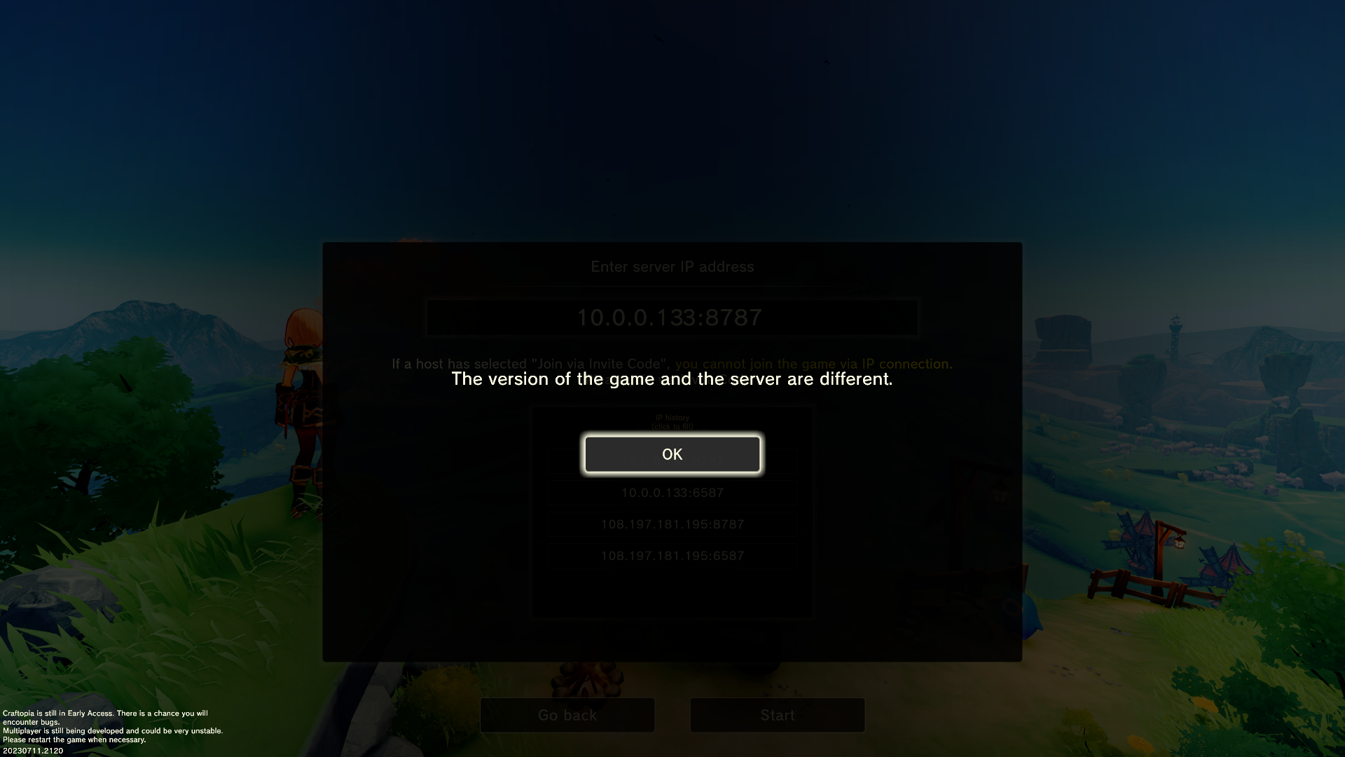

error when trying to update craftopia server
Loading Steam API...dlmopen steamservice.so failed: steamservice.so: cannot open shared object file: No such file or directory
^ pulled this from the logfiles, after getting error mismatch after a steamclient update.  rebooting the container in unraid doesn't udpate the server.  If you also navigate to the steamcmd and attempted to update that way. same issue;
Can you be a bit more prescise what your exact issue is?
This message is not an issue at all, this is just a warning and nothing more.
The container works as intended at least over here.

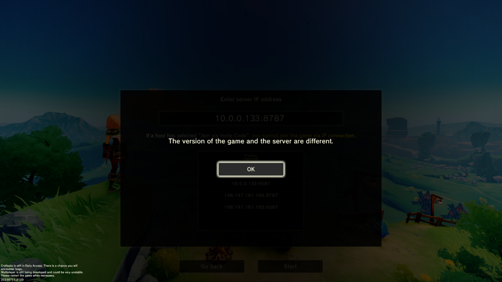

when i launch the game client from steam, and attempt to join, i get the following error;
"The version of the game and server are different"
yes it was working fine, yesteraday steam client updated, and since then i am not able to join.  i've already attempted to restart / uninstall / reinstall the game client ,and server container several times.   i must be missing something.

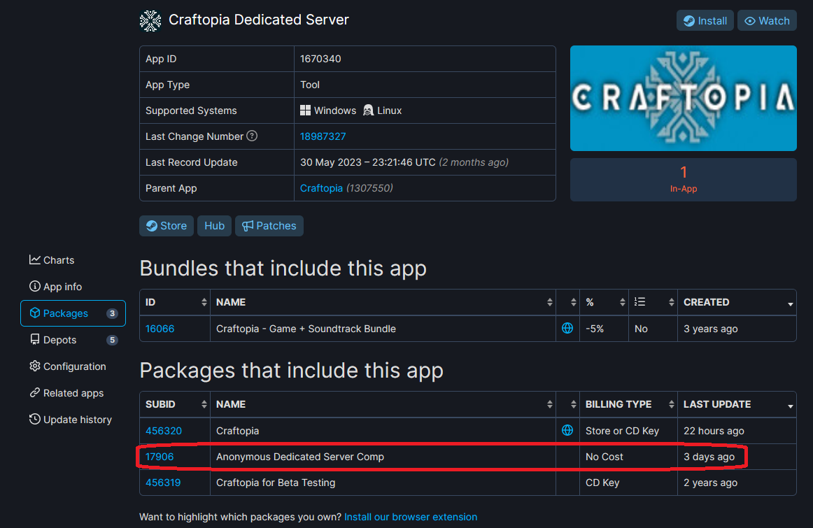

Please set the variable Validation to "true" (without double quotes) let the container fully start (open the logs and see if it pulls the update), after that go into the Docker template again, remove true from Validation and try again to connect.
It can be also the case that the Craftopia team hasn't upgraded the server app yet and you simply have to wait or ask in their Discord/Support Forums.
@cshellen and this is exactly what is the case here, the Craftopia Dedicated Server app was not updated:
There is nothing I can do about that, you have to wait until the developers from Craftopia update it.
