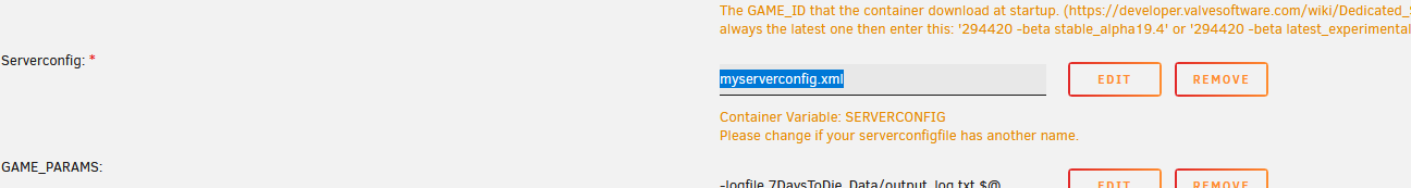

I feel like I must be missing something really basic here, but I'm trying to get the 7DaysToDie server running. It starts, everything is great, but if I edit serverconfig.xml and the restart the docker container then the file gets overwritten back to the generic default.
Am I not supposed to be editing the serverconfig.xml directly? Do I need to mark it read-only after making changes?
I just know I'm missing something obvious.
Did you stop the container in the first place before editing the config file?
Or do you have enabled validate installation, if yes disable it, the validation will always overwrite the file named serverconfig.xml <- validation is only meant if you have issues and the container won't pull the update.
I would also recommend that you copy the default serverconfig.xml and rename it to something different and then specify the name in the template like that:
EDIT: Please also consider joining @Spectral Force's Discord since he helps me out with 7DtD support because I'm not that familiar with that game: https://discord.gg/VwwYA5h
Thanks @ich777!
I knew I was doing something basic wrong, and I definitely had validate installed flagged true. I cleared that, set my own config file, and now everything is working great.
