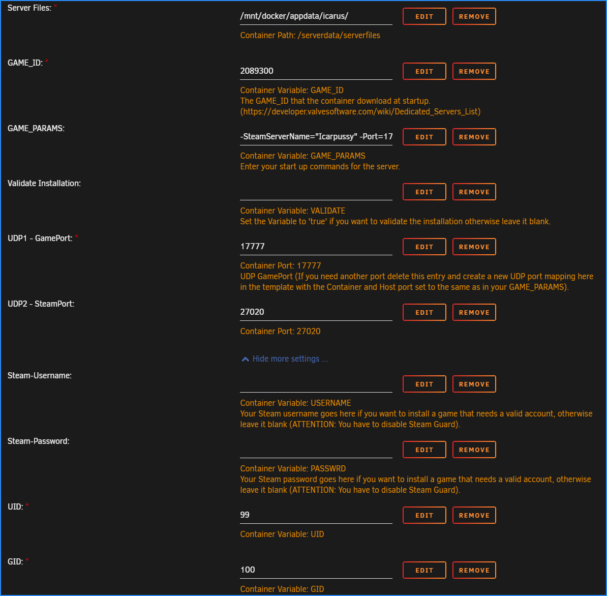

ich777,
First of all great work on all your containers!

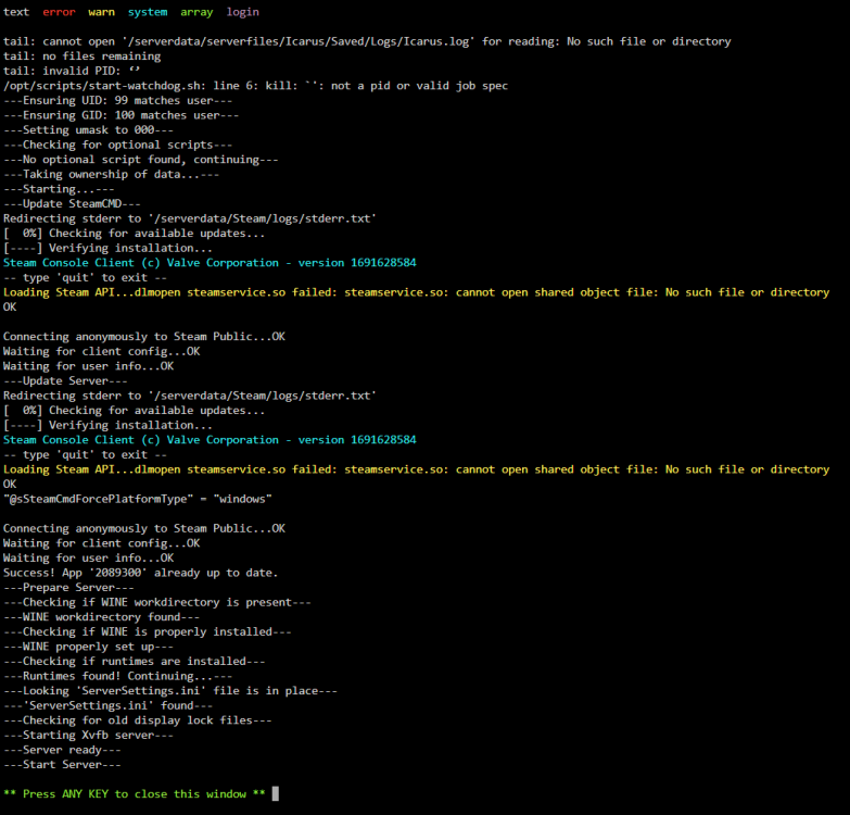

UNRAID server 6.12.3
Installed your Docker Icarus dedicated server. Installed and reinstalled multiple times and it keeps restarting and I think it's after the "---Start Server---" line but not positive. I forced verify the image and it re-downloaded it all fine seems like. Container keeps crashing and rebooting and the log window disappears. Only areas I modified are the SteamCMD port (27020 instead of 27015), changing Server name and passwords in the serverconfig.ini file, and pointed the SteamCMD to my Docker share instead of \User share. Tried switched from the br0 to just HOST to remove any networking variables.
I'm no expert in Dockers but as a comparison I setup a Sons of the Forest Docker container and it seemed to fire right up. This container i'm not sure why it keep rebooting and i'm not even positive what the error is that is causing it to reboot. Even tried removing the --restart unless-stopped flag.
Please give me any feedback as to why it's crashing or areas to look into.

Here is the container log:

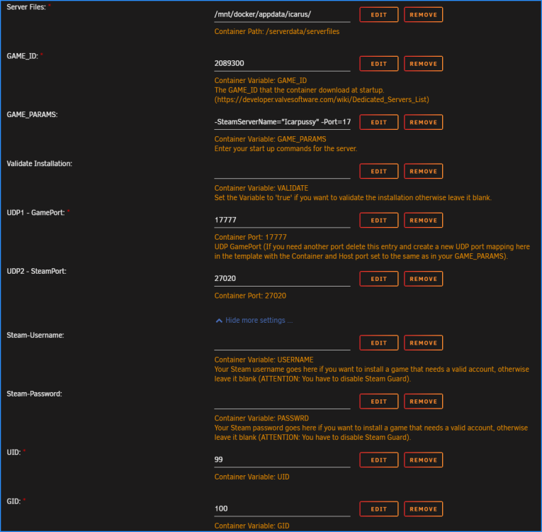

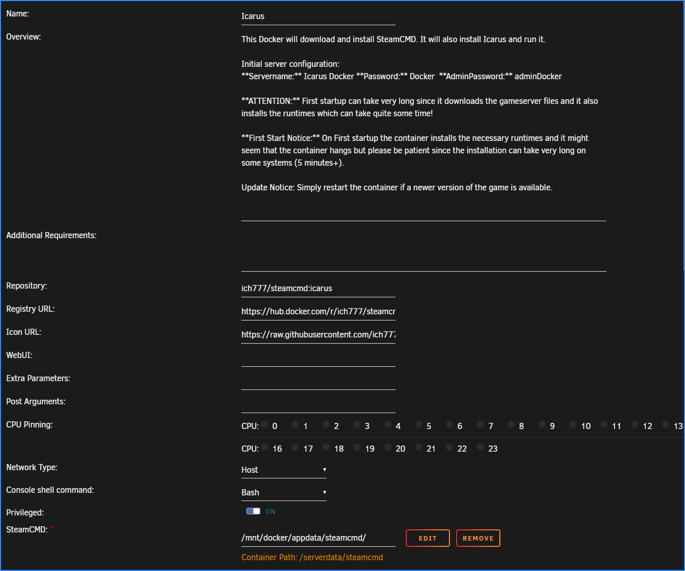

My Container Config Screenshots attached

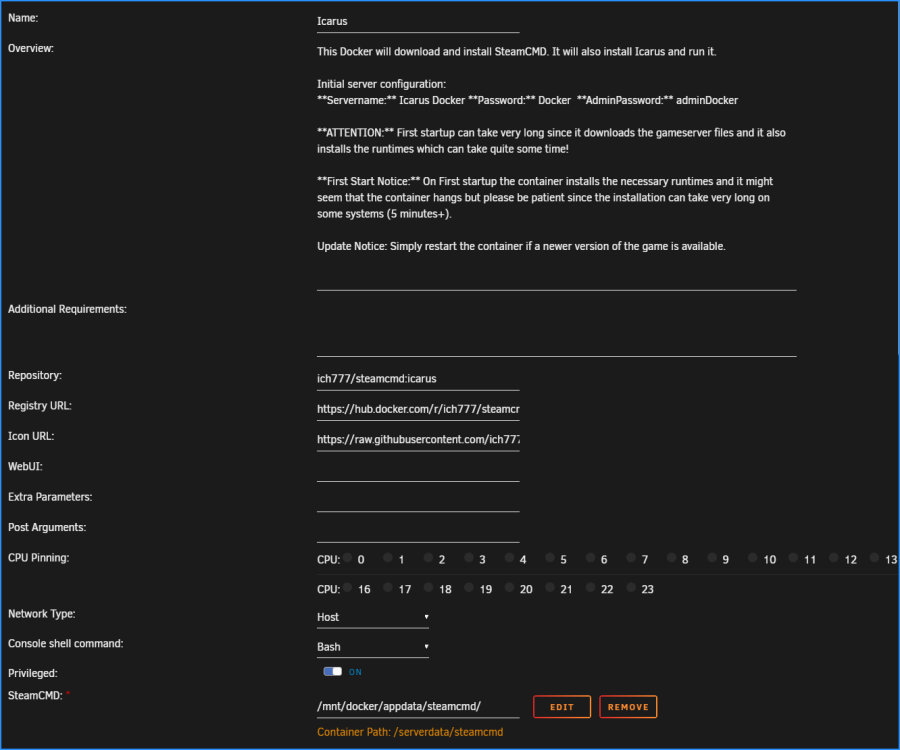

Container Setup/Deployment:
Edited by SlyFox
Sorry, but I can't reproduce this over here with a fresh installed container:
What CPU are you using?
I would strongly recommend that you upgrade to 6.12.4 btw...
Giving the Icarus directories Everyone permissions
Please disable Privileged in the template immediately, this is a serious security risk! I really don't understand why everyone is so ruthless with this switch... This is really bad if it's enabled!
Well I upgraded to 6.12.4, deleted the container and removed the folder. Fired it back up and after a long download process it does seem to do something similar and just crashes before the sever progress actually starts up. I wish there was more in the log for me to track it down but i'm not sure what is doing this?
It doesn't have anything to do with the Steam API warning line does it?
"Loading Steam API...dlmopen steamservice.so failed: steamservice.so: cannot open shared object file: No such file or directory"
Regarding the Privileged Permissions it's been removed; I was just pulling levers and agreed that Privileged permission would not be on typically but for debugging I was throwing everything at it.
For CPU, i'm running:
Intel® Xeon® CPU E5-2697 v2 @ 2.70GHz 24 Core (2 sockets but only 24C sent to this VM)
Running on a VRTX Blade Server (1 of 2) and then VMWare virtualized to UNRAID. Not running any VM's within UNRAID due to the virtualization. No GPU on this server chassis.
I could also show my VMWare VM settings for UNRAID if anything would help allow more compatibilty?
I have all RAM Reserved for the VM (50GB)
Do you think it has something to do with the compatibilty of the CPU? I've had other (sparatic) Dockers not work properly/install but ~80% work fine.
No, because this is a message from SteamCMD and in that stage Icarus is not started yet.
Go to: ...appdata/icarus/Icarus/Saved/Logs if this folder is empty the server won't even start and I assume it segfauls immediately when it tries to start which is a indication that your CPU is missing some kind of feature.
It is the same as I think with V-Rising IIRC (but I'm really not sure if it was V-Rising), this game is only supported on newer CPUs because it needs some feature that CPUs from pre Skylake are missing.
